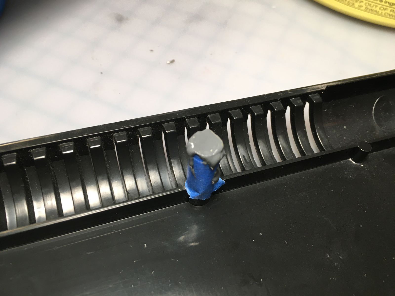

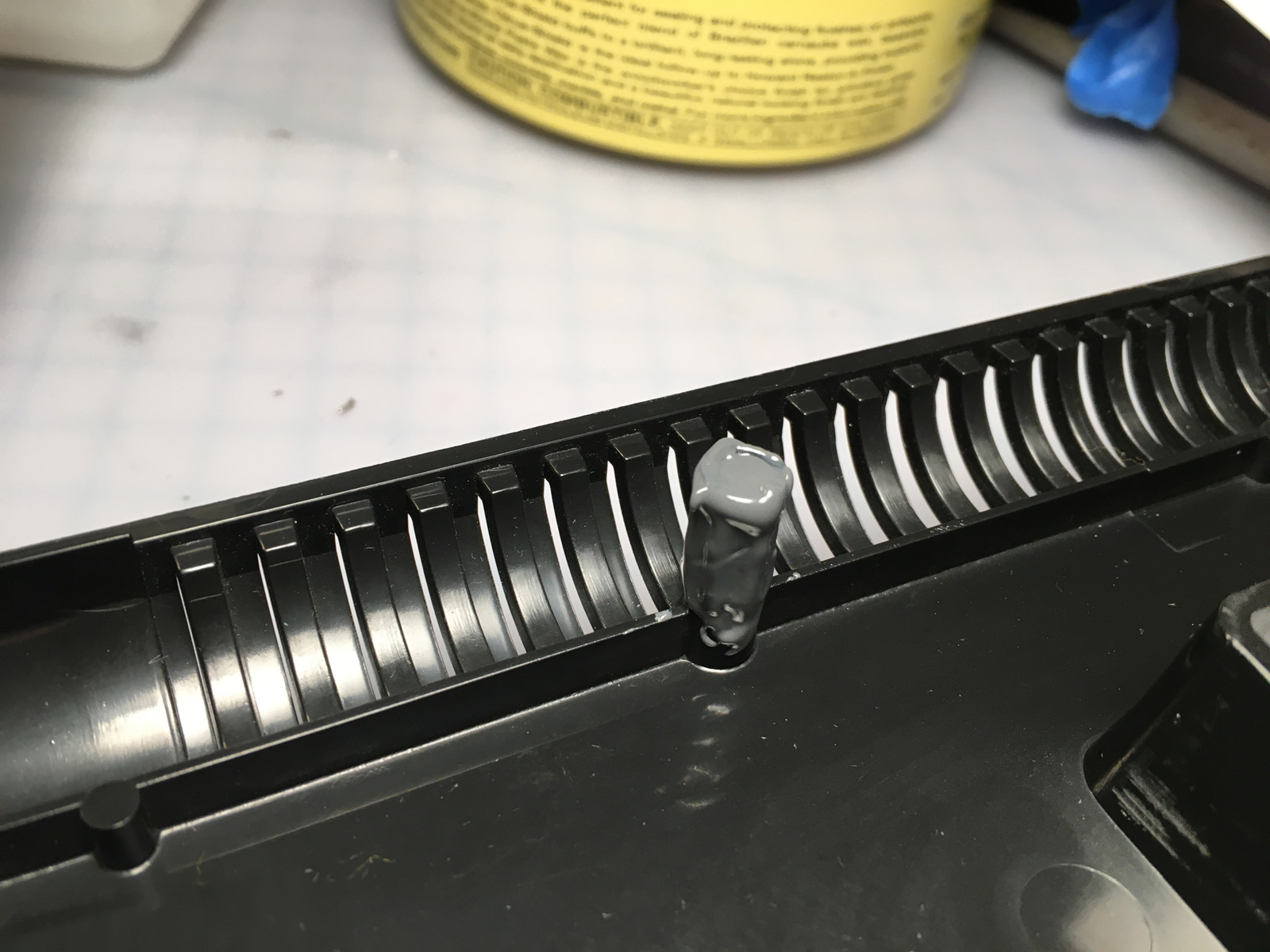

Besides the holes, two of the screw posts in the top of the case are in bad shape. One is completely broken:
The other has a massive spiral crack running around it:
So it's time to bust out my favorite plastic-repair kit: J-B Weld and paste wax. Johnson doesn't make their paste wax anymore (for some reason), so I had to find a lemony substitute (my old can got lost in a recent move):
For the half-missing post, I made a mold out of painter's tape:
Filled it with epoxy:
And screwed the wax-coated screw into it:

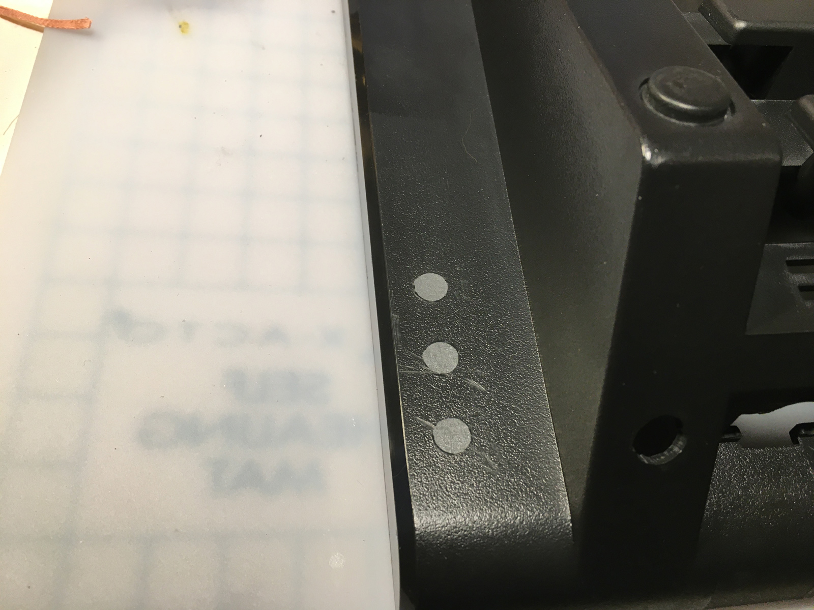

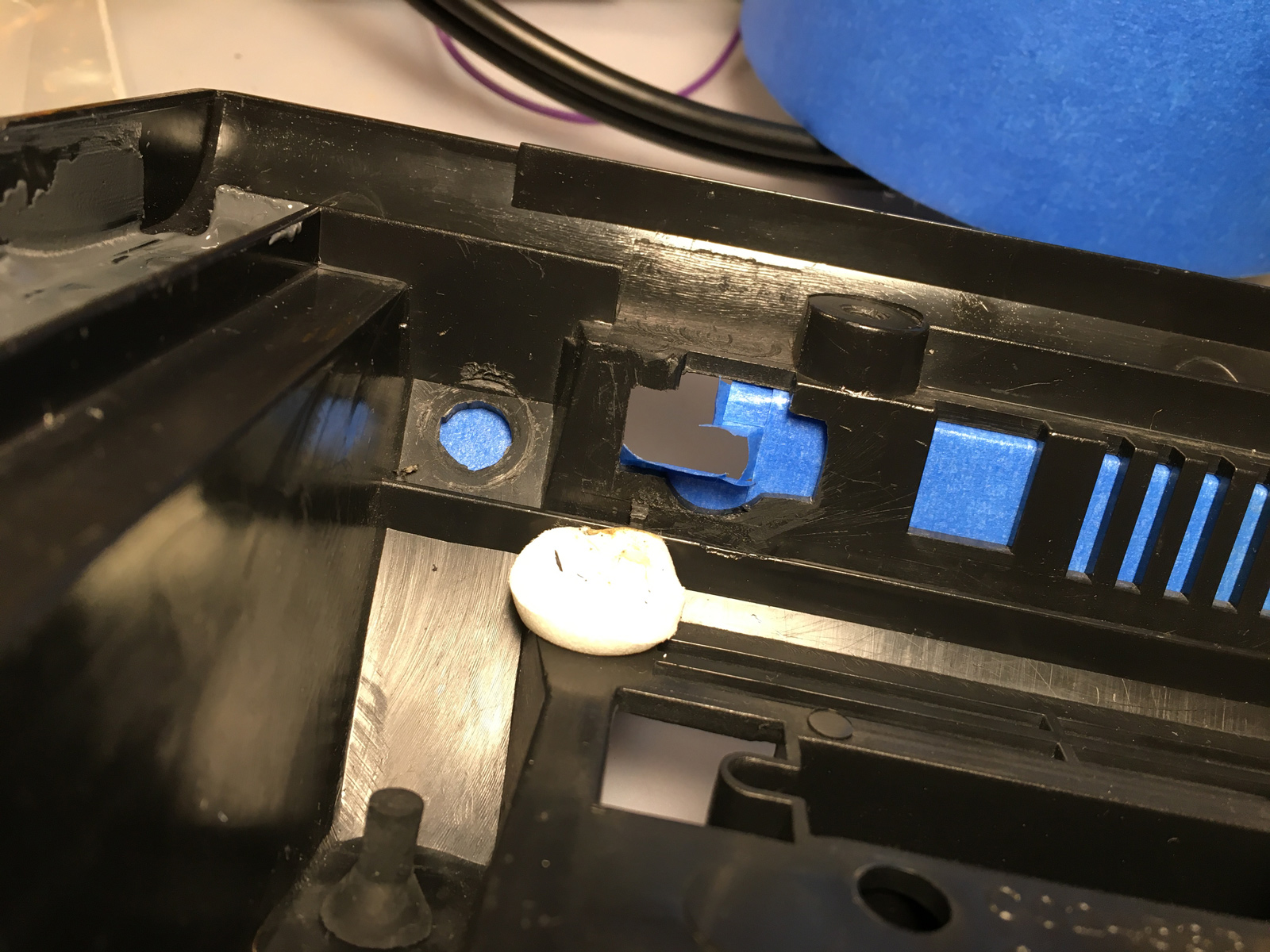

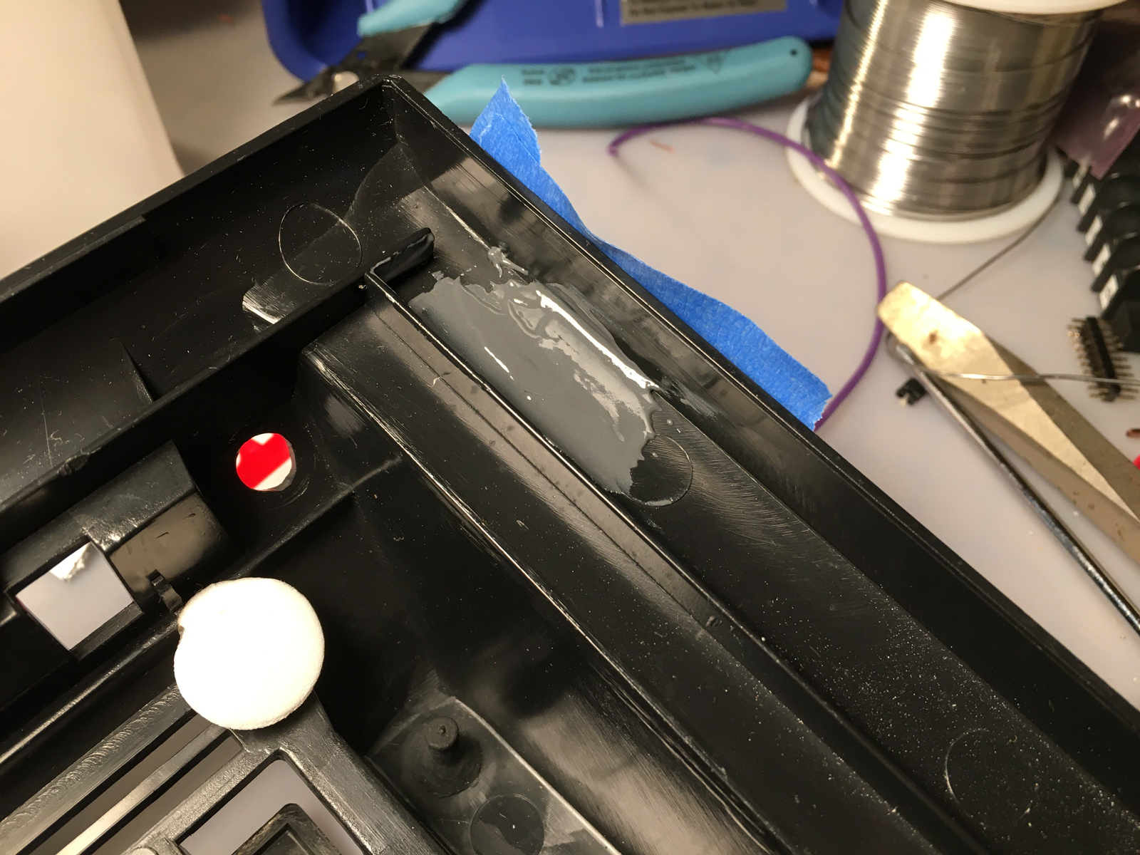

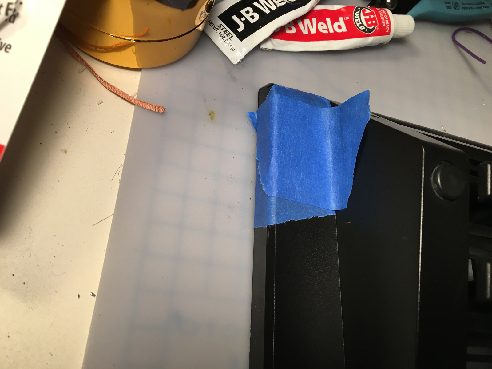

For the other holes, I cleaned up outside where they were drilled, and covered them with painter's tape:
And filled them up with epoxy from the inside:
After they dried, and the tape was removed, I had some nice, solid patches:
I did the ones on the back in a separate pass, since they're at a 90° angle to the first ones:

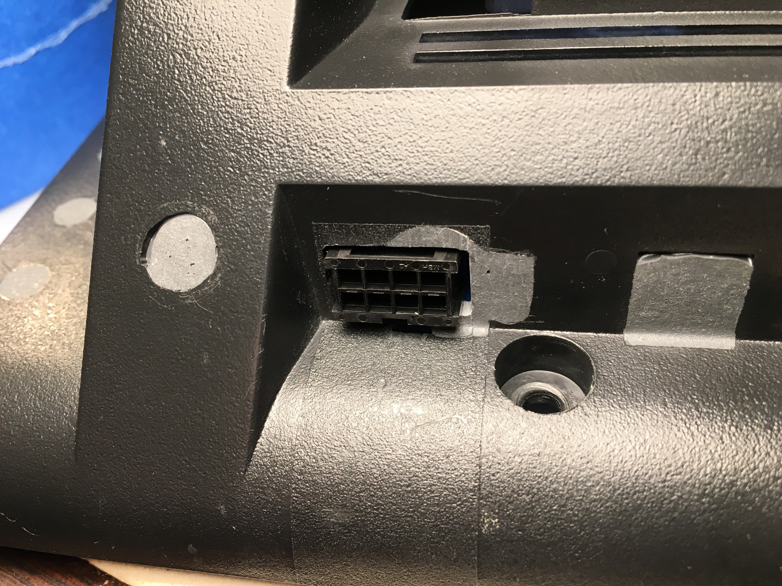

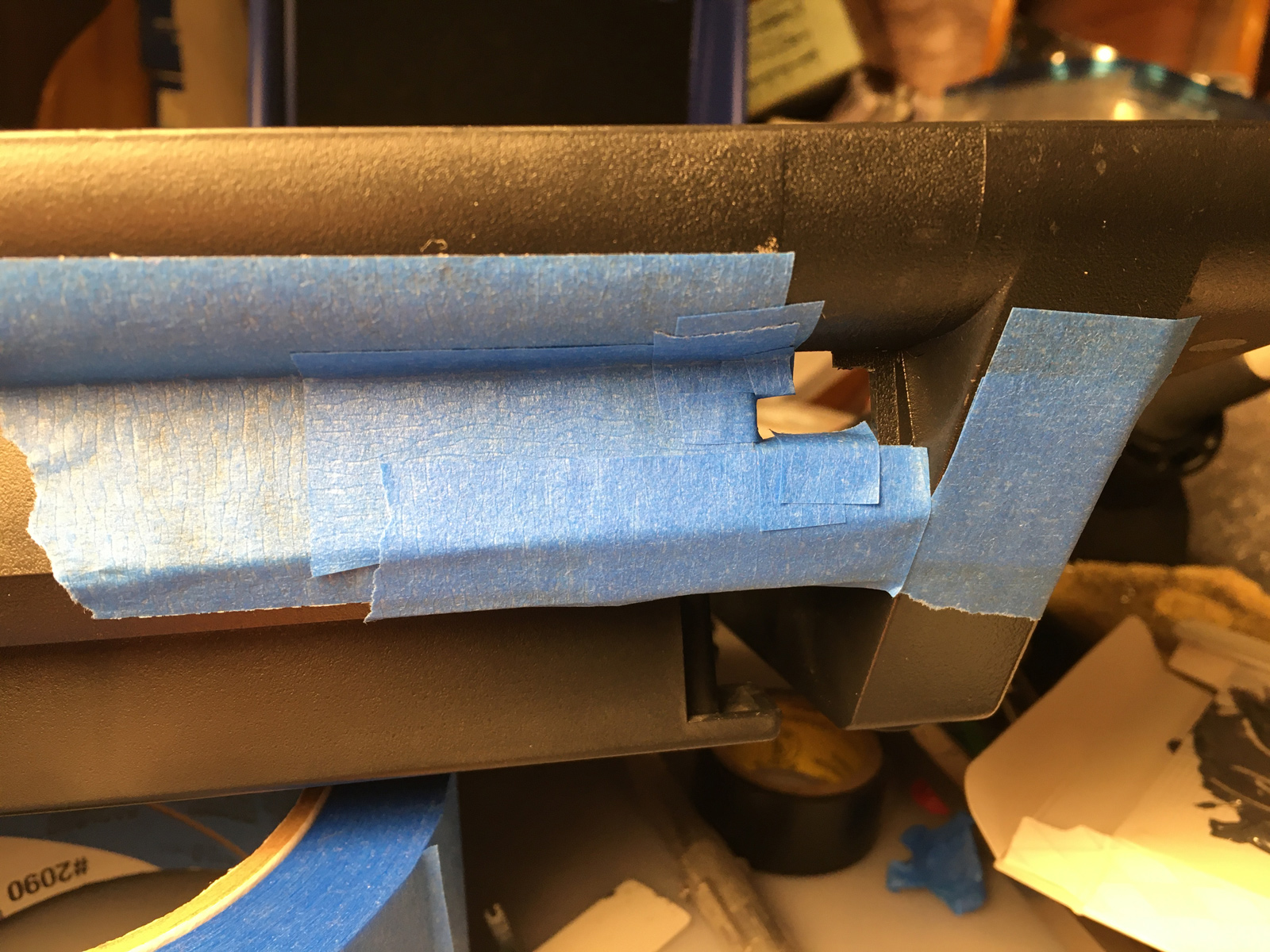

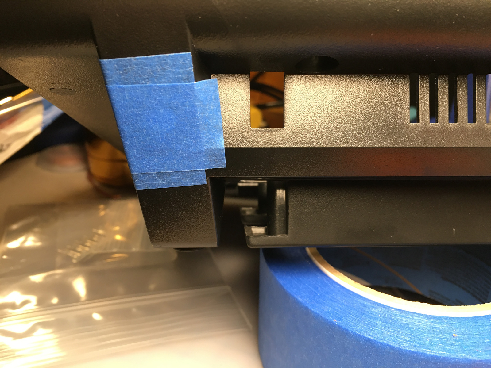

For the big former-HDMI hole, I needed to do something a little different. I approximately shaped the tape into a rectangle with a notch in the top:
This is so I could fit a Molex Micro-Fit 3.0 connector through it. I'll get more into that in the next installment.

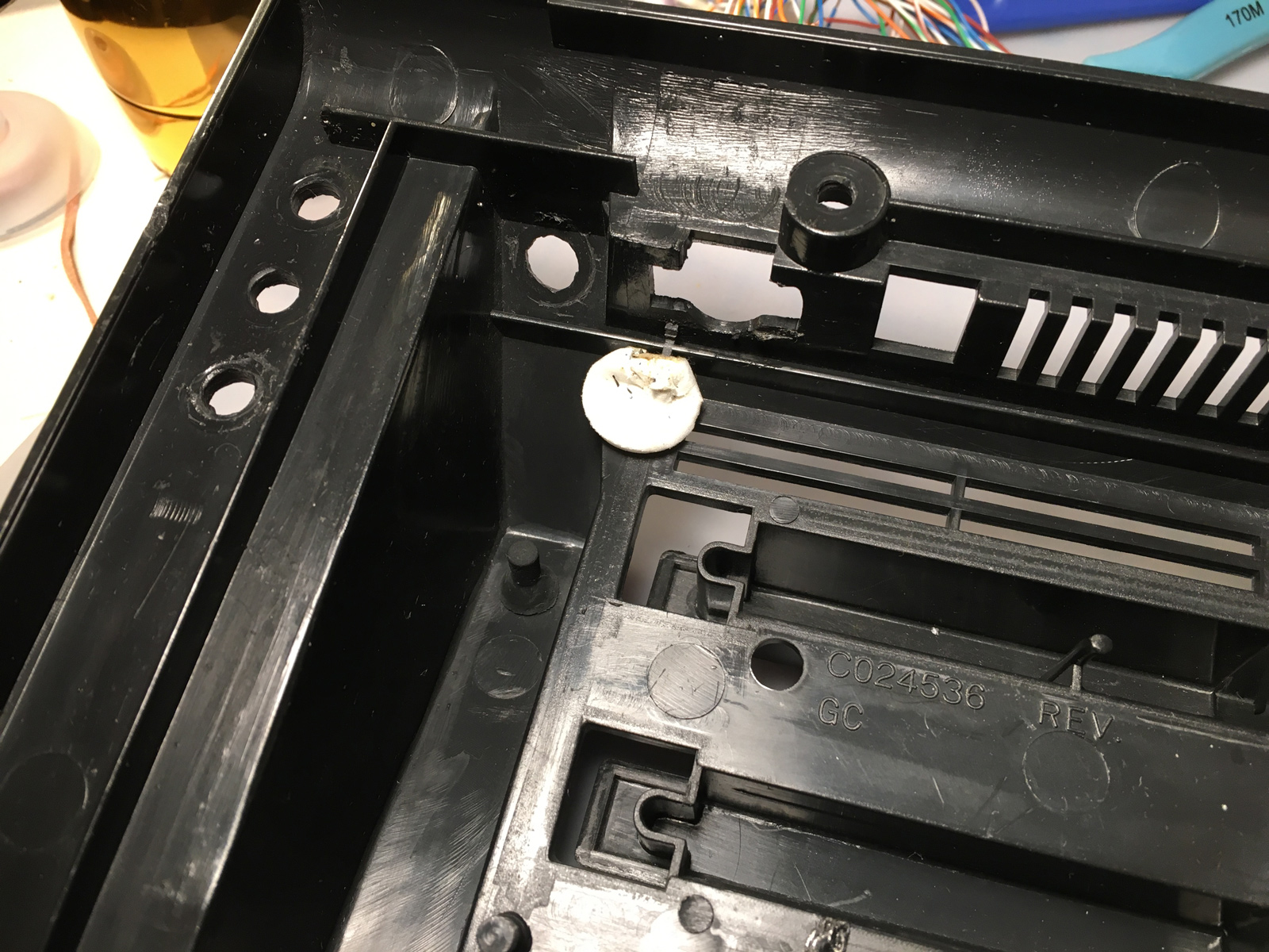

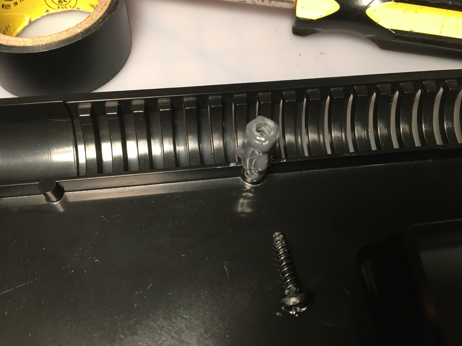

After letting the epoxy cure 24 hours, it was time to see if I could back the screws out. I used a very snug-fitting screwdriver tip, and applied a lot of downward pressure while slowly turning the screw. After a few very nervous moments, the screw finally broke free and backed out, leaving threads behind:
The broken post worked as well. I'd later go back and add more epoxy to the outside to further strengthen it:
The other holes needed a little clean-up, some shaping and filing, but were solid:
Well... except for a few voids. :ponder: Guess I need to trowel it in there a little more enthusiastically next time...
After a little carving and filing, I ended up with the hole that I needed for the Molex connector to fit through:
I'm not mounting the connector here - I just need it to be able to fit it through:
The posts got filed down and cleaned up a bit, and held the screws nicely:
I test-fit the case back together to make sure they held, which they did:

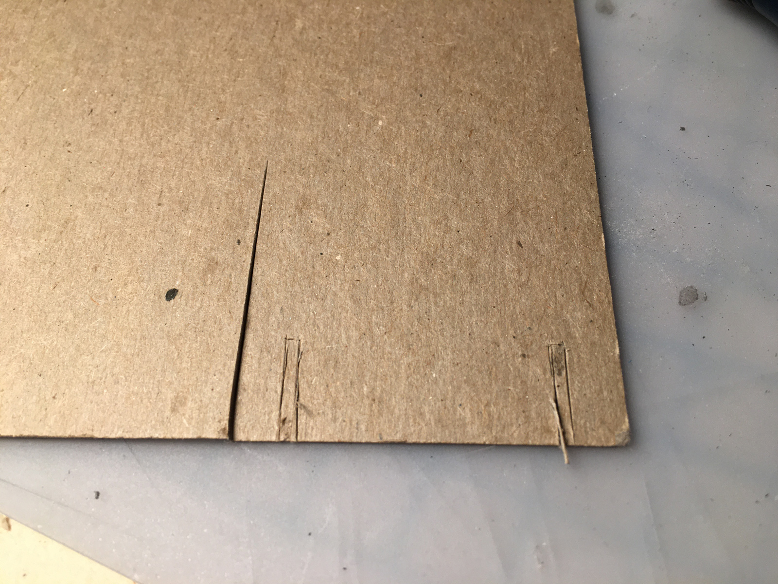

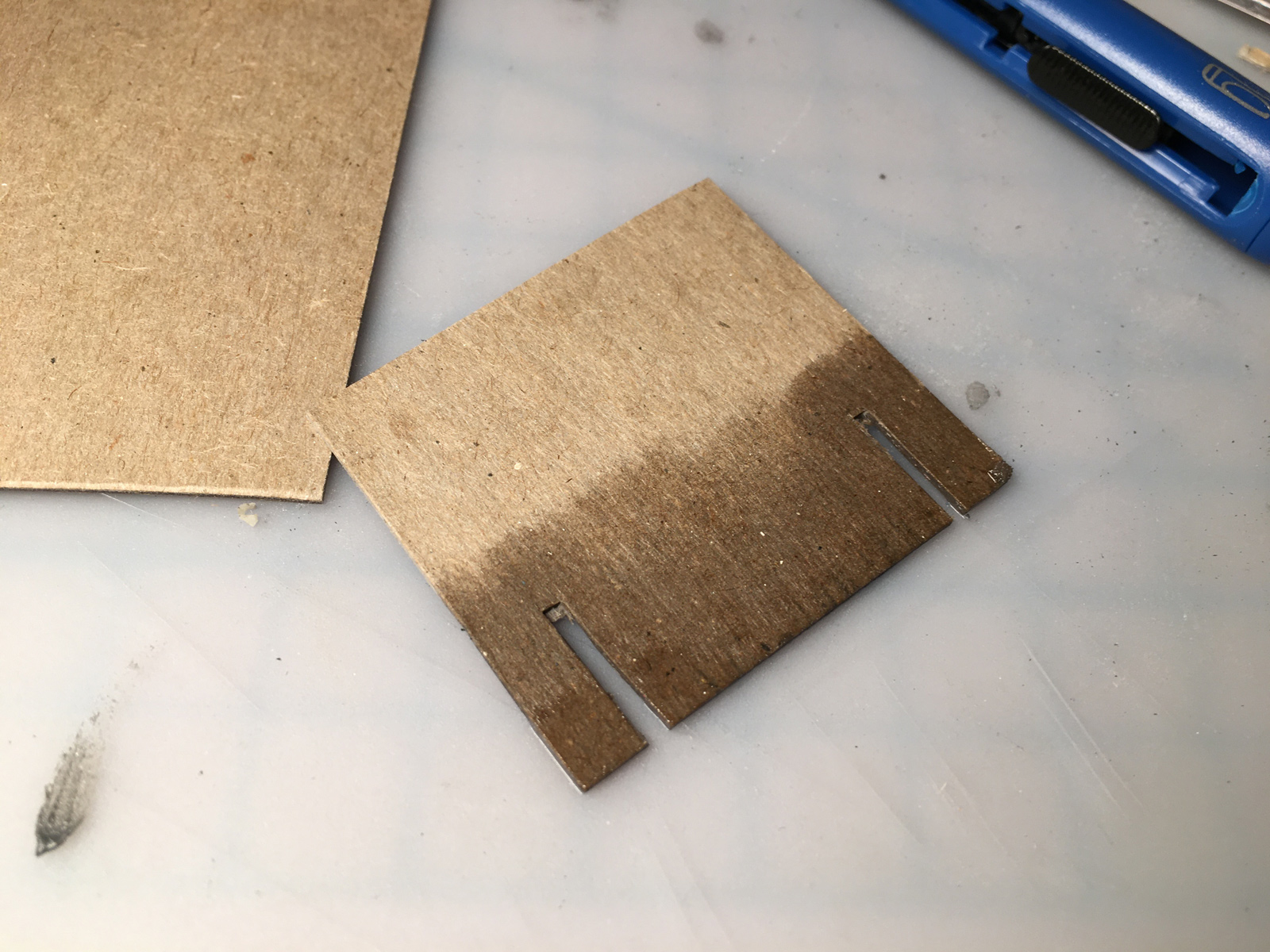

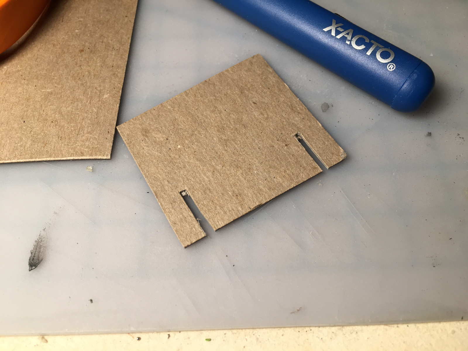

After getting the case patched-up and cleaned-up, I tackled cleaning the cartridge slot. I've described this before for the 2600, but here's a 7800-specific version.
First, I found some cardboard about the same thickness as a typical 7800 cartridge circuit board. Then I measured the cartridge slot, and started cutting the cardboard with an X-Acto knife to fit:
I trimmed it until it fit while still contacting all of the contacts in the slot:
Then I gave it a good soaking with some contact cleaner:
Then I just worked it up and down in the slot multiple times:
Yep... those were pretty dirty contacts:
On both sides:
I can re-use it over and over, just by trimming off the worn/dirty part.
