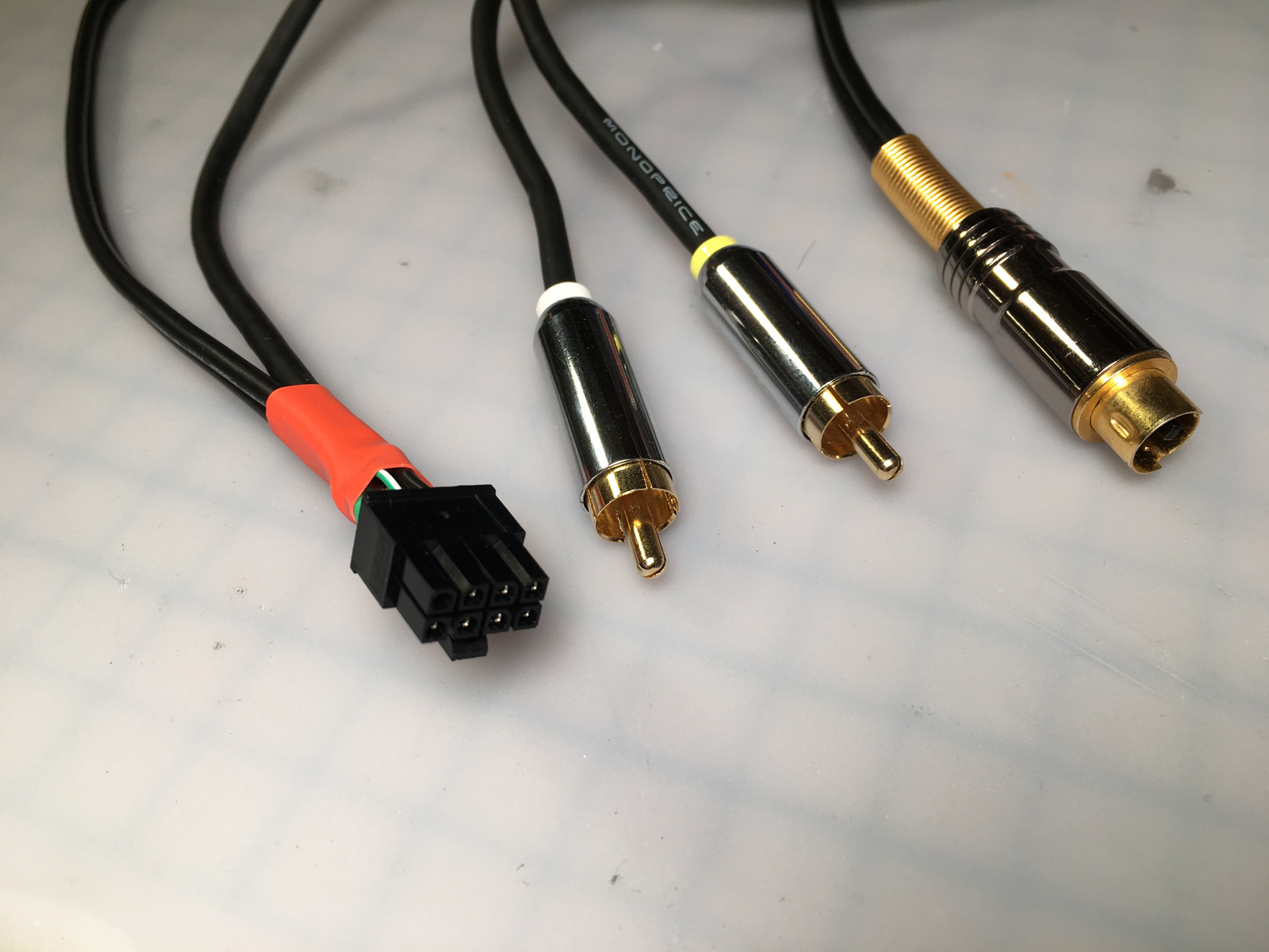

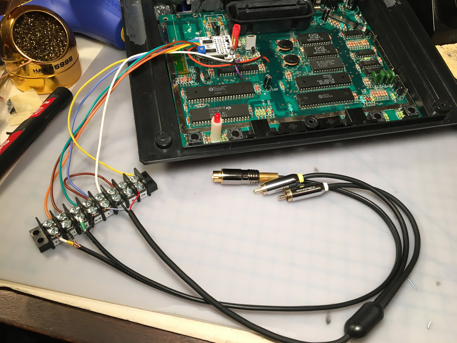

Time for some cablin'. Here are the donors, plus the Molex connector I'll be using to hook them up:
The video cable is a leftover S-Video cable from a patchbay I had at work (from Clark Wire and Cable), and the audio cable is a 3.5mm stereo to dual RCA cable from Monoprice. However - I'm not using it for stereo audio. I'm using it for mono audio + composite video.
The reason I'm using that particular audio cable, is because the UAV mod only outputs mono audio, so instead of having two cables hanging out of the back of the 7800 for a superfluous "stereo" output, I'll use one connector for audio, and I'll repurpose the other for composite video. John can add a "Y" cable if he should need to plug the 7800 into stereo inputs. He wanted composite video in addition to S-Video (since not all of his monitors have S-Video), and this provides a second RCA connector in a compact form factor.
The only downside? The right audio connector is color-coded red. Yellow is typically used for video. But we can fix that...
Presto! Composite video, mono audio, and S-Video! Job done! (As an aside, I tested an S-Video to composite adapter to see if it would be an acceptable substitute for a dedicated composite output - it wasn't. The picture was terrible.)
Just to make sure everything worked end-to-end, I used a terminal block to temporarily hook everything up and test it:

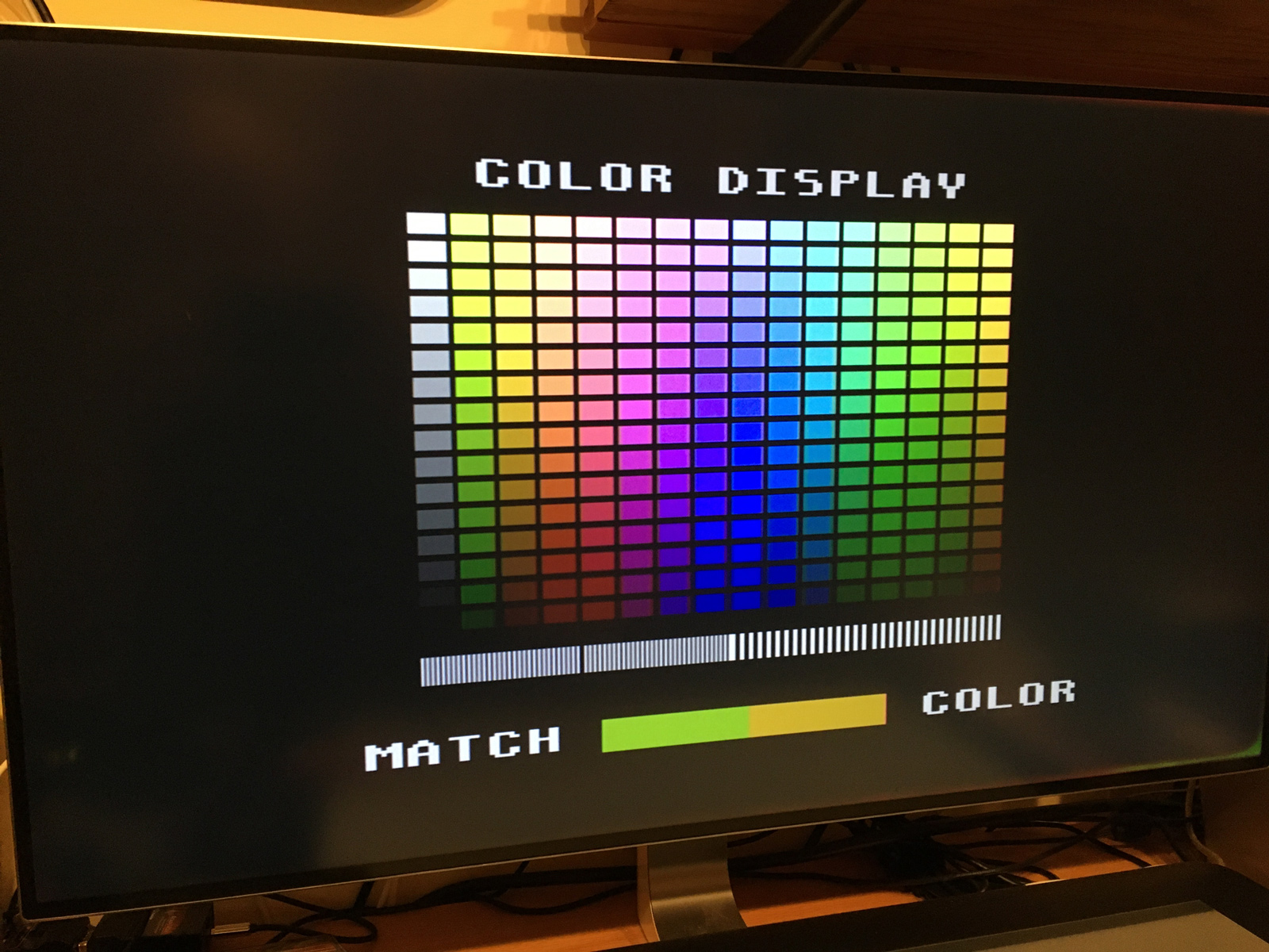

Composite works!
And S-Video works! (Audio also worked.)

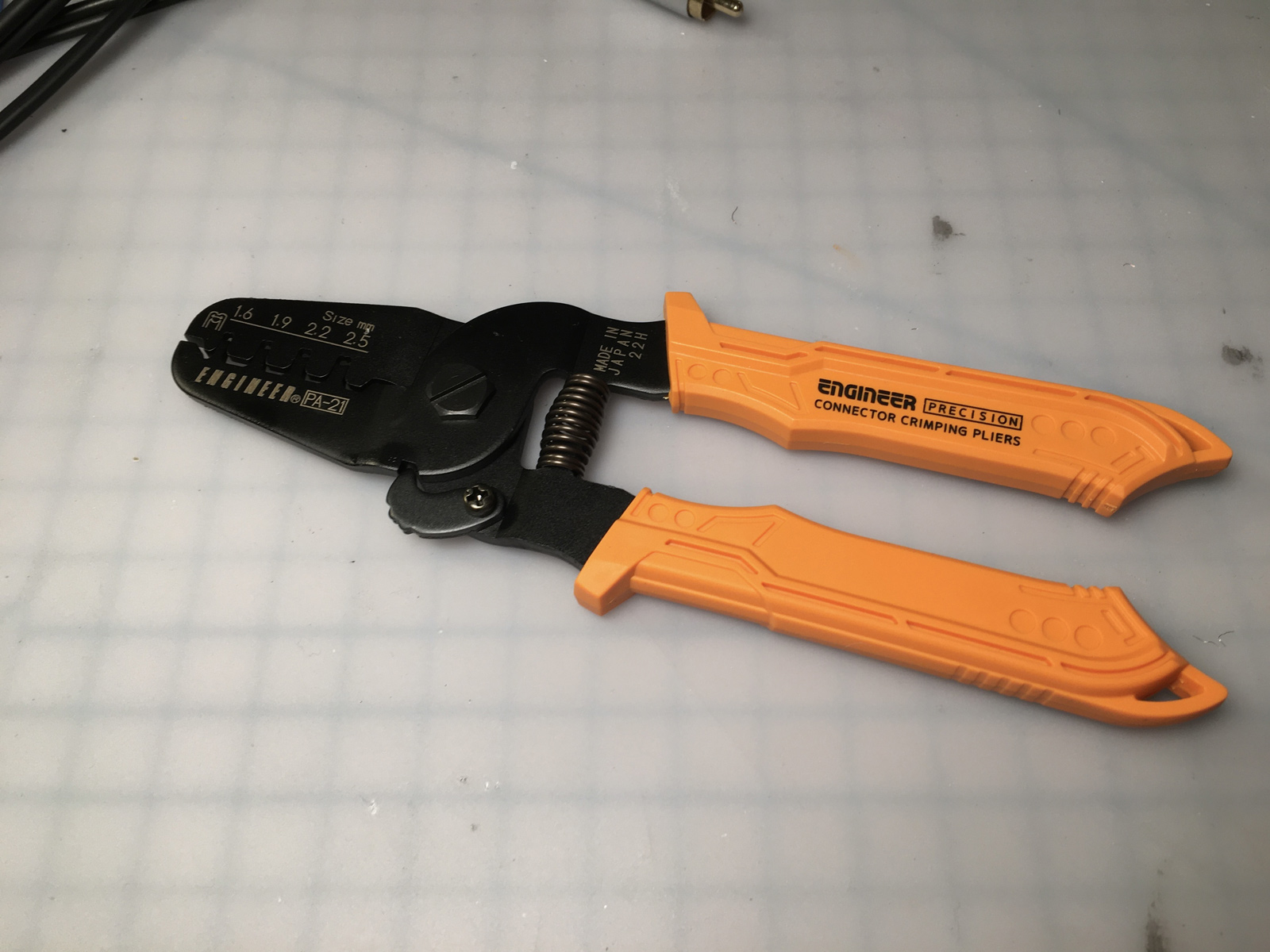

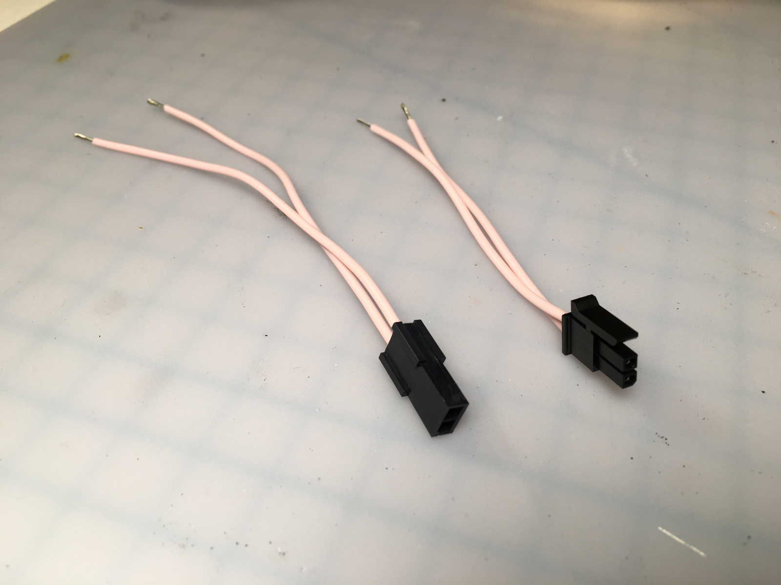

In previous mods, I've used Molex Micro-Fit 3.0 connectors to connect the mod wiring to the output cables, but have always had trouble crimping the pins. The connectors are tiny, and I had bought a crimping tool that did not cost $400. The tool I had could (in theory) crimp the conductor and insulation at the same time, and was a ratcheting-type crimper (which I've used at work for other connector types), but I could rarely get the pins in exactly the right position to crimp them, and it was a massive source of frustration. While starting on the 7800 wiring , I completely trashed multiple pins in the attempt and finally gave up and did some more research on finding an alternative crimping tool. And, I found one:
It's not a ratcheting crimper, and you have to crimp the conductor and insulation in separate passes, but it works.
I can align the pins in the tool every time, and it crimps them solidly with a very reassuring "click". Well-worth 1/10 the cost of Molex's tool.
All crimped up and ready-to-go!
The reason I use the Molex connector is so the main board can be unplugged from the output cables, in case the 7800 has to be taken apart (again) and repaired. The 7800 board has to be tilted up at the back in order to be removed, so the output cables need to be completely out-of-the-way for that to happen. Since they're going out the back of the case right above the main board, the only way to do that is to make that cable fully removable.

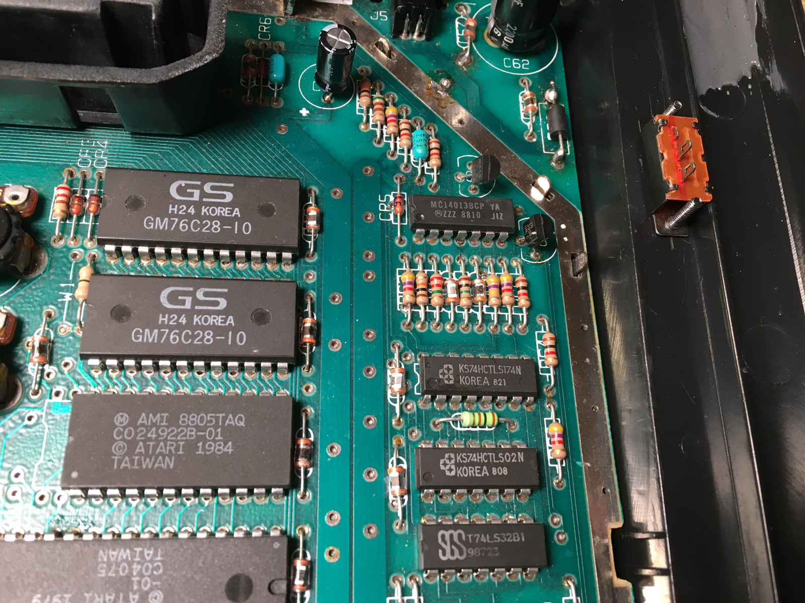

One more job to do. See capacitor C64? Of course not! Because its label is hiding underneath it. But disconnecting its right leg should improve compatibility with certain games (mostly Activision games and the SuperCharger).
14-c64.jpg'

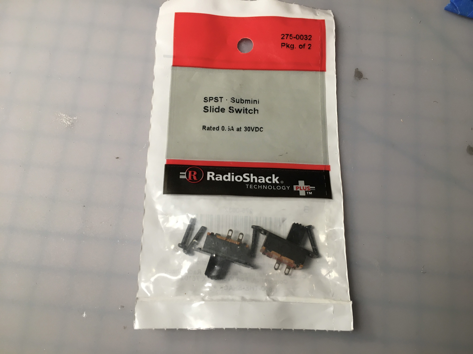

-^CrossBow^- made the suggestion of adding a switch to enable/disable it. I checked with John and he liked that idea, so I decided to add one. But I wanted a small, unobtrusive switch (unlike the toggle switch used for the previous HDMI "mod").
So what better brand to use than Radio Shack? You can still buy their stuff from Amazon! It seems completely period-correct to add a Radio Shack switch to an Atari 7800 too. :D
Man... that brings back memories. Now if I could only find my Battery Club card!
Score! I even still have eleven free batteries remaining! Time to cash this puppy in!

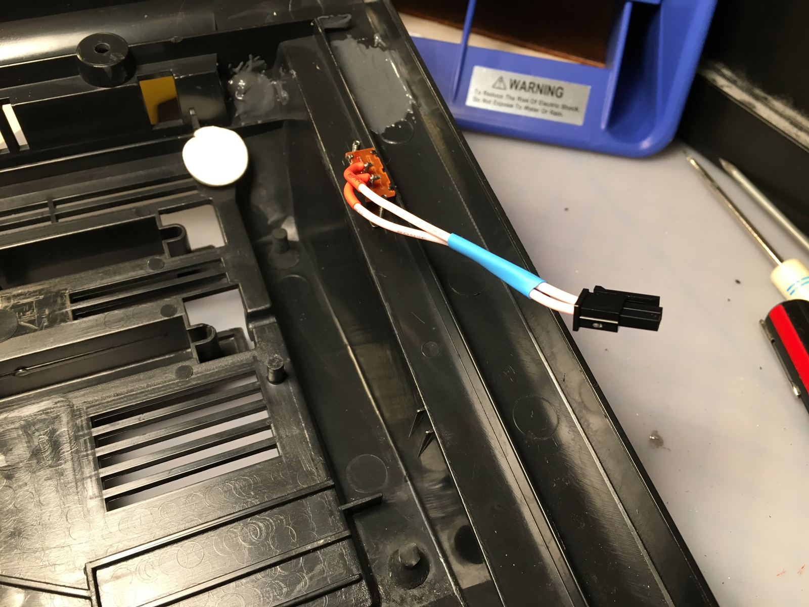

So first, some very careful measuring, followed by some very careful drilling, cutting and filing:
Perfect fit!
Found C64 yet? Hint: it's mounted horizontally.
I desoldered the right leg, and re-soldered the left one to more firmly anchor it to the board:
More Molex!
I tidied up and reinforced the connections with some heat-shrink tubing. Also, it will protect the wires when going through the RF shield:
Here, I bent the orange heat-shrink tubing while it was still hot, so it cooled and stayed at the angle I wanted it at. The blue tubing just keeps things untangled and tidy.
All hooked up! Again - the Molex connector keeps the main board easily removable.

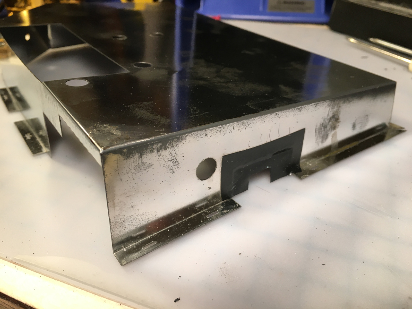

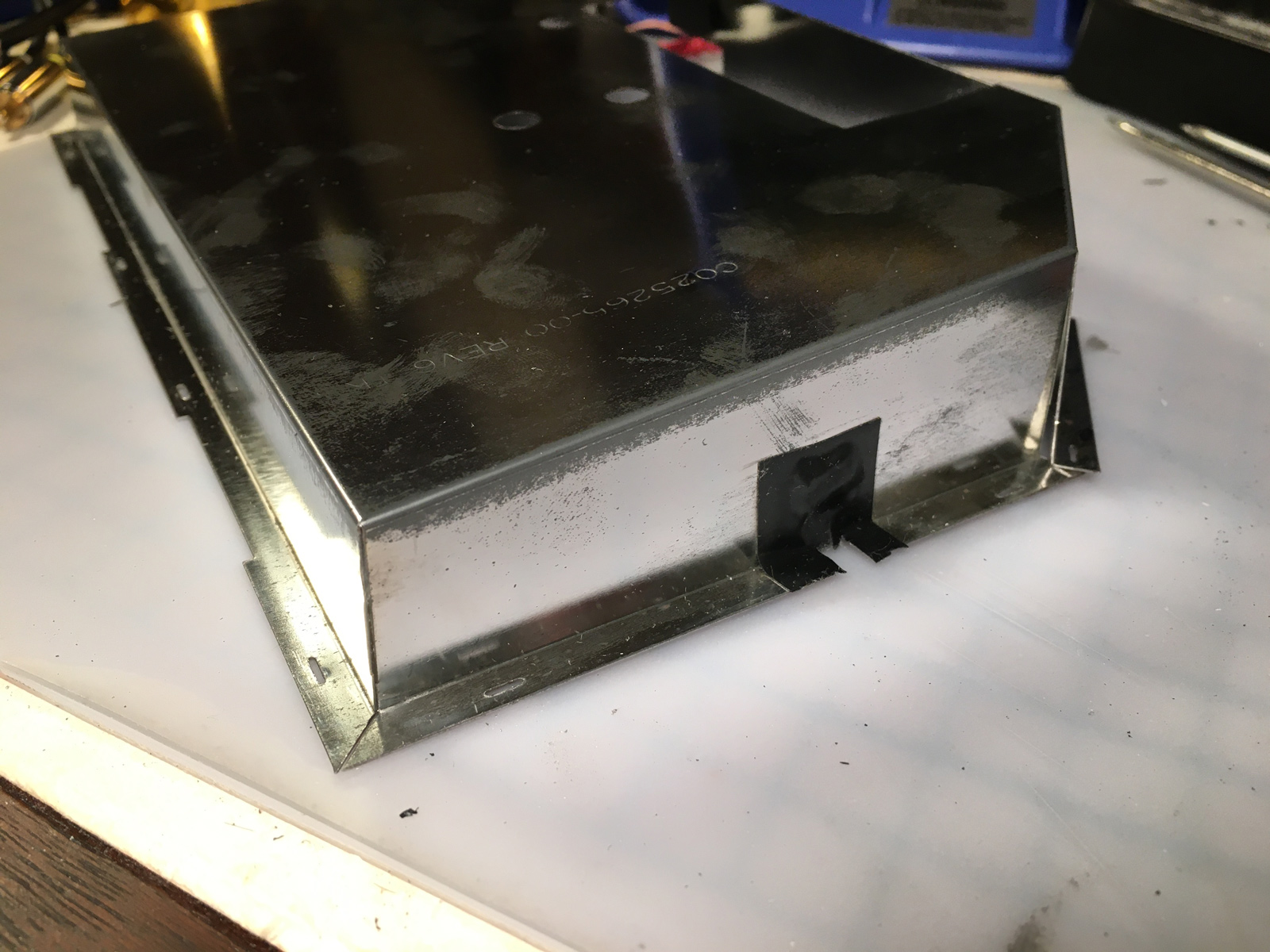

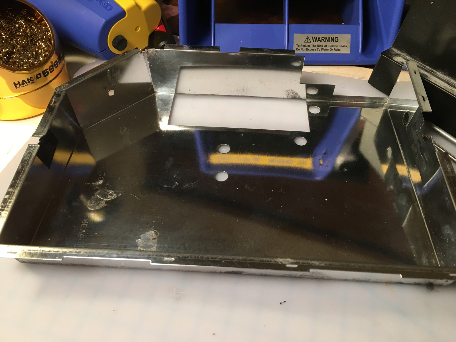

Before final reassembly, it's time to clean off the solder blob on the RF shield leftover from the previous mod:
And to clean up the solder blobs and adhesive gunk on the inside of the shield:
Also, I needed to make a small notch for the Compatibility Switch™ wire to feed through:
I covered the notch from both sides with electrical tape to protect the wires, and cut a slot for the wires to feed through:
On the expansion port side, I did the same thing, but left a larger area for the wires:
I removed the solder and cleaned up the adhesive, then polished up the whole thing with some more Flitz. Shiny!
It took a lot of solder wick to get the blobs off. I couldn't get rid of the fingerprints though - they're etched through the finish into the bare metal beneath. I'm wondering if this happened at the factory when it was first assembled?

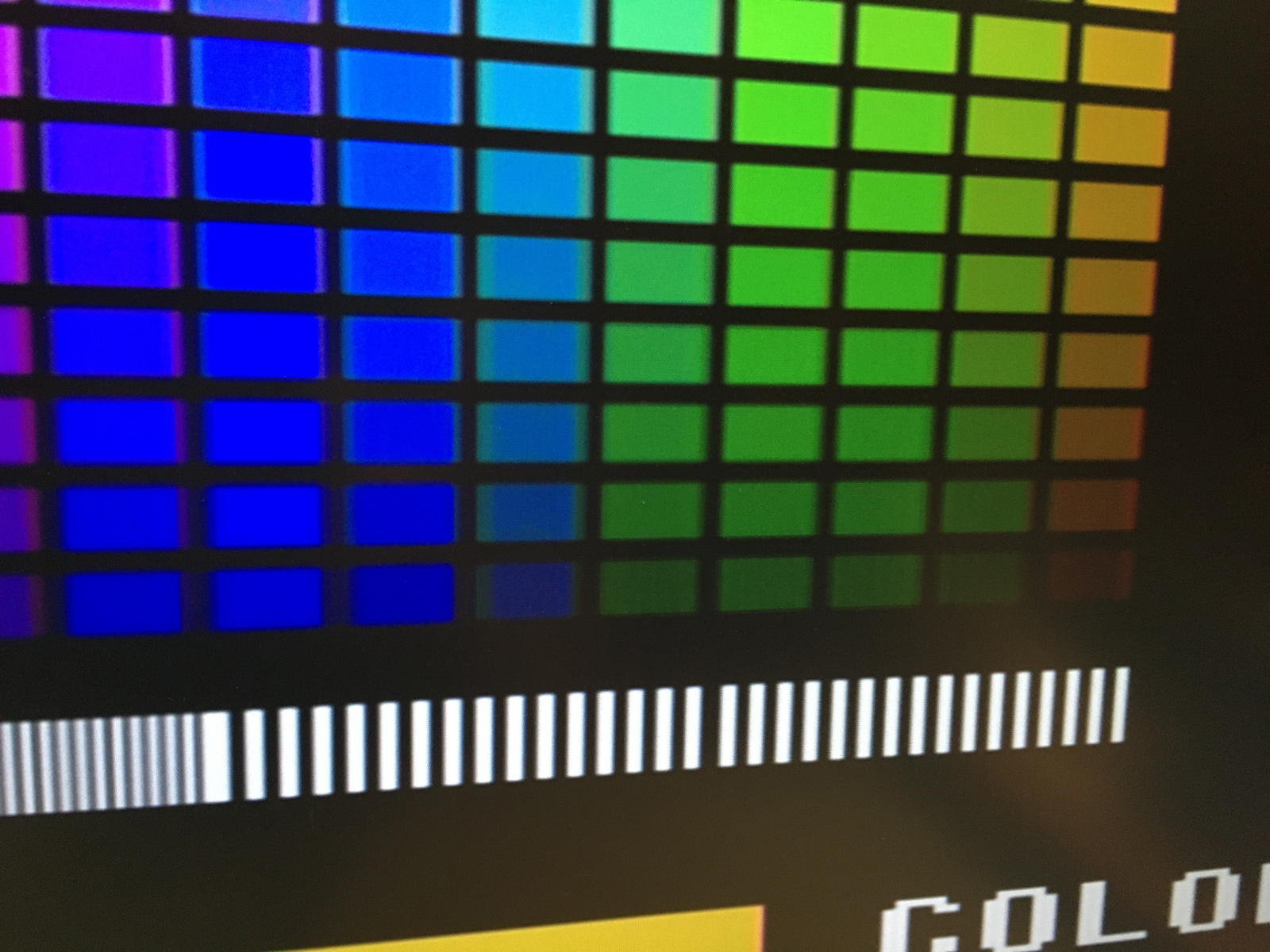

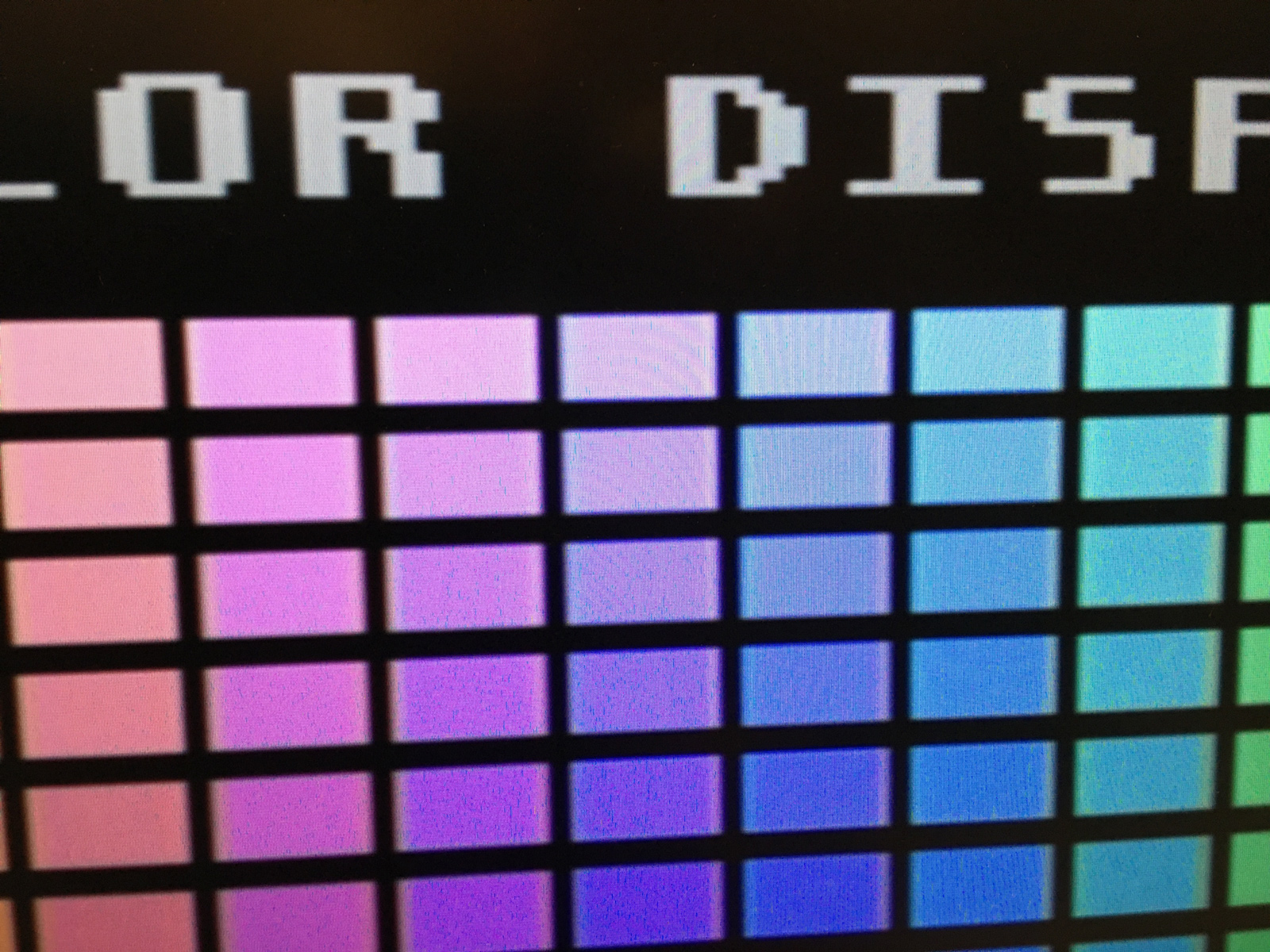

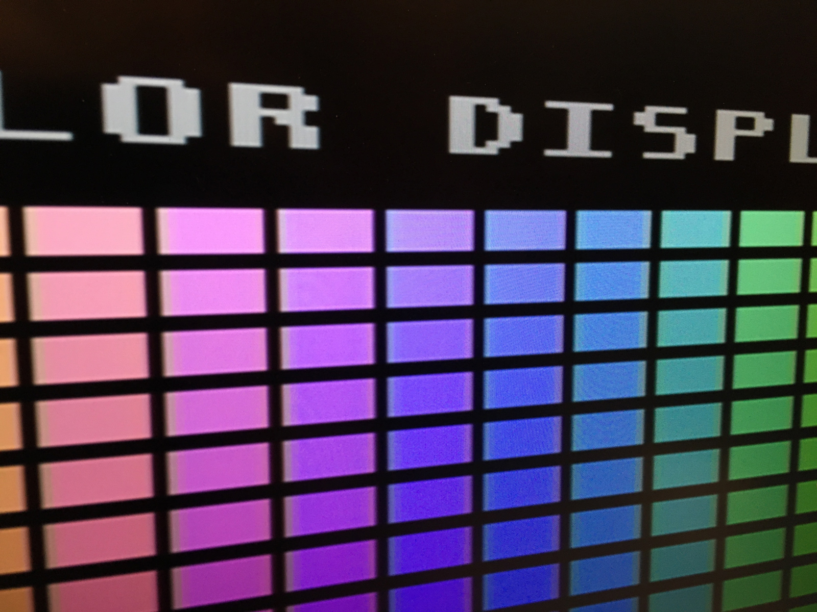

2600 video looks good:
7800 video looks good!

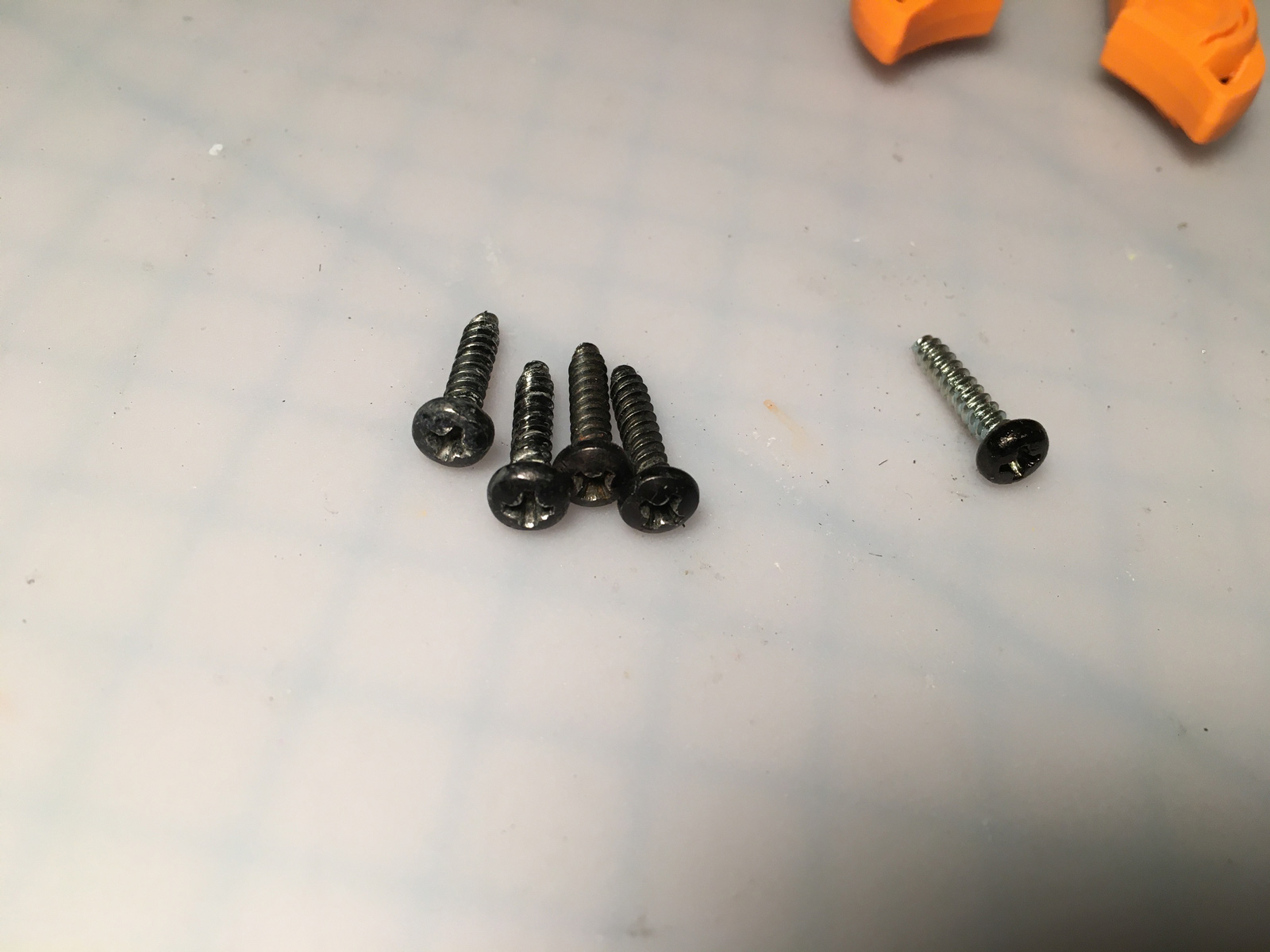

Right - time to put this back together! But first... I'm missing a screw. Rather, the 7800 is. Fortunately, Atari used the same sized screws for other things - in this case, CX-40 joysticks. So I grabbed a spare screw from a broken joystick, colored the top of it black to match the rest, and NOBODY WILL EVER KNOW!! Unless they read this. So, like... five people.

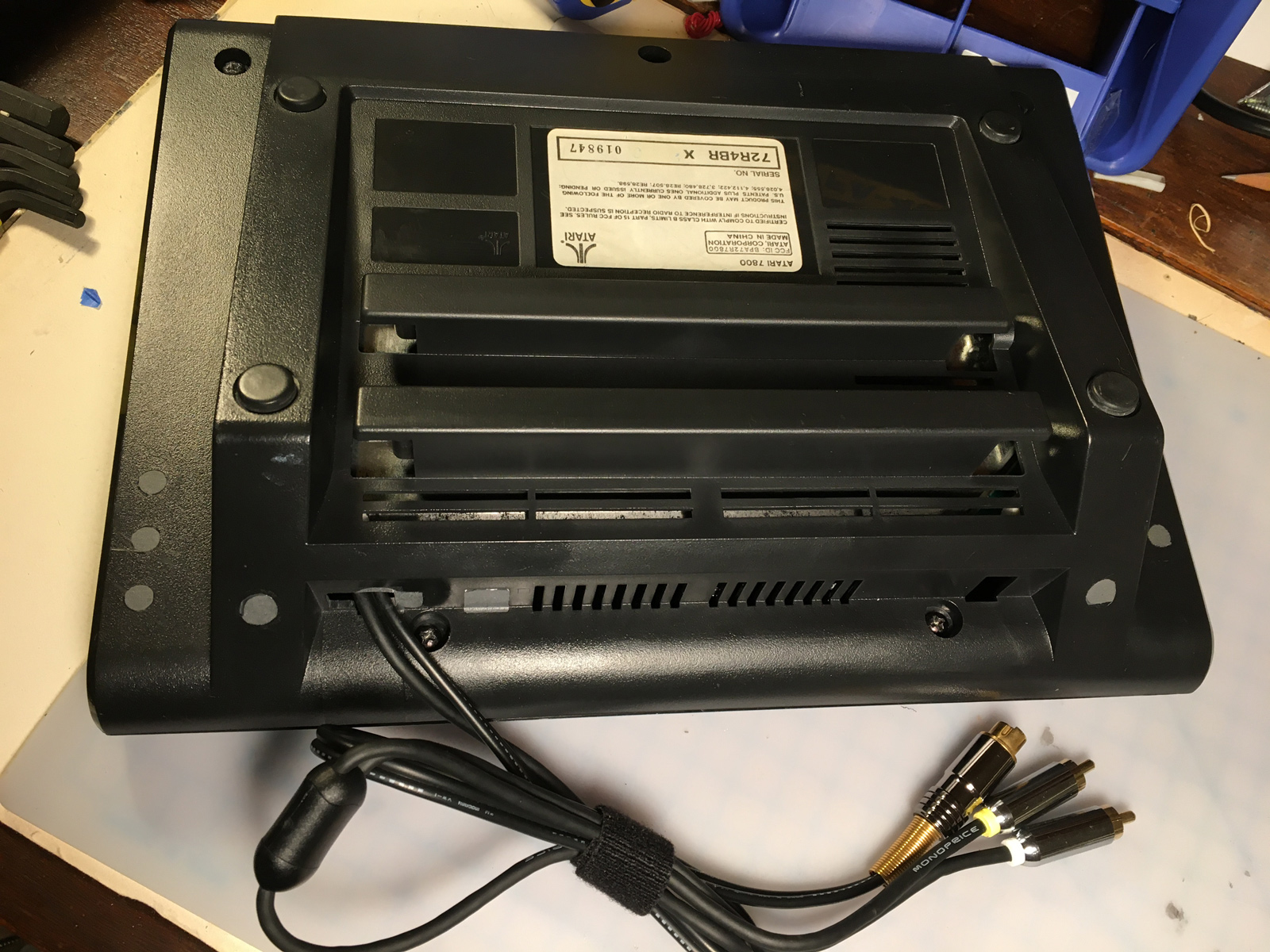

Cables are routed... RF shield is reattached... time to button 'er up!
Underneath, showing where the cables exit. Also, in case anybody wants to add this to the list...

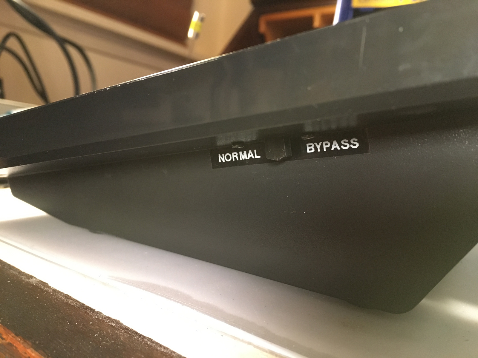

The Magic Switch of Compatibility™! FWIW - every Activision game I've tested works with the switch in either position. :roll: However, I've been testing them on a Harmony cart, since my real carts are still packed away. But hey - it has the switch!

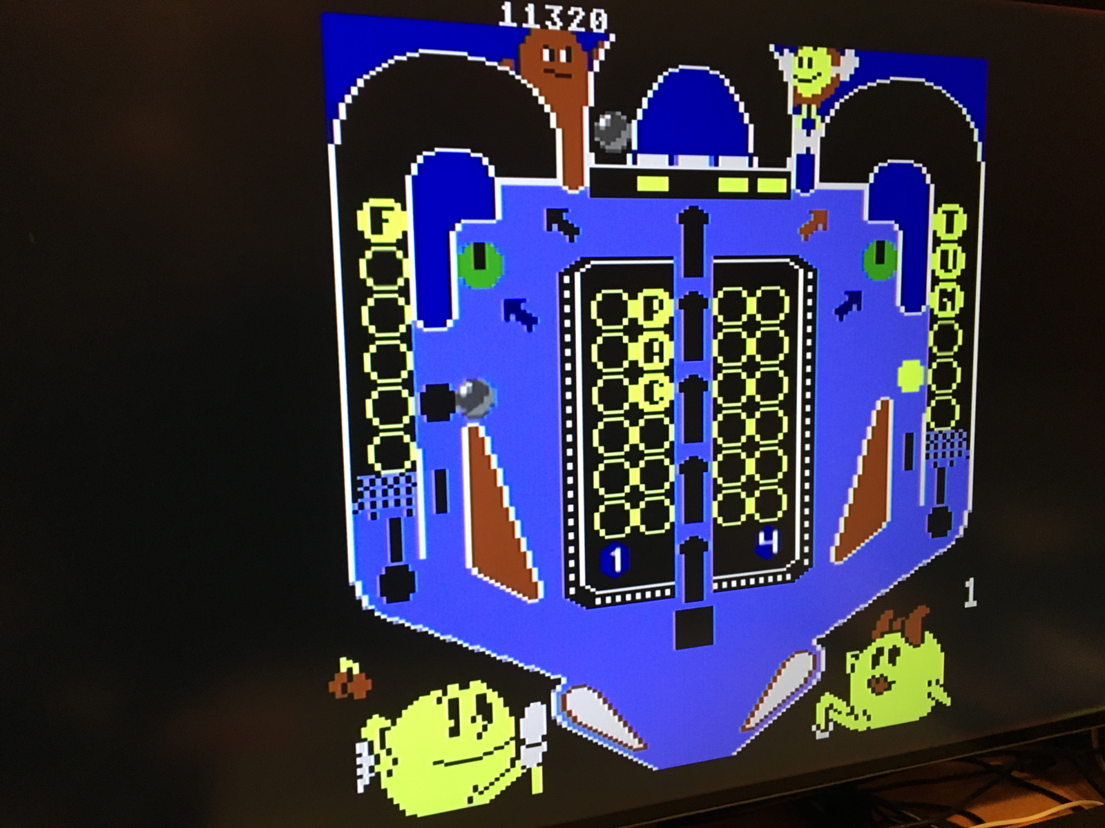

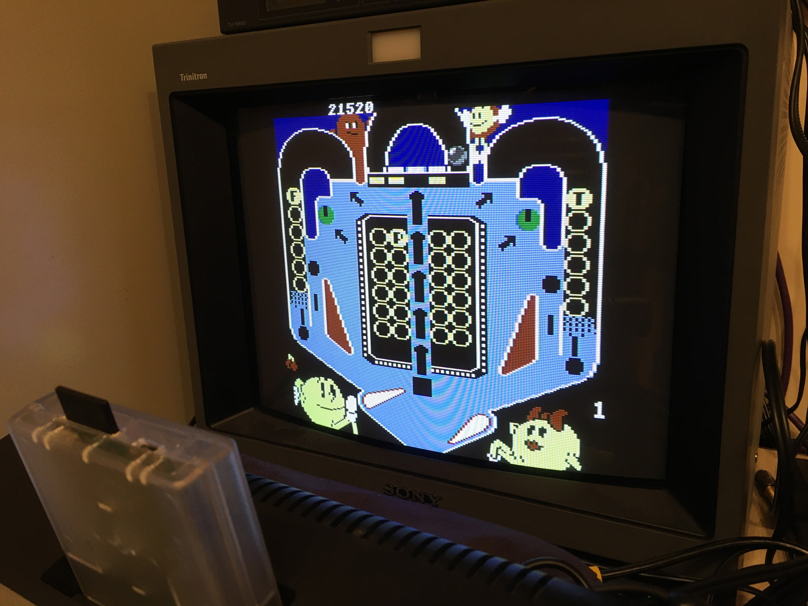

And since I got to play the real Qix the other day... I just had to fire up the Champ Games 2600 version - Qyx:
And of course, Baby Pac-Man:
Looks great in HD, too!

I've tried Robot Tank, Space Shuttle, Kung Fu Master and Dark Chambers; on an original Harmony Cart and an Encore. All work with the switch in either position. I have none of those games on original carts.
However... !
Pitkat only works with the switch in Bypass (on the Harmony and Encore)! So the switch does indeed work. At least in one case. So I'll take it. :D
Bypass:
Normal (one of several ways it fails - sometimes it's this, sometimes it's a garbled mess):
