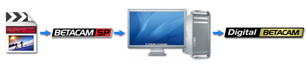

Time code assigns a specific number to each frame on a videotape. You can't tell where anything is without it. Also important, is we want to end up with a brand-new Betacam-quality master in the end. Even though DVDs are highly compressed, we want to start out with the best possible quality master, prior to compressing it. (And of course, we want the best archival quality copy for safekeeping.) The problem is that to work at the highest possible quality (10 bit uncompressed), we're dealing with a data rate of 270 Mb/second, which works out to something like 1.7 TB (yes, with a "T") for all of the footage. Besides the sheer amount of storage, you need a full-fledged video-capable RAID to be able to handle that data rate, in order to be able to even see what you're editing in real-time. The plus side, is that when finished editing, is it's a straightforward matter to output the final piece to a new Betacam (or more likely, Digital Betacam) master. Since the end result is digital, it can be compressed directly from that file for use on the DVD, suffering as little generational loss as possible. (I'll put up a whole 'nother blog entry someday about DVD authoring, and even teach you how to sing "The MPEG2 Alphabet Song". It'll be fun!)
While I do have some access to such a system, I can't monopolize it, or its attached storage, (nor do I really want to camp out in that editing room) for however many months this is all going to take. The other big drawback here, is there's no back-up of the digitized media. So if any of it gets lost or deleted, it has to be recaptured from the master tapes again on that same system. This locks me into a single editing system, and severely limits the time I can work on it, plus it doesn't keep the project completely safe from others needing to use that system. So there needs to be another way. The key, is time code.
Having talked with an editor and technician where I work, it turns out the best approach for this project is to first make a dub of the Betacam source tapes onto a format called DVCAM. This is a digital, compressed format (similar to DV), which brings a couple of benefits with it. First, it maintains the time code of the original tapes. Second, it gives me a good-quality back-up of the original source tapes (currently, there are none). Third, when I transfer these into the computer, they're already compressed at a much lower data rate (25 Mb/second) which works out to a mere 157 GB for all of the footage. This means the entire project can fit on a typical FireWire hard drive, can easily be backed up to a second drive, and can be plugged into practically any Mac running Final Cut Pro, so I can work on the entire project almost anywhere. Even on my iMac in the comfort of my own home. Better still, DVCAM decks are a lot more commonplace than 10-bit uncompressed capture stations, so if I need to re-import footage during the editing process, I can do it pretty-much anywhere.
This is called offline editing. In this case, using the DVCAM footage as a more manageable substitute for the Betacam tapes.
Since this is all frame-accurate with the original source tapes, once I'm done editing everything as DV files, I can take my Final Cut Pro project file to the uncompressed capture station, load it up, and tell it to only re-capture the footage - from the original Betacam source tapes - that was used in the final edit. Admittedly, this will still take some time, as I have to feed tapes to the machine as it needs them, but it's still only a few hours at most, and the end result will be exactly the edits I created using the DVCAM footage, but at full Betacam quality, and without all the unused footage. Final Cut Pro simply replaces the DV footage with the uncompressed footage, and from there, we can create a new Digital Betacam master, as well as the compressed DVD version.
Also, even though the final master will be about 121 GB per hour, it's not likely to exceed two or three hours, so that's still a reasonable amount to fit on an affordable FireWire drive, giving us not only a new master copy on tape, but a back-up on a hard drive as well. Plus, there will also be the DVCAM back-ups, which are of a very high quality in and of themselves. (The dubs from Betacam to DVCAM are being done using component video, and balanced audio.)

10-bit uncompressed at what sampling rate? 910fH 4:2:2 I bet.
Is the timecode stored on the Betacam SP tape (i.e. not just an offset from start of playback)?
The only problem using DV as a source for DVD is the 4:1:1 versus 4:2:0 chroma subsampling. (Although 4:1:1 makes perfect sense for interlaced sources while 4:2:0 gives the famous chroma bug which plagues many DVD players and STBs.) But what you're doing makes perfect sense for off-line editing.
Link to comment
Yep, it's 4:2:2. The i/o uses SDI to and from a Digital Betacam deck (SMPTE 259M).
The time code is on the Beta SP tapes, and to this point, is unbroken on each one. If there were time code breaks, I'd have some issues to deal with. But so far, so good. They did a really nice job shooting this stuff.
