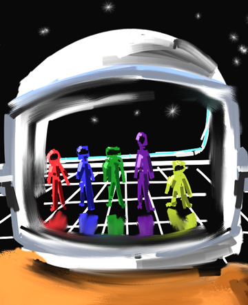

Originally, my concept was to have a group of alien pilots standing in a spaceship hangar, all looking at you (the gamer), basically challenging you to lead them. The sketch, which I threw together in Painter, was really rough, and showed the pilots reflected in your helmet's visor:
I wanted the aliens to all have a different appearance - color, shape, etc., so it was obvious they were from different planets (hence all the different ships in the game), but I still wanted there to be some common element tying them all in together. At the time, I figured it would be helmets with big, dark faceplates. But even though that element remained, I'd come up with something else, later.

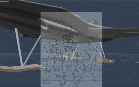

Next, I needed to do something to establish that this was all taking place in a spaceship hangar. Dave Dries suggested having a ship in the hangar practically right on top of them. That sounded like a good idea, so I started building a ship in 3D:
This was hacked together in Carrara, another 3D program. Even though it's "possible" to move models between Poser and Carrara, I really didn't need the models in the same program. I just needed to position the ship in such a way that it looked like the pilots were standing in front of it when everything was put together. So I printed out a copy of the pilot line art, and taped it to my monitor. This allowed me to see through it enough to position the ship behind it, and line things up. Sort of like this:

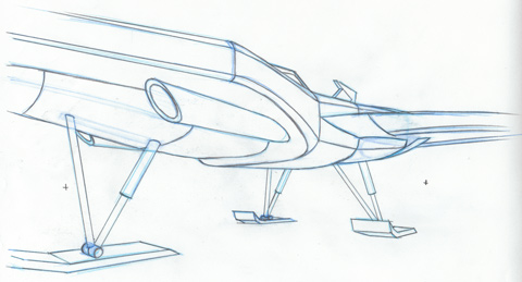

When I got the ship positioned, I did a quick render of it, and printed that out. Then I threw a sheet of paper on top of that, and re-drew the ship:

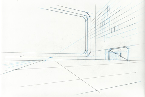

Another drawing on top of that resulted in the hangar (based on the grid lines in the 3D render):

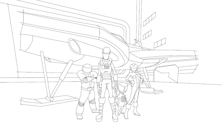

After that, I went in and cleaned up all the lines in FreeHand, as I'd done elsewhere:
Everything is separated onto individual layers, to make it easier to paint. I still use the basic techniques shown in my Photoshop tutorials from a few years ago, although I should update those, since I've learned some new tricks since then.

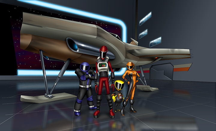

This is the final art, prior to being cropped:
Note that the edges are unfinished. Even so, I ended up making this much wider than it really needed to be, since the emphasis was always supposed to be on the pilots. But I tend to get carried away with this stuff. (And I justified it to myself by reasoning that if it had won the contest, I could re-use the larger art for the manual. Oh well... ;))
