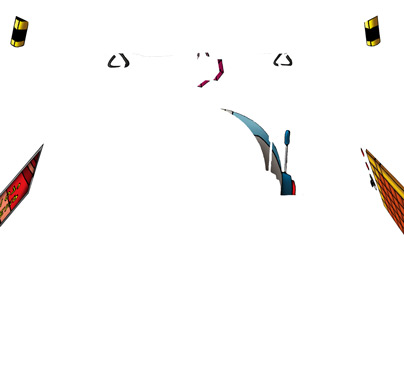

This is what the reflections layer looks like, with the layer mask applied (shown over a white background):
The various pieces (helmet, dice, etc.,) are still fully intact. The mask allows me to move them around as needed, but restricts them so they only appear in the windows.
