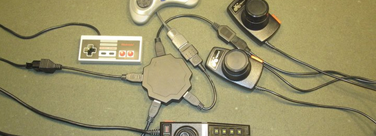

    For anyone that has nto heard of th e Bliss-box its a product for all the retro controllers. It's not for everybody but for anyone really in to emulation its pretty damn useful.
    The 4-Play is a modular controller adapter for both the modern and retro gamers connecting all your favorite console controllers (up to four at once) to your computer.
    It begin kick starer now, the idea is to raise money to sell it for a reasonable price. Its a bit too niche for the KS I'm afraid but its worth a shot.

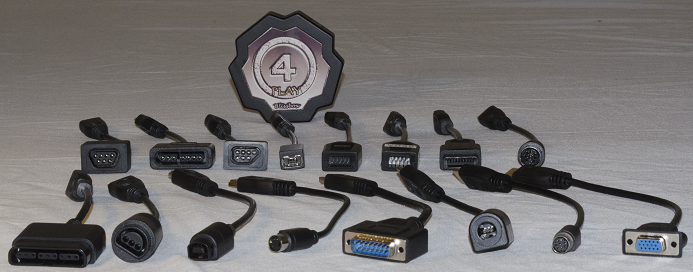

    Hey AtariAge, after a long effort I finaly made it to production. For those that do not know the Bliss-box prodcut "4-play" is a modular controller adapter for both the modern and retro gamers connecting all your favorite console controllers (up to four at once) to a computer.
    KS link here
