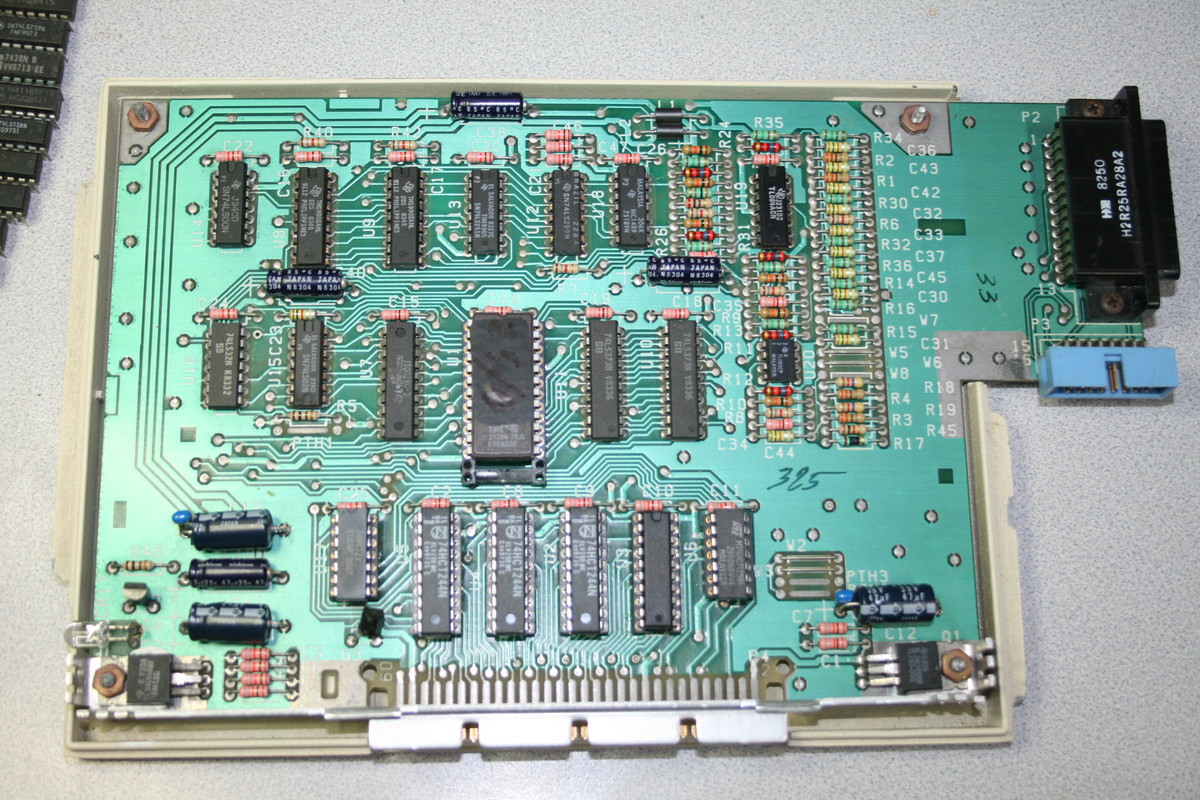

2 hours ago, jedimatt42 said:
I think my issue may be more related to the SCSI device... during one of the reboots today, the thing actually booted off the SCSI card... was reproducable a couple times after a warm boot... CTRL-SHIFT-SHIFT But then trying to reproduce from cold, then warm, wasn't possible.
-M@If your "G" has the 1.6 upgrade that looks like the card in the pic above and you are able to boot from the SCSI BOOT EPROM intermittently I agree that the storage setup/device you are using is the next place to look. I've never tried your setup myself as we mostly just used SCSI 1 internal hard drives, SyQuest EZ-135 and ZIP drives with the cards during that 1998 - 2004 period. Also SCSI 1 internal CD ROM players were used when Wolfgang's CD Commander software came on the scene.
BTW jedimatt, it comes to mind one of the hardware upgrades that was part of the 1.6 upgrade was a Schottky diode at location D1 for those using ZIP drives so keep that in mind if you are booting from a ZIP drive.
9 hours ago, jedimatt42 said:
I have a rev G card, with DSR ROM 1.6a. I can find DSR ROM 1.6b on whtech.com - haven't had a chance to find a 64k eprom to try yet... but basically the SCSI configuration is working fine on my GenMod Geneve, except booting... I have SCSI/SYS on the scsi drive (compact-flash) but it doesn't load from the Geneve Boot ROM ( v1.0 genmod ) - I just get a SCSI/SYS not found error.
I can load and run SCSI/SYS off of the SCS1. volume from GPL speed 1, ROMPAGE mode, but I'm missing something to be able to boot from it.What else is required to be able to boot?
I can't find any info on the difference between DSR 1.6a and 1.6b. Is 1.6b known to be required to boot?
-M@
The old grey matter isn't what it used to be and it's been years since I sent all the SCSI stuff back to Don when he sold the WHT SCSI rights to competition computer but going by what I've read above my gut tells me PDMA (Pseudo Direct Memory Access) is not turned on in MDOS. I'm assuming this "G" model has the 1.6 upgrade with a daughter board that changes the on board narrow package 32k to the wide package 32k? We had to make that change because the narrow package speed caused problems that the slower wide package solved. I'm forgetting versions of MDOS but it used to be that you had to turn PDMA on until Gazoo came up with his SCSI Boot EPROM and an MDOS change that had PDMA always on. I'll try to pull out my notes later today and go over Gazoo's notes on setting up the Geneve for SCSI Boot. I don't seem to recall any notes about GenMod requiring different parameters and basically the 1.6 WHT upgrade didn't care what Geneve you had as long as it had the 32k fast RAM upgrade. BTW, after the 1.6 upgrade the "G" model WHT SCSI controller is the thoroughbred of the series with the "F" being the most stable with all manufacturer drive combinations in my opinion, and the "E" being the slowest.
