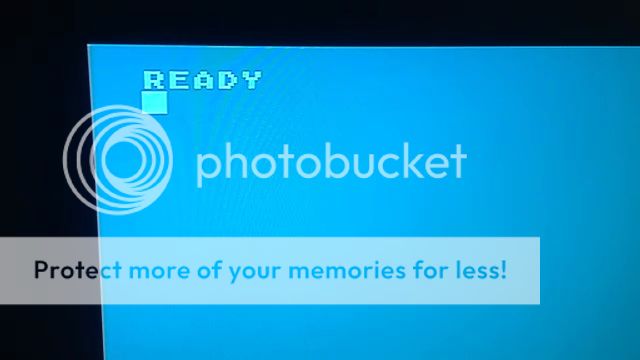

    New board layout is as follows - Using the pink wire from pin 15 to 9, then pulling cleaned sync from pin 10 to new monitor port (white wire).
    cfe8b624-bfb0-4832-a975-24cace9939b3_zps
    Grainyness now gone but the picture is not stable, screen does a flicker every 6 - 10 secs, I've taken a quick video - see below (I'm guessing its a timing issue), what do you think?
    Having difficulty linking the video file, try this url - http://vid87.photobucket.com/albums/k123/mjsaville/CD4050%20mod%20with%20unused%20gate%20-%20Picture%20unstable_zpsb4h3rv8m.mp4
    Very nearly there though, I have also tried just using the output from pin15 directly as sync, picture quality still better than I had before (not as good as when I use the spare gate), but the 6-10 second screen flicker remains.
    Very weird - what do you think?
