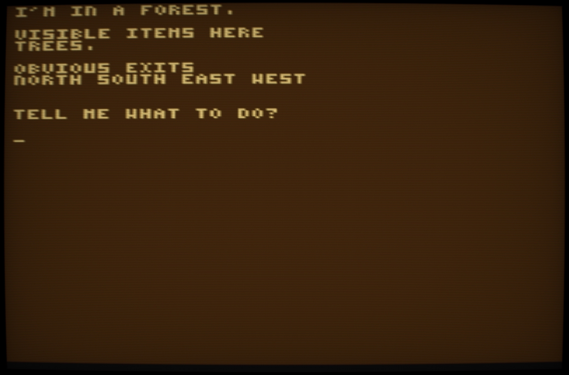

  8. I've had a go at porting Scott Adams' Adventureland, mainly out of interest to see if this kind of text adventure was possible on the 2600.
    It's a more or less straight compile (some changes) of the C version of Adventureland to ARM.
    I added the main ARM program which:
      - accepts keypad input by cycling through groups of letters (phone pad style)
      - packing letter glyphs into datastreams (two glyphs per datastream)
      - does some basic word wrapping
    The 6507 program meanwhile renders the 15 datastreams producing a 30 column text display. For this first version, the renderer is very simple and works over three frames so a slow phosphor fade is recommended.
    Adding a more advanced text renderer (ie. one that works over two frames) should be possible It's just a case of reading and ordering the 15 datastreams appropriately and you shouldn't need to touch the ARM program.
    Binary and source on github.
    https://github.com/JetSetIlly/Adventureland-2600/
    As I say, I wrote it out of curiosity and experimentation but it might prove fun to play.
    • Like 8
