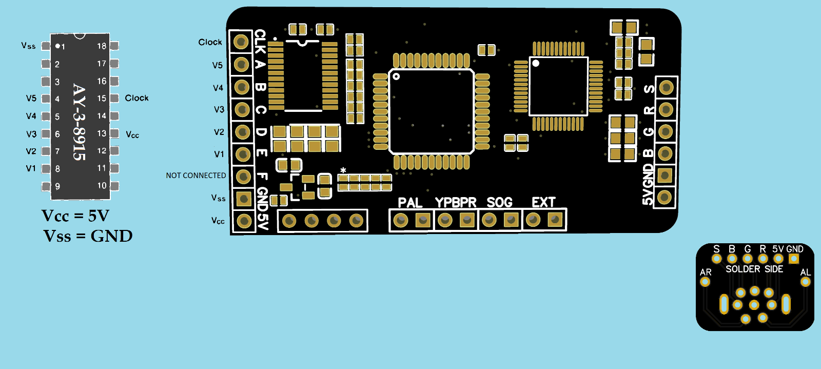

    So I have some questions about the board itself. For reference here is the board from Crayon King's ebay listing:
    I did not run any 5V or Sync out to my TRRS jack...I dont think it needs that...but maybe it does...if so I'm not sure where to hook it up to the TRRS port.
    Also, I jumped the YPBPR to itslef...which I think is how you tell it you want to run component...but maybe not. Other than that I just wired it up exactly like the diagram.
    Now that I have it all together it does not turn on reliable...I think this might be due to that bad 5 pin connector ribbon...sometimes it shows up as a solid magenta screen. Sometimes white. sometimes black. and sometimes it shows the game.
    I did replace the caps but not the voltge regulators. I'm actually not sure which voltage regulator is which, I know there is a 5v and a 12v. Any ideas which one is which?
    I feel like i'm pretty close on this but it's not quite perfect yet. Anyone else with experience have any trouble shoooting tips I can try?
