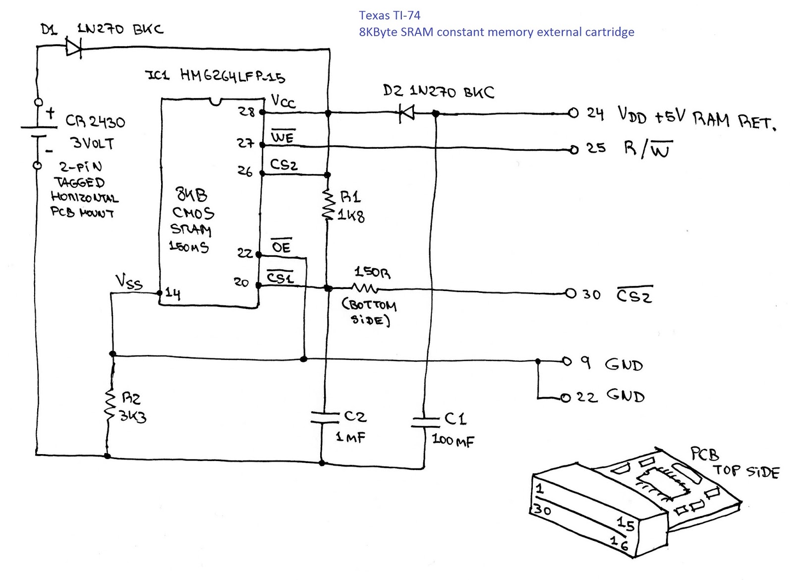

  4. What are your thoughts on rolling this out? I could perform an initial build and check unless you have or can obtain a ti-74. I’ve used kicad for layouts and have had boards made before. I’m not familiar with the brd files nor how to go from them to a pcb mfg. Or do you make, sell, etc.?
    I have no real preferences but that these are available to the community.

  5. I had a few hours available this morning to step into this a bit. I replaced the 8 KB RAM chip with a 32. It got fairly involved as multiple solder pads popped up and off, so had to run more cables. The board truly was quite fragile. I remember repairing some irrigation controllers built in the mid 1980s with PCBs that with the slightest anything gave up their traces. Maybe something of the era. Thankfully my TI-99s are not like this. To excise the CE connection I had to cut two traces and jump, as pad 23 for the memory was in line in the CE/-CE circuit rather than connected at an edge.
    Calling addmem only resulted in an additional 8 KB (total 16 KB). At least the board lives, but it is possible I goofed up A13 somehow so have some debugging to do. I read somewhere that at least with the TI-95 one had to set certain values for the 32 KB to be recognized. Maybe that's so for the TI-74. I should have saved links to all relevant but perhaps I missed one.
    Hopefully I can get around to checking the capacitors later in the weekend and have pretty much ran out of time at least for today.
    If this project only yields 8 KB RAM cartridges, I will be disappointed, but it will still be successful as there appears to be many TI-74 and TI-95 units out there without one. 8 KB vs 16 is quite a bit. My CC-40 with 18 KB seems to have plenty. At this point I still need 3-4 RAM cartridges.

  8. On 4/29/2024 at 7:44 PM, brain said:
    @brain, X1 doesn't seem to comply with page 11 of the Technical Data Manual, in terms of pin definitions for addresses and data. For instance, A14 should be pin 29 but is pin 12 on X1.
    The inputs to IC1 coming from X1 are not mapped 1:1, and A14 is connected to GND. The data pins are also not 1:1. I suppose in the end as long as every address and data pin is mapped uniquely, it doesn't really matter. A14 is a problem obviously.
    As to verifying the capacitors, how can that be done? There's the pictures of the board with parts but I don't see values or identifying parts.
  9. @brain, I'm back from two weeks of vacation and now a week of work, so have had a bit of time to get back into this.
    Doing this with a new PCB obviously would be a lot nicer--have you been able to make any progress? I know you have a lot of irons in the fire.
    But in the interim...
    I reviewed the technical manual you linked and noted all the proper signals are present at the edge connector so that's a good start. There's also some notes about generation of "wait states" by essentially slowing down the CPU when accessing addresses that are slower than the CPU can handle (it doesn't have a concept of wait states built-in). I also wonder how "CALL ADMEM" works, whether it attempts to write/read in the expansion RAM range until it hits a bad return. Since I've read that 32KB cartridges have been made for the TI-95 and claims are they work on the TI-74 I'll ignore these.
    Comparing the existing 8KB RAM chip (HM6264LFP-15) and the candidate 32KB (HM62256LFP-15) yields minimal differences:
    The 8 KB memory has two fewer address pins, as expected, but also has two CEs (-CE and CE).
    The 32 KB memory has the two additional address pins and eliminates CE. A14 is assigned to pin 1 which is NC on the 8 KB chip. A13 is assigned pin 26 which is CE on the 8 KB chip.
    The simple hand-drawn schematic seems simple enough. To alter the board, it looks like memory pin position 26 should be eliminated from the existing circuit and connected to A13 on the edge connector. A14 needs to be connected from the edge connector. It's a shame the memory chip is surface mounted. That'll probably require drilling a hole to run a wire from edge connector pin 29 A14 to the chip's A14--there's very little space on the sides of the board, but maybe there's a little room at the back of the board to run a wire from bottom to top. The board is packed very tightly in the module.

  11. 31 minutes ago, brain said:
    I think so.  In the schematic on that page:
    They left off the address and data lines.  That's probably OK, I just need to verify I have a pinout of the TI74 connector so I can make sure I connect all those up.  If, though, you can trace one of the lines (maybe pin 13 on the IC), that would help me  ensure I get things ordered right.  TI's  D7 being D0 for everyone else messes with me sometimes.  It's a shame TI74 carts have the connector on the cart, as that means it'll be harder to reproduce.  Good measurements of the pitch of the connector (if that info is not already known) and the pad size would be helpful, to see if a connector can be sourced.  I've never done a TI74 cart, so maybe the above information is already known in the community.  If so, a link is fine.

    This is the best I've found for a schematic and parts list. https://www.hpmuseum.org/forum/thread-7146.html. Not sure if the board connects all address pins. Supposedly there's a TI-95 cartridge with 32 KB that does fit but all these are pretty difficult to find. Making a new board is probably easiest.
