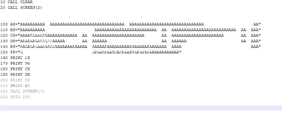

Opry99er Posted November 17, 2010 Author Share Posted November 17, 2010 Here's an idea... I tried this just now and it seemed to work fine... you just have to be deadly accurate or you get junk... Use Notepad++ to create your design like this... Then take each line and backspace until you get long strings of A's and space characters... essentially taking 3 lines of "map" and compressing them down to 1. In this way, you can design your map in notepad and then just add the line numbers. =) Probably not revolutionary, but something cool, nonetheless Quote Link to comment Share on other sites More sharing options...
Opry99er Posted November 17, 2010 Author Share Posted November 17, 2010 (edited) Here's a screenshot of that parsing method.... code below. 10 CALL CLEAR 20 CALL SCREEN(2) 30 CALL CHAR(65,"44FF111111FF4444") 110 A$="AAAAAAAAAA AAAAAAAAAAAAAAAAAAAAAAAAAA AAAAAAAAAAAAAAAAAAAAAAAAAA AA" 120 B$="AAAAAAAAAA AAAAAAAAAAAAAAAAAAAAA AA AAAAAAAAAAAAAAAAAAAAAA AA AAA" 130 C$="AAAAAAAAAAAAAAAAAAA AA AAAAAAAAAAAAAAAAA AA AAAAAAAAAAAAAAAAA AA AAA" 140 D$="AAAAAAAAAAAAAA AA AAAAAA AA AAAAAA AA AAA" 150 E$="AAAAAAAAAAAAAAAAAAAAAAA AAAAAAAAAAAAAAAAAAAAAAAAAA AAAA AAA" 155 F$="A AAAAAAAAAAAAAAAAAAAAAAAAAAAAAAAAAAAAAAAAAAAAAAAAAAAAAAAAAAA" 160 PRINT A$ 170 PRINT B$ 180 PRINT C$ 190 PRINT D$ 200 PRINT E$ 210 PRINT F$ 220 CALL SCREEN(7) 230 GOTO 230 REMEMBER!!! your PRINT statement will only print 28 characters per line, so make sure when you are designing your maps in notepad, 28 per line. =) Edited November 17, 2010 by Opry99er Quote Link to comment Share on other sites More sharing options...
Opry99er Posted November 17, 2010 Author Share Posted November 17, 2010 100 A$=A$&"A" 110 PRINT LEN(A$); 120 GOTO 100 All the way to 255 and then it repeats. Quote Link to comment Share on other sites More sharing options...
sometimes99er Posted November 17, 2010 Share Posted November 17, 2010 100 A$=A$&"A" 110 PRINT LEN(A$); 120 GOTO 100 All the way to 255 and then it repeats. Yeah! Makes me think that strings can only hold 255 characters. TIB continues silently whereas XB issues * WARNING STRING TRUNCATED IN 100 Quote Link to comment Share on other sites More sharing options...

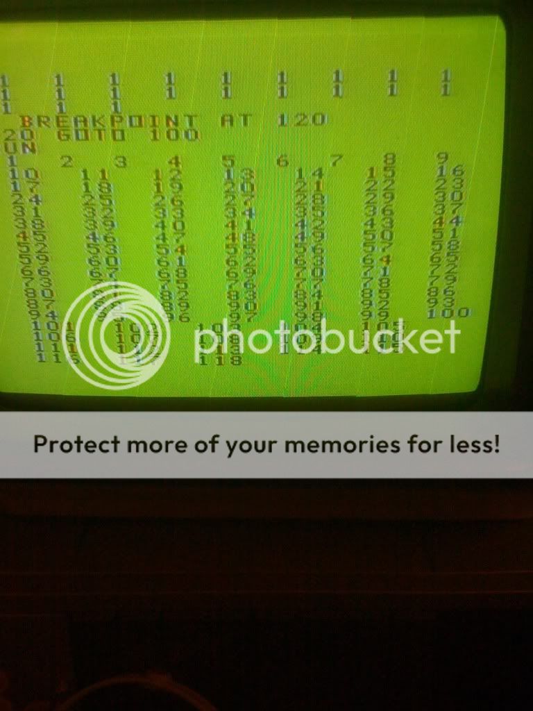

Bones-69 Posted November 17, 2010 Share Posted November 17, 2010 (edited) Here is something interesting I found while experimenting in BASIC & XB. Given that I only write in XB, I have always been aware that there are speed advantages in producing random numbers in advance for programs. I usually do this as part of the initialisation in order to keep as much of the time consuming stuff outside of the actual program and then just call random numbers from arrays when required. So I did the following test with the intention of measuring the actual advantage in BASIC and I was incredibly surprised there was ZERO advantage in doing the hard work first! In XB I can pick up a speed increase of 50% between the two routines below, but in BASIC it makes no difference whatsoever. If anybody has any theories here as to what is going I would love to know! The real question is not why there are differences between the two routines in XB (I think this is obvious, producing random numbers is slower than calling a known value), but what is going on in BASIC to produce identical results in the two routines? Bugger... All my little tricks that work in XB don't work in BASIC! 100 RANDOMIZE 110 INPUT "PRESS ENTER":A$ 120 A=A+1 130 PRINT RND 140 IF A=100 THEN 160 150 GOTO 120 160 PRINT "TAKES 20 SECONDS IN BASIC AND 16 SECONDS IN XB" 170 DIM B(100) 180 A=0 190 A=A+1 200 B(A)=RND 210 IF A=100 THEN 230 220 GOTO 190 230 A=0 240 INPUT "PRESS ENTER TO RE-TEST":A$ 250 A=A+1 260 PRINT B(A) 270 IF A=100 THEN 290 280 GOTO 250 290 PRINT "TAKES 20 SECONDS IN BASIC AND 10 SECONDS IN XB" Edited November 17, 2010 by Bones-69 Quote Link to comment Share on other sites More sharing options...
sometimes99er Posted November 17, 2010 Share Posted November 17, 2010 (edited) Holy Moly. I was just about to believe there wasn't much difference in speed between the two. I guess you had the 32K Memory Expansion connected ? XB will make use of it instead of VRAM, somewhere, so I guess that's the reason. Edited November 17, 2010 by sometimes99er Quote Link to comment Share on other sites More sharing options...
