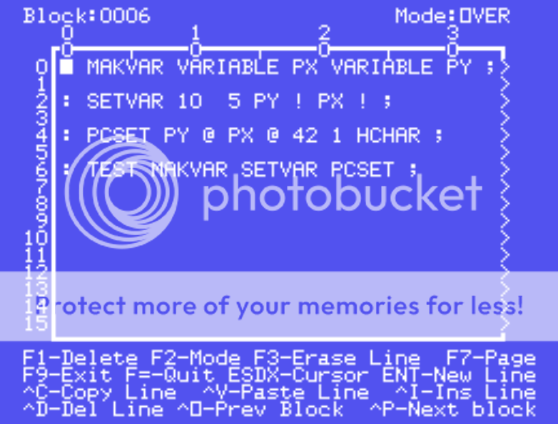

Opry99er Posted October 18, 2011 Share Posted October 18, 2011 Hey Willsy... been trying to get some results in tf and making some progress. A few questions for you, if you don't mind... 1) Could you put a couple examples of simple sprite setting and moving? I tried to create a SPRITE and had an issue. Here's the word and I tried to attach a pic. : ADSP PAGE 0 MAGNIFY 1 10 10 42 15 SPRITE BEGIN BREAK? AGAIN ; This would create a SPRITE #1 at location 10,10, ascii value of 42 (*) and white... Not exactly showing up as I'd have thought... 2) Here's an issue I'm having with getting a couple of words to execute... This is in BLOCK 6... I could combine this and make it smaller, but I wanted to make it as easy to read as possible. Here I create two variables, store them with values, fetch them from memory, and attempt to use them. : MAKVAR VARIABLE PX VARIABLE PY ; : SETVAR 10 PY ! 5 PX ! ; : PCSET PY @ PX @ 42 1 HCHAR ; : TEST MAKVAR SETVAR PCSET ; When I do this, I FLUSH, then COLD, then 6 LOAD... it then gives me the following error message: Error:PY not found in SETVAR in block 6 Attempting to execute any of the words results in "Error:TEST not found" I tried re-organizing it... : MAKVAR VARIABLE PX VARIABLE PY ; : SETVAR 10 PY ! 5 PX ! ; : PCSET PY @ PX @ 42 1 HCHAR ; : TEST MAKVAR SETVAR PCSET ; Also I tried combining MAKVAR and SETVAR: : SETVAR VARIABLE PX VARIABLE PY 10 PY ! 5 PX ! ; and then changing TEST to: : TEST SETVAR PCSET ; Same result. When I try to do MAKVAR and SETVAR in immediate mode, it SEEMS to work... I attached 3 pictures... The test in IMMEDIATE mode and 2 pictures of the EDITOR mode test. Also tried using GOTOXY in both IMMEDIATE and EDITOR modes... In immediate mode, it worked perfectly... VARIABLE PY VARIABLE PX 5 PY ! 10 PX ! PY @ PX @ GOTOXY 42 EMIT The numbers were a bit different, but the same result... worked in IMMEDIATE, not inside a colon definition. I noticed that figFORTH (specifically TI Forth) utilizes a number on the stack when initializing a variable... (n -- ) but there's nothing about that in your glossary. Since there was nothing about that in Starting FORTH by Brodie, I assumed TF got around that. Then my next attempt... using stack only... no variables. In this case, my stack contains a y and an x value... 10 and 5. When "KEY" is called, the ascii code is placed on top of the stack. : SETVAR 10 5 ; : TEST SETVAR BEGIN BREAK? 2DUP PAGE 42 1 HCHAR (duplicate top two numbers, clear screen, place "*" onscreen) KEY 68 - 0 = IF DROP 1 - ELSE (if "E" then drop ascii and subtract 1 from top stack item) 1 = IF DROP SWAP 1 + SWAP ELSE (if "D" then add 1 to second stack item) 15 = IF DROP SWAP 1 - SWAP ELSE (if "S" then subtract 1 from second stack item) 20 = IF DROP 1 + ELSE (if "X" then add 1 to top stack item) DROP (if the key is none of these, drop it from the stack and complete loop) THEN THEN THEN THEN AGAIN ; I am getting some crazy results... starts off okay, but then the screen starts changing color and a mess follows pretty quickly. I haven't really spent much time trying to modify this... I just started messing with this concept earlier this morning... keeping both values on the stack at all times. Perhaps I'm missing some very simple stuff, so I'm posing it here to learn. =) Thanks in advance for your answers... I'm sure I'm missing simple stuff... but I'm new to Forth and I'm here to learn from the master. =) BTW, I spent some time in AceForth last night... Love to have an Ace someday. =) Owen Brand Quote Link to comment Share on other sites More sharing options...
Opry99er Posted October 18, 2011 Share Posted October 18, 2011 sorry, it messed up my formatting... I didn't put code brackets in there... I hope you get the idea... the last one was: : SETVAR 10 5 ; : TEST SETVAR BEGIN BREAK? 2DUP PAGE 42 1 HCHAR (duplicate top two numbers, clear screen, place "*" onscreen) KEY 68 - 0 = IF DROP 1 - ELSE (if "E" then drop ascii and subtract 1 from top stack item) 1 = IF DROP SWAP 1 + SWAP ELSE (if "D" then add 1 to second stack item) 15 = IF DROP SWAP 1 - SWAP ELSE (if "S" then subtract 1 from second stack item) 20 = IF DROP 1 + ELSE (if "X" then add 1 to top stack item) DROP (if the key is none of these, drop it from the stack and complete loop) THEN THEN THEN THEN AGAIN ; Quote Link to comment Share on other sites More sharing options...
Willsy Posted October 18, 2011 Share Posted October 18, 2011 Okay, the sprite problem first. Let's have a look at your code: : ADSP PAGE 0 MAGNIFY 1 10 10 42 15 SPRITE BEGIN BREAK? AGAIN ; Right. A few problems with this. Firstly, you have not selected 32 column mode - you're still in 40 column mode, so sprites won't work at all! The 'noise' you see on the screen in 40 column mode is the SPRITE routine writing into the Sprite Attribute List (SAL) - which is just normal visible screen area in 40 column mode. So, you need a 1 GMODE at the beginning (which also clears the screen) to put it into 32 column mode. Second problem: You are using sprite 1, but sprites begin with 0 in TF. Why is this a problem? Well, you might not be aware but the VDP chip is designed to disable a sprite *and all sprites after it* if its Y value is >D0 (208 decimal). TF, when it selects 32 column mode, disables ALL sprites by writing 208 to the Y value of sprite 0 (actually, it writes it to all 32 sprites). So, by selecting sprite #1, you'll never see it, because sprite 0 has a Y coordinate of 208, which has disabled ALL the sprites. Therefore, you need to use sprite #0 first, #1 next, #2 next etc (or, just set their coordinates to 0 0 and give them a transparent colour (thinking about it, I probably should have done it that way in the first place... Arse...) Lastly (!) you STILL won't see anything (!), because sprites in TF use their own character set - they do not share characters with the the normal displayable 'tile' characters. You have 256 8x8 characters that can be used for sprites, completely seperately from the normal ASCII characters. So, you won't see anything, because the sprite graphic definitions are all zeros! You need to put some data there! You can use DCHAR for this just as you do with normal ASCII characters; just add 256 to the ASCII code to define the equivalent sprite character. So, let's put all of the above into code: : TEST 1 GMODE \ select 32 column mode \ define a cross hatch character for *sprite* char 42: DATA 4 $AA55 $AA55 $AA55 $AA55 42 256 + DCHAR \ now use sprite 0 0 10 10 42 15 SPRITE ; So, sprite character 42 is now a cross-hatch shape. It's important to get away from thinking that you have re-defined the asterisk - you haven't. The asterisk is ASCII character 42. We have defined sprite character 42. The asterisk is still there - try it with 42 EMIT It's occurred to me as a result of writing this reply that the sprites being physically disabled might confuse the hell out of people - people would naturally expect to be able to use any sprite in any order. As a result, I have just changed the code that initialises the sprites in 32 column mode. It now just sets their colour to transparent, which obviously makes them invisible (so you don't get random sprites appearing instantly when you select 32 column mode), but it means you can use any sprite (e.g. sprite 1 as in your example and it will work). This change will be in version 1.1 Hope this helps! Mark Quote Link to comment Share on other sites More sharing options...

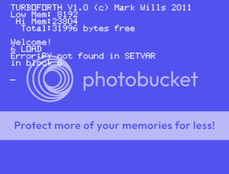

Willsy Posted October 18, 2011 Share Posted October 18, 2011 Okay, your second issue, using variables. Here's your code: : MAKVAR VARIABLE PX VARIABLE PY ; : SETVAR 10 PY ! 5 PX ! ; : PCSET PY @ PX @ 42 1 HCHAR ; : TEST MAKVAR SETVAR PCSET ; The problem is that the declaration of variables does not go inside a colon definition. They can only go outside of a colon definition, by themselves: VARIABLE PX VARIABLE PY : SETVAR 10 PY ! 5 PX ! ; : PCSET PY @ PX @ 42 1 HCHAR ; : TEST SETVAR PCSET ; Now, it works! SETVAR can be made more flexible by removing the constants, and simply taking data from the stack. So, if you change SETVAR to : SETVAR ( row column -- ) PX ! PY ! ; Note the stack comment which tells the reader what SETVAR expects on the stack before it is called, and shows that these two values are 'consumed' after the word is finished. Now, we can enter rows and columns on the command line, and call TEST, like this: Et voila! Note: TF also has VALUES - these work like variables, but: They take an initial value when created They return their value when referenced, not their address They are written to with TO not ! They are read by just giving their name Example: 99 VALUE TI TI . 99 ok:0 100 TO TI TI . 100 ok:0 25 +TO TI TI . 125 ok:0 I personally find them nicer to use, because you don't get the 'noise' of @ and ! in your source code: 0 VALUE PX 0 VALUE PY : SETVAL 10 TO PY 5 TO PX ; : PCSET PY PX 42 1 HCHAR ; : TEST SETVAL PCSET ; Note also that VALUEs are initialised outside of colon definitions. They also need an initial value. Also, you have CONSTANTs - they work exactly the same as VALUEs but you can't change their value once created (actually, that's not true, but we'll cover that another time!) 0 VALUE PX 0 VALUE PY 42 CONSTANT STAR : SETVAL 10 TO PY 5 TO PX ; : PCSET PY PX STAR 1 HCHAR ; : TEST SETVAL PCSET ; Quote Link to comment Share on other sites More sharing options...
Willsy Posted October 18, 2011 Share Posted October 18, 2011 I noticed that figFORTH (specifically TI Forth) utilizes a number on the stack when initializing a variable... (n -- ) but there's nothing about that in your glossary. Since there was nothing about that in Starting FORTH by Brodie, I assumed TF got around that. FIG Forth takes an initial value for variables, but TF, which follows the Forth-83 standard, does not - it initialises its variables to 0. Quote Link to comment Share on other sites More sharing options...
Willsy Posted October 18, 2011 Share Posted October 18, 2011 Regarding your last program, it was crashing due to stack underflow. You were consuming more stack items than you had on the stack. Remember that = consumes two arguments, so you need to DUP the output of KEY for each test in case the result of the test is false, then you still have the ascii code on the stack for the next test. Obviously, you don't need to do it for the last test. I've re-written your program the way I would do it. I've used constants for the key codes. They do consume memory, but there's no measurable performance penalty in using them. The slowest thing here by far is the actual scanning of the keyboard, which is done via the console ROM. CHAR E CONSTANT KEY_E CHAR X CONSTANT KEY_X CHAR S CONSTANT KEY_S CHAR D CONSTANT KEY_D : SETVAR 10 5 ; : TEST SETVAR BEGIN PAGE 0 0 GOTOXY .S 2DUP 42 1 HCHAR KEY DUP KEY_E = IF DROP SWAP 1- SWAP ELSE DUP KEY_S = IF DROP 1- ELSE DUP KEY_D = IF DROP 1+ ELSE KEY_X = IF SWAP 1+ SWAP THEN THEN THEN THEN AGAIN ; Hopefully you'll find the above nice and clear. Almost self-describing. A better version might be this, which doesn't rely on PAGE to clear the screen each time: : ERASE 2DUP 32 1 HCHAR ; : TEST SETVAR PAGE BEGIN 0 0 GOTOXY .S 2DUP 42 1 HCHAR KEY DUP KEY_E = IF DROP ERASE SWAP 1- SWAP ELSE DUP KEY_S = IF DROP ERASE 1- ELSE DUP KEY_D = IF DROP ERASE 1+ ELSE KEY_X = IF SWAP ERASE 1+ SWAP THEN THEN THEN THEN AGAIN ; Now we can use KEY? instead, which doesn't wait for a key: CHAR E CONSTANT KEY_E CHAR X CONSTANT KEY_X CHAR S CONSTANT KEY_S CHAR D CONSTANT KEY_D : SETVAR 10 5 ; : ERASE 2DUP 32 1 HCHAR ; : TEST SETVAR BEGIN 0 0 GOTOXY .S 2DUP 42 1 HCHAR KEY? DUP -1 <> IF DUP KEY_E = IF DROP ERASE SWAP 1- SWAP ELSE DUP KEY_S = IF DROP ERASE 1- ELSE DUP KEY_D = IF DROP ERASE 1+ ELSE KEY_X = IF SWAP ERASE 1+ SWAP THEN THEN THEN THEN ELSE DROP THEN AGAIN ; You might find it's a bit fast, and you'll also find you can fall off the top/bottom of the screen. We need to constrain the row and columns to the screen boundaries: CHAR E CONSTANT KEY_E CHAR X CONSTANT KEY_X CHAR S CONSTANT KEY_S CHAR D CONSTANT KEY_D : SETVAR 10 5 ; : ERASE 2DUP 32 1 HCHAR ; : CLIP-ROW 24 MOD ; : CLIP-COL XMAX MOD ; : TEST SETVAR PAGE BEGIN 2DUP 42 1 HCHAR KEY? DUP -1 <> IF DUP KEY_E = IF DROP ERASE SWAP 1- CLIP-ROW SWAP ELSE DUP KEY_S = IF DROP ERASE 1- CLIP-COL ELSE DUP KEY_D = IF DROP ERASE 1+ CLIP-COL ELSE KEY_X = IF ERASE SWAP 1+ CLIP-ROW SWAP THEN THEN THEN THEN ELSE DROP THEN AGAIN ; There you go. Quite easy to understand. Admittedly not as intuitive as XB, but it's not too bad. Also, it fits on a single block, and occupies 294 bytes. It would be less if it didn't use constants. However, I think constants make the code MUCH easier to read, and, if you want to change something, you only have to change your code in one place - the constant itself. I use them for character codes, colours, everything! E.g. 15 CONSTANT WHITE 42 CONSTANT FACE 20 VALUE ROW 40 VALUE COL 0 CONSTANT SPRITE#0 : AS-SPRITE 256 + DCHAR ; : FACE_DATA DATA 4 $7E81 $A581 $A599 $817E ; : TEST 1 GMODE FACE_DATA FACE AS-SPRITE SPRITE#0 ROW COL FACE WHITE SPRITE ; By the way, if you are using Firefox, you can just paste the above straight into Classic99, no need to use the editor! Enjoy. May the Forth be with you! Quote Link to comment Share on other sites More sharing options...
Opry99er Posted October 19, 2011 Share Posted October 19, 2011 Figured out last night that the VARIABLE PX VARIABLE PY has to be INSIDE a block but OUTSIDE a colon definition. I don't know why I didn't try that yesterday... Just kind of came to me this morning. =) Still having some issues however... I'm alot closer Block:006 0*VARIABLE PX VARIABLE PY 1*10 PX ! 5 PY ! 2*: GETVAR PY@ PX @ ; 3* 4*: TEST 5* BEGIN GETVAR 6* 2DUP PAGE 42 1 HCHAR 7* KEY 68 - 8* DUP 0 = IF DROP 1 + PX ! ELSE 9* DUP 1 = IF DROP SWAP 1 - PY ! ELSE 10* DUP 15 = IF DROP 1 - PX ! ELSE 11* DUP 20 = IF DROP SWAP 1 + PY ! ELSE 12* DROP 13* THEN THEN THEN THEN 14* AGAIN 15*; This is as close as I've gotten so far. It works the first several movements of the "*", but then freezes and an unending error tone fills the speakers. I'm thinking the stack might be going out of whack on me and I have no immediate way of telling... I tried to add a BREAK? in there to be able to bounce out and check the stack contents, but once the screen freezes up, I cannot even use BREAK? to get out. Also, it places the cursor at the top of the screen each time I move... I assume this is a product of "KEY"... I do not wish the cursor to appear each time the keyboard is waiting for input. Right now, I don't have internet access at home, so I am doing all my work on my laptop (I'm writing this message on my laptop) then I'm transferring pictures, text and videos to my thumbdrive and taking them to work to my work computer to post here. I don't have regular access to that computer either, so it's kind of touch and go. I have no idea whether you've answered my previous questions or not as I write this message. Anyway, I'm moving in the right direction I believe... Soon it'll be moving more quickly but the toughest thing is learning to think in Forth terms. Once you get used to the format and design of the language, the cloud kind of lifts. =) Thanks again, Mark. This is becoming a very nice journey. Quote Link to comment Share on other sites More sharing options...

Willsy Posted October 19, 2011 Share Posted October 19, 2011 Block:006 0*VARIABLE PX VARIABLE PY 1*10 PX ! 5 PY ! 2*: GETVAR PY@ PX @ ; 3* 4*: TEST 5* BEGIN GETVAR 6* 2DUP PAGE 42 1 HCHAR 7* KEY 68 - 8* DUP 0 = IF DROP 1 + PX ! ELSE 9* DUP 1 = IF DROP SWAP 1 - PY ! ELSE 10* DUP 15 = IF DROP 1 - PX ! ELSE 11* DUP 20 = IF DROP SWAP 1 + PY ! ELSE 12* DROP 13* THEN THEN THEN THEN 14* AGAIN 15*; I think you have your thinking a bit mixed up in this version. I haven't tried your code. Just 'speed read' it, but it seems like you have two different ideas kind of mixed up. You are placing the row and column on the stack with 2DUP and then you store the values back in the variables. However, if you're using the stack to carry your row and column, there's no need for variables in this particular example. I'm fairly sure you are overflowing the stack (the stack has room for ~20 values) I would advocate a simpler, one or the other approach. Using just variables, it becomes just like any other programming language: You read a variable, you modify, and you write it back again. E.g. in BASIC: CALL KEY(0,K,S) IF K=68 THEN X=X+1 In Forth: KEY 68 = IF X @ 1+ X !THEN Or: KEY 68 = IF 1 X +! There's a slight difference, in that in BASIC, your key code is in a variable, and in the Forth examples above, the key code is on the stack, meaning that if you want to test the key code more than once then you need to DUP ("dupe") it so that it's still on the stack for subsequent tests. I can see from your code that you do understand this concept, however. However, if you wanted, you could simply put the key-code in a variable as well, and the Forth code suddenly becomes very BASIC like (and un-Forth like at the same time!) VARIABLE ROW 10 ROW ! VARIABLE COL 10 COL ! VARIABLE KEYCODE : TEST BEGIN ROW @ COL @ 42 1 HCHAR KEY? KEYCODE ! KEYCODE @ -1 <> IF ROW @ COL @ 32 1 HCHAR KEYCODE @ 68 = IF 1 COL +! THEN KEYCODE @ 83 = IF 1 COL -! THEN KEYCODE @ 69 = IF 1 ROW -! THEN KEYCODE @ 88 = IF 1 ROW +! THEN KEYCODE @ 32 = IF EXIT THEN ROW @ 24 MOD ROW ! COL @ XMAX MOD COL ! THEN AGAIN ; This is written in the style of a BASIC program. It works, and it's very fast (too fast, in fact). However, we can make it faster, and smaller (the above code is 248 bytes) by using the stack: VARIABLE ROW 10 ROW ! VARIABLE COL 10 COL ! : TEST BEGIN ROW @ COL @ 42 1 HCHAR KEY? DUP -1 <> IF ROW @ COL @ 32 1 HCHAR DUP 68 = IF DROP 1 COL +! ELSE DUP 83 = IF DROP 1 COL -! ELSE DUP 69 = IF DROP 1 ROW -! ELSE DUP 88 = IF DROP 1 ROW +! ELSE 32 = IF EXIT THEN THEN THEN THEN THEN ROW @ 24 MOD ROW ! COL @ XMAX MOD COL ! ELSE DROP THEN AGAIN ; Here, the keycode variable has been eliminated, the keycode is 'carried' on the stack. The reason it is faster is because a those DUPs and DROPs are much simpler machine code routines than the variable fetch routines. It's slightly smaller, at 242 bytes. Of course, it is possible to code the above with no variables at all - the 'pure' Forth way: : TEST 10 10 \ row and column BEGIN 2DUP 42 1 HCHAR KEY? DUP -1 <> IF -ROT 2DUP 32 1 HCHAR ROT DUP 68 = IF DROP 1+ ELSE DUP 83 = IF DROP 1- ELSE DUP 69 = IF DROP SWAP 1- SWAP ELSE DUP 88 = IF DROP SWAP 1+ SWAP ELSE 32 = IF 2DROP EXIT THEN THEN THEN THEN THEN XMAX MOD SWAP 24 MOD SWAP ELSE DROP THEN AGAIN ; This is, not to put too fine a point on it, is f***ing fast! The 'slow' part is the actual scanning of the keyboard. It's also far smaller, at 188 bytes. We keep the row and column on the stack with the 2DUP just after the BEGIN. Stack: row column Then we scan the keyboard, and DUP the keycode returned: Stack: row column keycode keycode Then we check to see if the keycode was -1 (no key pressed). The <> test consumes the top keycode (that's why we DUPd it). Stack: row column keycode If NO key was pressed, we enter the ELSE clause at the end of the code, and drop the keycode: Stack: row column And then we loop 'round again. If a key was pressed, then our stack looks like this: row column keycode We need to remove the star from the screen (by replacing it with a space). We need to get to the row and column on the stack, but the keycode is in the way. So, we use -ROT which rotates the top 3 stack items to the right. The items that WAS on the top now becomes the 3rd stack item: Stack: keycode row column Hey presto. We can get to the row and column. We now DUP the row and column, because HCHAR would consume them otherwise: Stack: keycode row column row column We now execute HCHAR to write a space. Stack: keycode row column Now we use ROT to move the top three items the other way: Stack: row column keycode Now we DUP the keycode, because we are going to perform a test on it, and the = word will consume it: Stack: row column keycode keycode We compare it to 68: Stack: row column keycode If it IS 68, we drop the keycode: Stack: row column And add 1 to the column with 1+ Stack: row column+1 This is repeated for the other keys. We don't need to DUP the keycode for the last test (our exit condition - the space bar) because we want it off the stack for the next time 'round, so we let = get rid of it for us. Then we just limit the row and column with MOD. We're done. Very fast, very Forthy, and very cool. Not intuitive though. There's no doubt, its harder than Basic. It's more like machine code. You have to follow the stack contents in your head, much like you would registers and condition bits in machine code. It's the code equivalent of Suduko. But it gets easier. For what it's worth: The code I wrote above didn't work first time, and I had to have a couple of hacks at it! I write my code in Notepad++ and just paste it into the command line of TF to test it. When it works, I save it in blocks! Hope this helps. Mark Quote Link to comment Share on other sites More sharing options...
