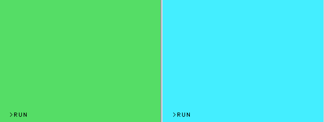

senior_falcon Posted April 14, 2021 Author Share Posted April 14, 2021 I transferred the files for the demo program to my real TI99. The screen produced is the same as the screen produced by Win994a. Since it works fine in Classic99, it seems that the real TI99 and Win994a are less forgiving of something I have done in the code. Win994a does not have a debugger, but I should be able to work out some short test programs in Classic99, transfer them to Win994a, and try to find out where the program is going off the rails. Stay tuned.... 1 Quote Link to comment Share on other sites More sharing options...
senior_falcon Posted April 14, 2021 Author Share Posted April 14, 2021 Using the Classic99 debugger, setting VR0 to 0 I makes the screen in Classic99 match the screen in Win994a. So it appears that VDP register 0 is somehow either not being set to 2 for bit mapped or else it is being reset from 2 back to 0 at some point early in the program. Why it behaves in Classic99 and misbehaves in real iron and Win994a is still a mystery... Quote Link to comment Share on other sites More sharing options...
Asmusr Posted April 14, 2021 Share Posted April 14, 2021 It doesn't work in JS99er either. The log says "Write >04 to F18A register 8 (>08) without unlocking." (which ends up affecting VR0) if that's any help. Quote Link to comment Share on other sites More sharing options...
senior_falcon Posted April 14, 2021 Author Share Posted April 14, 2021 7 hours ago, Asmusr said: It doesn't work in JS99er either. The log says "Write >04 to F18A register 8 (>08) without unlocking." (which ends up affecting VR0) if that's any help. That's a big help! My sub to change the registers to the bit mapped registers had the condition for exiting the loop in the wrong place! It was trying to change VR8. Evidently Classic99 ignores this, but the real TI sets VR0 to zero. Win994a and JS99er duplicate this behavior. 2 Quote Link to comment Share on other sites More sharing options...
Tursi Posted April 15, 2021 Share Posted April 15, 2021 I don't see the description of the original problem, but yes, that seems likely! That is part of the compatibility code to allow 80 column mode without unlocking... it would be interesting to know if the problem also happens on F18A, but it's more likely Classic99 specific. That'll clean up a bit when I split the chips up. Quote Link to comment Share on other sites More sharing options...
