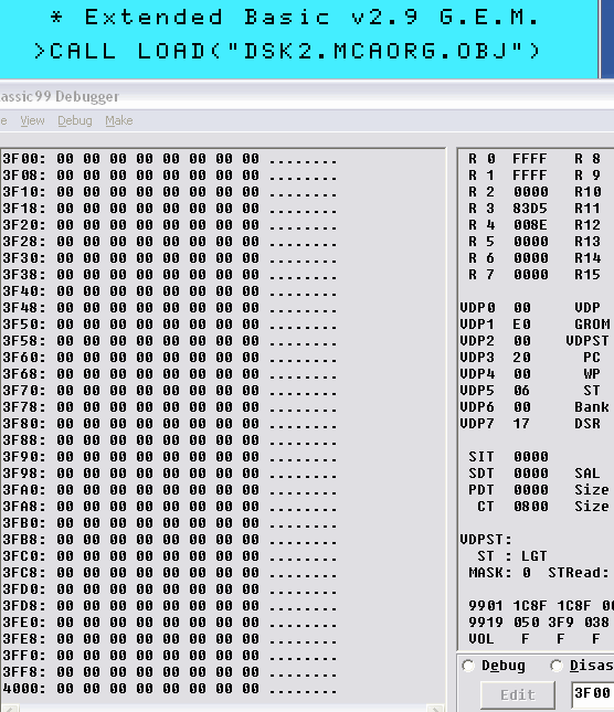

BTW, I don't see a reason for the AORG in the source code. If you remove it, XB will load the routines to >24F4 instead of forcing it to load to >2600 which would give you 268 more bytes of low memory if that was ever needed.

Regarding AORG, I had the CALL LOAD in my XB program. With AORG it is overwritten on each new load, without AORG you run out of memory when the loader tries to load it above the first load. So AORG was very usefull during development of the library. Perhaps this is not true if you develop a program using the stable library later on, as none of my programs have a CALL LOAD for XB256 either.

It should be this way, without the AORG:
10 CALL INIT::CALL LOAD("DSK2.MCOLOR.OBJ")
The INIT resets low memory so you can load it again.
What happens if you use the AORG and load repeatedly is that the code is loaded to the same place (>2600) but the DEF table keeps getting updated and you can run into problems with that.
