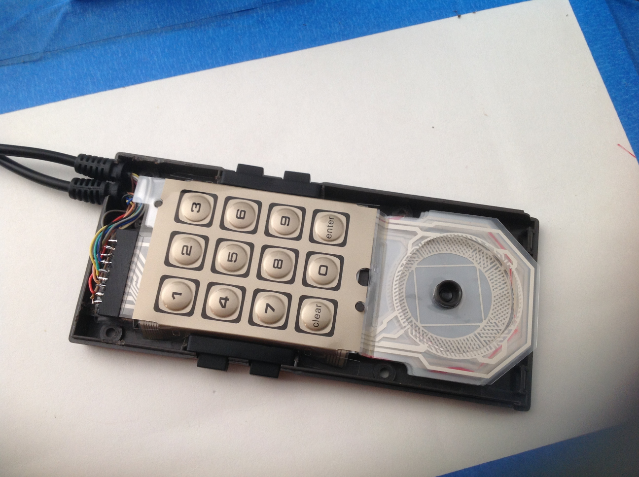

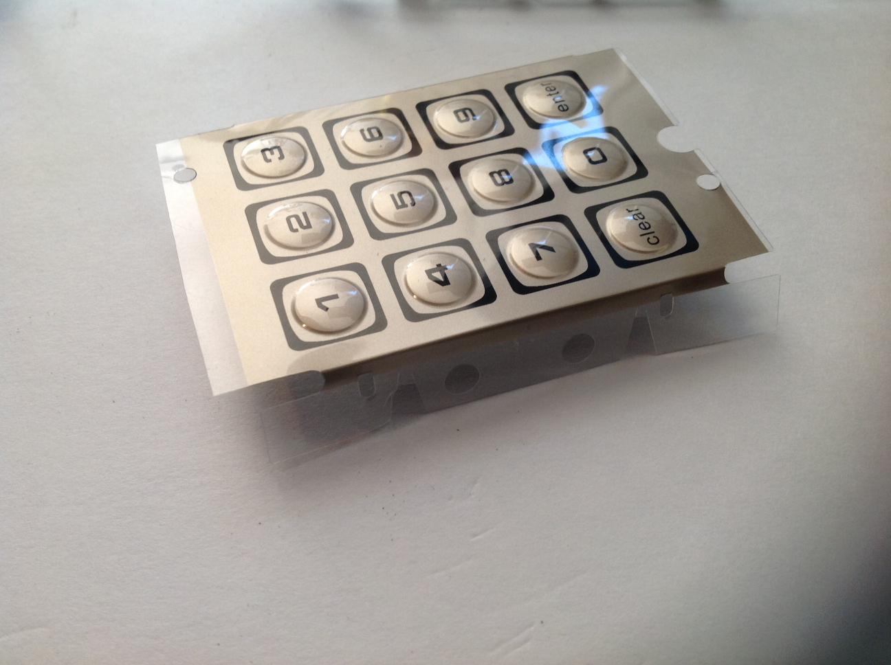

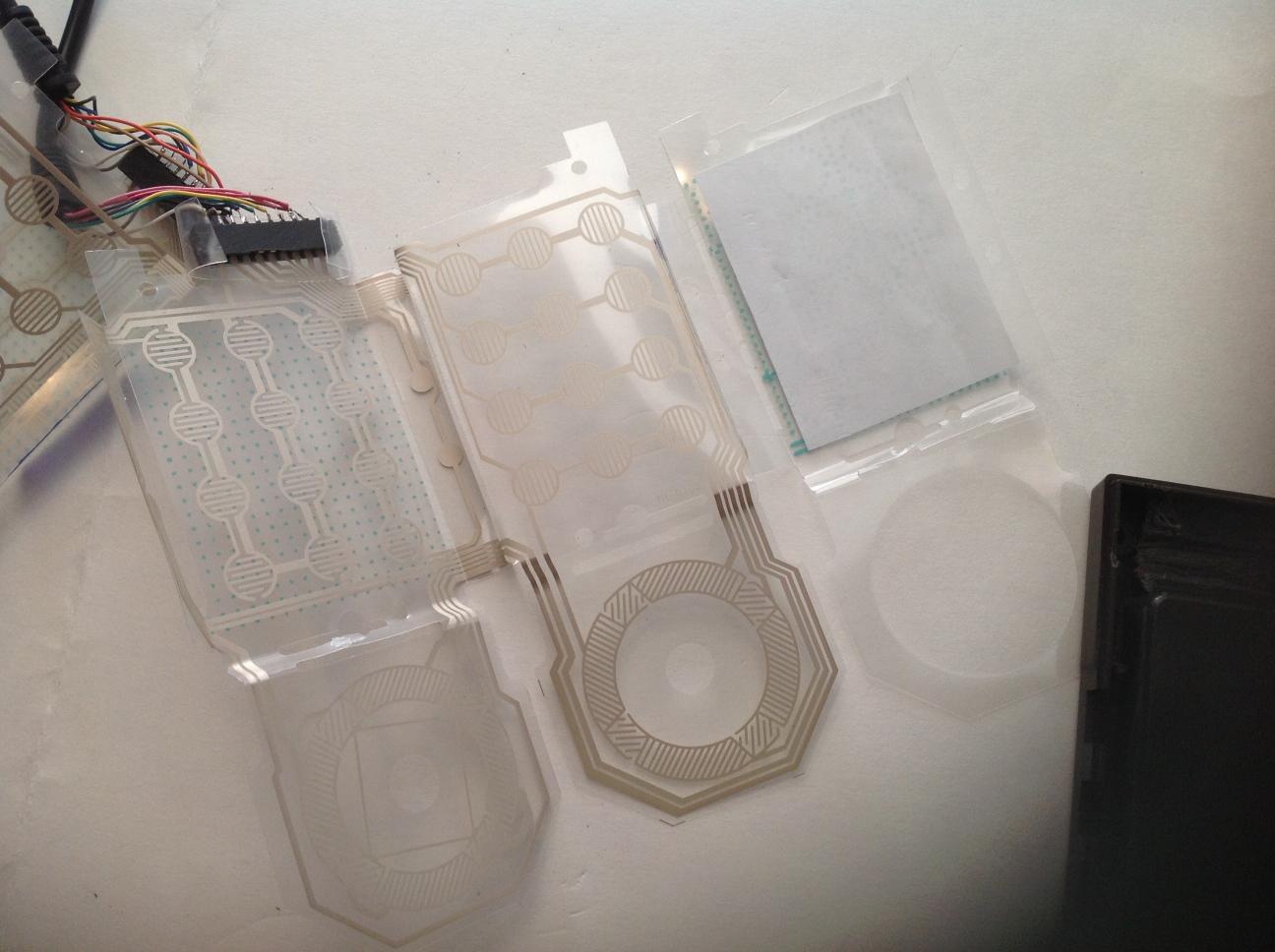

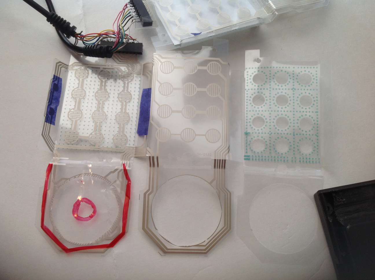

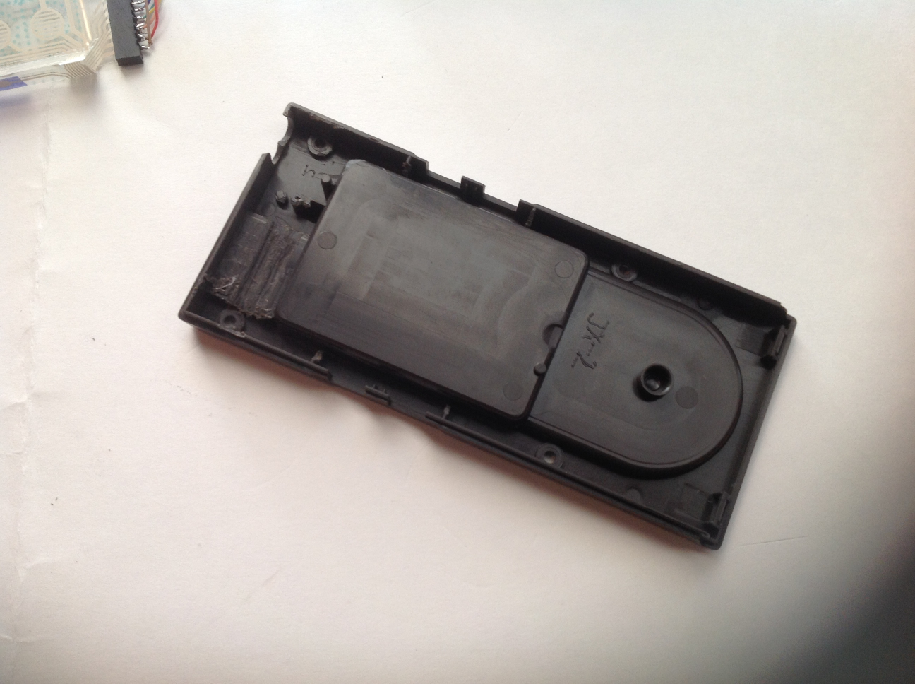

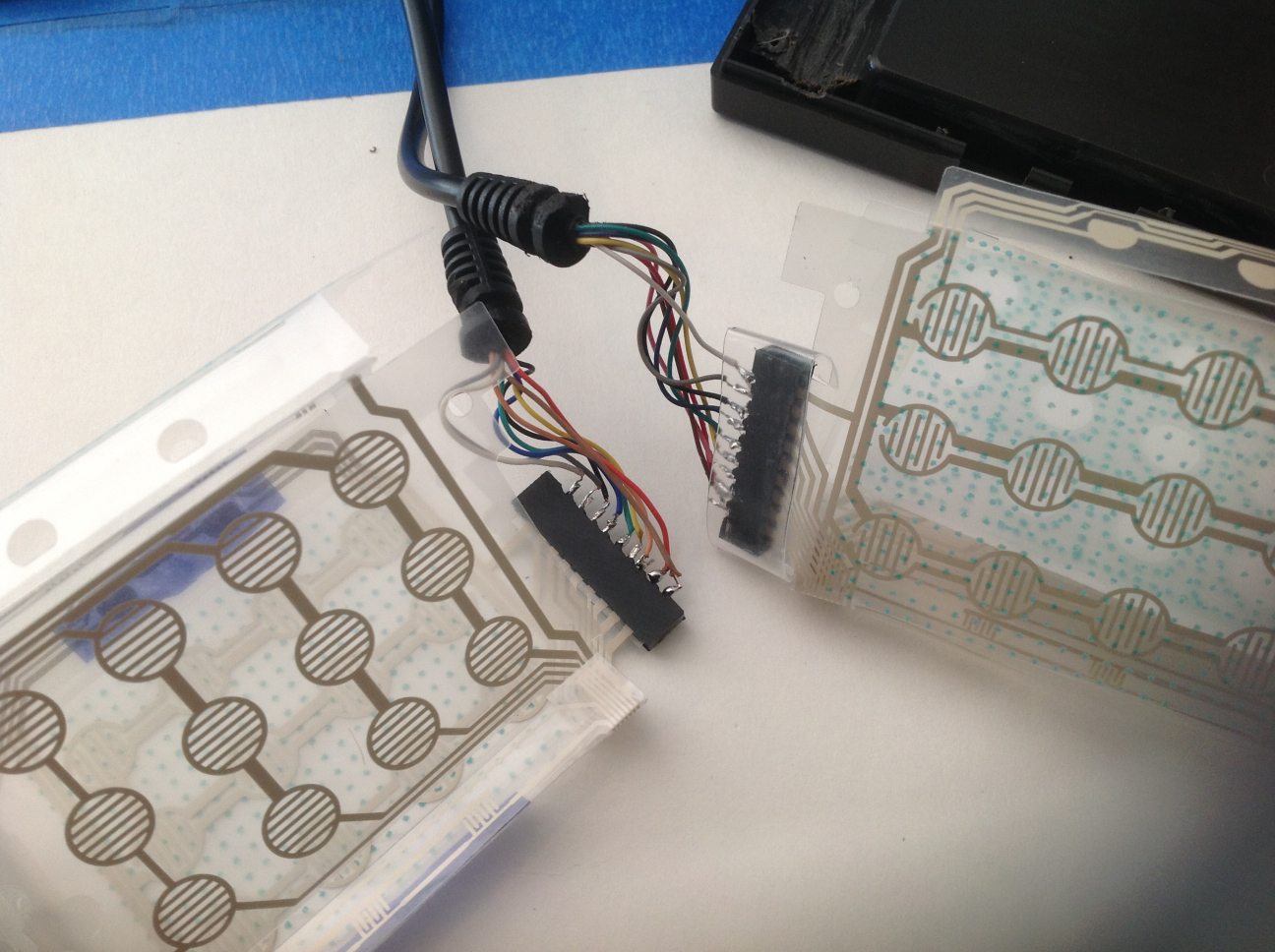

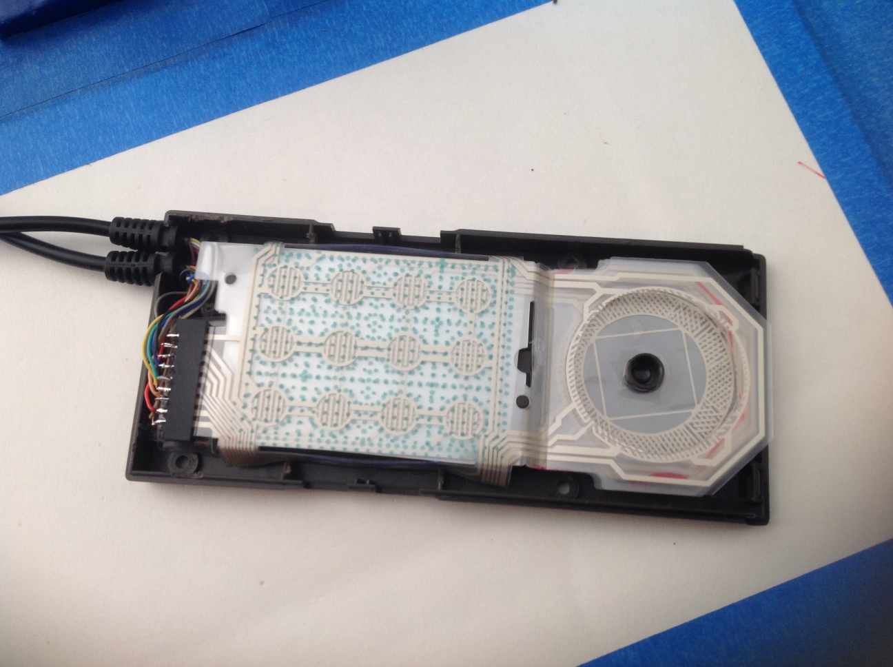

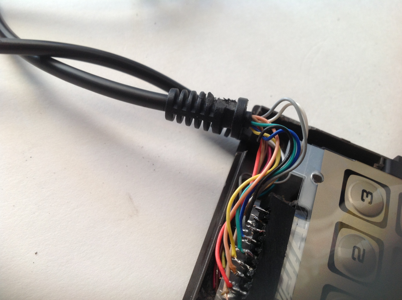

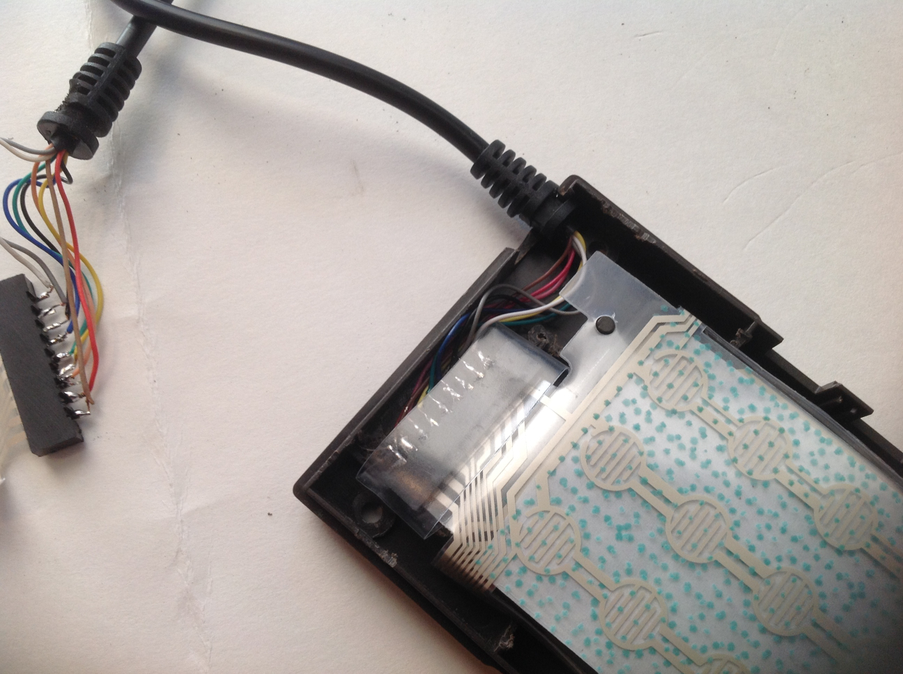

+nurmix Posted August 24, 2015 Author Share Posted August 24, 2015 Detailed pictures of the internals. Some things to note for those wanting to do this - in no particular order... There is "un-shrunk" heat shrink tubing between the two matrix wire connections to prevent shorts. I thought about putting heat shrink on all 18 wire connections, but this would limit flexibility, and isn't really necessary as long as the pins are straight, and there is something non-conductive between the two connector layers. The lower controller housing was roughly filed out to make more room where the wires and connectors sit, and the screw hole posts where the Flashback controller daughter board would screw into have been mostly removed, as they aren't needed. The underside of the top controller housing was filed a bit too, to make more room, but isn't shown in the pictures. The lower controller housing is also filed down a little along the (internal) sides where the matrices fit in the side-button area to make room for both matrices. The side button traces are masked off with thin painters tape on the KEYPAD matrix. I didn't find the need to cut portions out there as the side button performance was fine - even with both matrices layered. The lower disc/side button matrix has it's keypad masked off with thin paper. You can see the thin 'freezer bag' plastic I put between the cut disc area of the KEYPAD matrix (red outline to make it more visible in the photo) just to make sure no accidental connections happen there - even with the cut-out areas. And the numeric keypad 'top' also has some additional upside down "V" notches cut into it to better fit in the lower controller housing. The controller wires are soldered to the pins of the matrix connectors. The plastic housing of these two connectors have also been filed down slightly, again, to make things fit. Obviously you have to desolder these connectors from the daughter boards first. I made another hole for the second controller cable to exit the lower housing, and filed down one side of each of the wire 'stress relief' boots so the two cables would sit side by side evenly. I think that pretty much sums it up. The controller works just as well as you would expect a standard Flashback controller to work, and other than the second cable coming out of the housing, you can't tell the difference visually between the two. If anyone is interested in having me make one of these for you, let me know. I haven't decided on a price yet (it's A LOT of work), but if people actually want them, I'll come up with something. 6 Quote Link to comment Share on other sites More sharing options...

+nurmix Posted August 24, 2015 Author Share Posted August 24, 2015 This seems like a fairly painstaking process, Nurmix. I know you do this stuff "for the love of the game", but if there is any kind of wish list of your to make this easier, what would it be? Is there a way to buy some of the parts pre-cut or something so you wouldn't have to do all if the work yourself, post-prototyping? None of the work is difficult, just time consuming. Sure, it would be nice if the matrix connectors didn't have to be desoldered from the daughter boards. And cutting the matrices is a bit tedious. But really, there's not much I could do to speed up the process, other than prepping/filing extra controller housings in advance or something, if I were to start making these for people.. That's just the nature of doing things like this. The fun is in figuring it out and making it work. Quote Link to comment Share on other sites More sharing options...
+Rick Reynolds Posted August 24, 2015 Share Posted August 24, 2015 This seems like a fairly painstaking process, Nurmix. I know you do this stuff "for the love of the game", but if there is any kind of wish list of your to make this easier, what would it be? Is there a way to buy some of the parts pre-cut or something so you wouldn't have to do all if the work yourself, post-prototyping? None of the work is difficult, just time consuming. I think if we're talking about new production stuff, it would be very cool to have a different mylar matrix created - one that completely separates the two sets of tracings to two different edge connection areas. I don't know what goes into making those. Quote Link to comment Share on other sites More sharing options...
+nurmix Posted August 24, 2015 Author Share Posted August 24, 2015 I think if we're talking about new production stuff, it would be very cool to have a different mylar matrix created - one that completely separates the two sets of tracings to two different edge connection areas. I don't know what goes into making those. No idea what it would cost or how to go about making a custom matrix. That issue aside, I think it could be 'boiled down' to a single matrix of 4 sections (maybe 5 with a clear / masking layer) and folded over itself in a similar way to the existing one. It would have two ends to connect the 18 wires. Of course if we're going to go that far, custom controller housings with large recessed areas already cut out for the wire area would be sweet. But given the small market, I don't think any of this is feasible from a cost perspective. Quote Link to comment Share on other sites More sharing options...

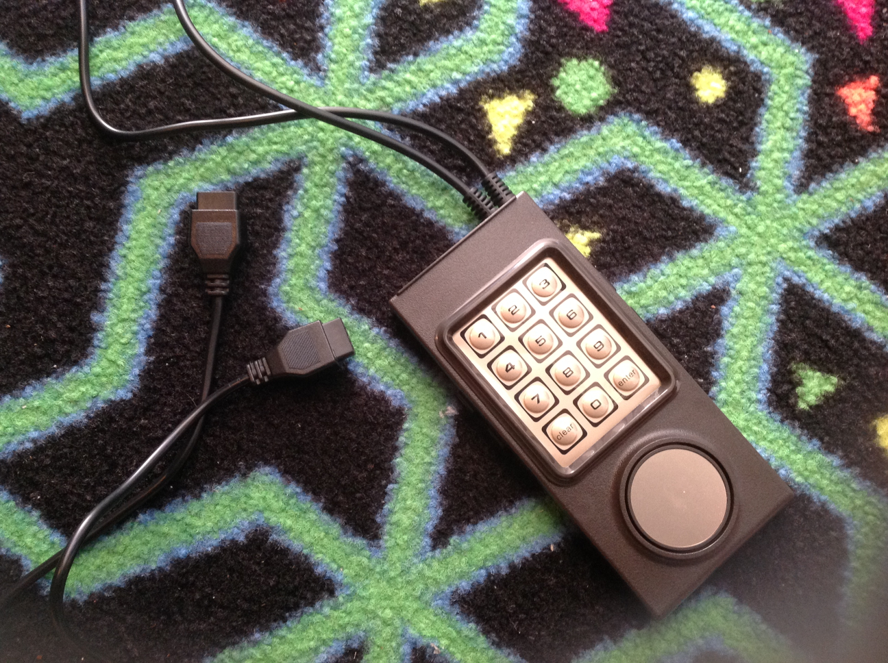

+nurmix Posted August 24, 2015 Author Share Posted August 24, 2015 Oops! I forgot the "beauty shot" (just a cheap excuse to show my arcade carpeting, really)... 5 Quote Link to comment Share on other sites More sharing options...
