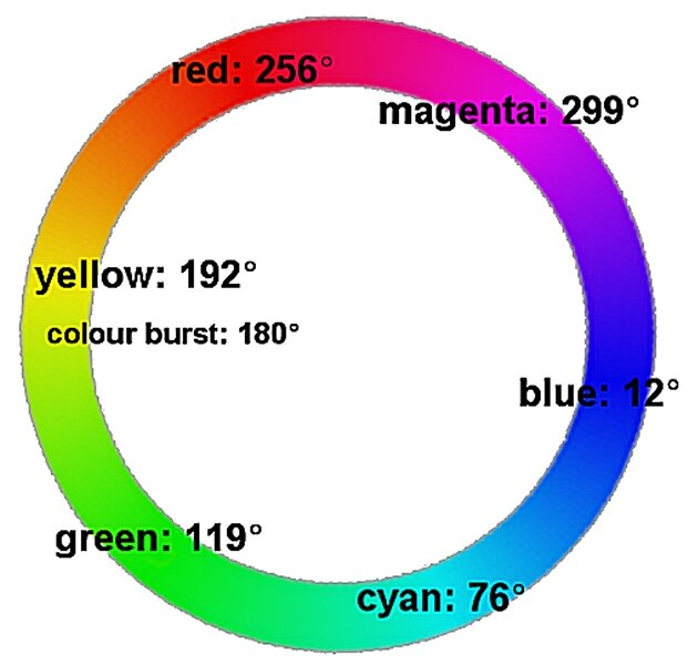

Bryan Posted December 19, 2015 Author Share Posted December 19, 2015 Well, after messing with this some more, it looks like the artifacting range is going to be from the XL's purple/green to the XE's red/blue. I really wanted to support the exact green/blue of the 800 but it isn't possible without a lot more complexity. Here's the situation: The NTSC color wheel: To get the 65/130XE colors, draw a line through the middle from red to cyan. To get the 800XL and XEGS colors, spin the line clockwise to magenta and green (about 40ns difference). Now look at the 800 colors- blue and green. You can't get there with a line through the middle. They're only about 130° apart and seem to be the result of some unique distortion in the 800's video or clocking circuits.** There is nothing I can do on my board to get them right and I don't think it's worth making a bigger, costlier, and more complicated board. See this post for more info: http://atariage.com/forums/topic/204355-artifacting-isnt-it-weird/?p=2624664 Currently, I can produce the colors from every machine in that list other than the 800, and I can swap the colors as is required for the 1200XL and 600XL (and to emulate using a CTIA). Opinions? **The 800's color alignment is actually very close to the 800XL's purple/green (but inverted) as both machines have very fast color buffers. I don't yet know exactly why odd bit patterns end up skewed. My gut suspicion is that the system clock is not very close to 50/50 duty cycle and even and even/odd pixels end up being different sizes. 2 Quote Link to comment Share on other sites More sharing options...
+mytek Posted December 19, 2015 Share Posted December 19, 2015 I just want something that'll produce clean video out of my Atari. Emulating different artifacting to match different models is not very high on my list, although it could be to others. Since you have already made it possible to match up with everything other than the classic 800, making it bigger and costlier just to do this really doesn't seem like the right priority. - Michael 3 Quote Link to comment Share on other sites More sharing options...
