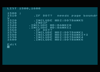

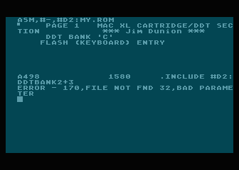

sanny Posted September 13, 2016 Share Posted September 13, 2016 I'm trying to compile mac-xl-1.atr/mac-xl-2.atr with MAC/65 1.1 and I'm getting this: what should DDTBANK2+3 be? it's not a valid filename Btw., how do I insert images directly into a post? Quote Link to comment https://forums.atariage.com/topic/257025-oss-d-day-part-2-mac65-102-cartsource-now-in-pd/#findComment-3593494 Share on other sites More sharing options...

1050 Posted September 13, 2016 Share Posted September 13, 2016 My guess would be to find DDTBANK3 and if exist then Make a new line 1585 .INCLUDE #D2:DDTBANK3 then trim +3 from line 1580 try again? Just how this all came about is of course the question without a real answer. Life is like a box of chocolates, you never know what you are going to get. Not sure at all why you would ask about posting photos into a post after I see two photos in your post. If it's a remote site, you can just paste the url and Albert's fine posting machine will produce a clickable link out of it. Orange More Reply Options button takes you to page that has Attach Files footer on the reply box and it works on local to you photo files. Once uploaded from your computer a link will show up that pastes the photo to where you left the cursor in your message. Quote Link to comment https://forums.atariage.com/topic/257025-oss-d-day-part-2-mac65-102-cartsource-now-in-pd/#findComment-3593615 Share on other sites More sharing options...
sanny Posted September 14, 2016 Share Posted September 14, 2016 My guess would be to find DDTBANK3 and if exist then Make a new line 1585 .INCLUDE #D2:DDTBANK3 then trim +3 from line 1580 try again? There is no DDTBANK3 file. Just how this all came about is of course the question without a real answer.Life is like a box of chocolates, you never know what you are going to get. Seems like the "+3" was intended as a comment. And the space before it somehow got lost. If I comment the "+3" I get a similar result like the OP: Not sure at all why you would ask about posting photos into a post after Isee two photos in your post. If it's a remote site, you can just paste the url and Albert's fine posting machine will produce a clickable link out of it. Orange More Reply Options button takes you to page that has Attach Files footer on the reply box and it works on local to you photo files. Once uploaded from your computer a link will show up that pastes the photo to where you left the cursor in your message. Yes, I've noticed that, too, after writing the post. But I had to copy the pictures to a web server and then add the link to the picture to the post. This was a bit cumbersome. I now tried your suggestion, seems to work. Thanks! Quote Link to comment https://forums.atariage.com/topic/257025-oss-d-day-part-2-mac65-102-cartsource-now-in-pd/#findComment-3593970 Share on other sites More sharing options...
sanny Posted September 14, 2016 Share Posted September 14, 2016 I got it to compile with the following change to MASTER: --- MASTER 2016-09-14 12:54:31.656143139 +0200 +++ M2 2016-09-14 12:54:37.759181364 +0200 @@ -52,7 +52,7 @@ .SET 5,16 comment padding .PAGE "ASSEMBLY MACROS" .MACRO @ -:BR0 .= *+%1 +;:BR0 .= *+%1 .ENDM ; .MACRO BANK @@ -155,7 +155,7 @@ .INCLUDE #D:BANKC1 .IF DDT? .INCLUDE #D2:DDTBANK1 - .INCLUDE #D2:DDTBANK2+3 + .INCLUDE #D2:DDTBANK2 +3 .INCLUDE #D2:DDTBANK4 .INCLUDE #D2:DDTBANK6 .INCLUDE #D2:DDTBANK7 I have only found four occurrences of the "@" macro, all in the MASTER file. So, instead of commenting the body of the macro, "@" could be removed completely (definition and usages). The macro as written is supposed to advance the location counter by <argument>. But: no usage of the macro has a parameter (therefore the compile errors) the location counter is set to some value anyway directly after the macro invocation I'm wondering where this "@" macro is coming from and why it is there. I've compiled with (RAM=0,EPROM=1) and (RAM=1,EPROM=0). Both of them worked and give different output files. I'm wondering what the "RAM cart" is, mentioned in the comment of RAM. So, now I have output files in Atari EXE format with many load segments (like MAC/65 does). How do I convert them to a ROM image? I've tried the MOVE.COM and FILLFF.COM programs on D2:, but they just flash a message on the first line of the screen (too fast to read). regards, chris Quote Link to comment https://forums.atariage.com/topic/257025-oss-d-day-part-2-mac65-102-cartsource-now-in-pd/#findComment-3594011 Share on other sites More sharing options...
1050 Posted September 14, 2016 Share Posted September 14, 2016 There is no DDTBANK3 file. Seems like the "+3" was intended as a comment. And the space before it somehow got lost. If I comment the "+3" I get a similar result like the OP: Ok, not the end of the world if DDTBANK3 doesn't exist. For all we know it's been folded over into DDTBANK2 and that is supposed to be a comment just like you propose. I didn't see that one myself at all. You've got a good eye for this kind of work and you've posted just the right photos too. In this source I've noticed that tendency to use a space as a comment delimiter, but in my experience with MAC/65 it's always best to use the semi-colon. There seems to be a bug where the space works in some places and in others it doesn't. But the semi-colon solidly makes it happen every time. If our source code donator missed that memo then a lot of these mistakes can show up. Make it a semi-colon comment and see if the code compiles then. I like more than one or two spaces before the semi-colon too, but that might be a habit I had to adopt back in the days of using disk based MAC/65. One version would not allow a comment of any kind on the same line as a label -- drove me stark raving mad trying to figure out what was wrong that time. Thank you for doing the leg work, I haven't tried just yet. And confusion over posted photos all good now, seems there are several ways to do it and learned something myself too. Quote Link to comment https://forums.atariage.com/topic/257025-oss-d-day-part-2-mac65-102-cartsource-now-in-pd/#findComment-3594012 Share on other sites More sharing options...

Kr0tki Posted September 15, 2016 Share Posted September 15, 2016 (edited) I'm trying to compile mac-xl-1.atr/mac-xl-2.atr with MAC/65 1.1 and I'm getting this: what should DDTBANK2+3 be? it's not a valid filename It depends on the DOS being used. Stephen D. Lawrow used DOS 2.0D for MAC/65 development (it is included in the 1988 sources of MAC/65 v3.6 also available at AtariWiki: mac-xl-master-3.6-1988.atr). Assembling under DOS 2.0D does not raise this error. I have only found four occurrences of the "@" macro, all in the MASTER file. So, instead of commenting the body of the macro, "@" could be removed completely (definition and usages). The macro as written is supposed to advance the location counter by <argument>. But: no usage of the macro has a parameter (therefore the compile errors) the location counter is set to some value anyway directly after the macro invocation I'm wondering where this "@" macro is coming from and why it is there. Sources of BASIC XE 4.2 (also released recently on AtariAge) contain the @ macro as well, but with an additional comment indicating that its purpose is to display memory location at which a cartridge bank ends. Ie. if it passes $AFFF or $BFFF, then we're in trouble, because we're trying to assemble too much code into a bank. The macro functions by raising ERROR 32, which also displays the current assembly address. The error is otherwise harmless - the sources assemble correctly even without modifying the macro like you did. I've compiled with (RAM=0,EPROM=1) and (RAM=1,EPROM=0). Both of them worked and give different output files. I'm wondering what the "RAM cart" is, mentioned in the comment of RAM. While (RAM=0,EPROM=1) results in a binary file that loads its four banks sequentially to $3000-$6fff, (RAM=1,EPROM=0) creates a binary file that loads itself to cartridge area, ie. $a000-$bfff. It also contains segments that switch cartridge banks by writing to $d5xx, inbetween the segments with bank contents. Apparently OSS used a RAM cartridge for development of their products. The cartridge was compatible to their standard ROM cartridge with regards to bank-switching, but contained RAM instead of ROM. The file would load itself into correct banks of the RAM-cartidge, which would result in a functioning MAC/65 cartridge, immediately available for testing. So, now I have output files in Atari EXE format with many load segments (like MAC/65 does). How do I convert them to a ROM image?When assembling the aforementioned MAC/65 v3.6, I just loaded the file to memory, and dumped the contents of $3000-$6fff to file using the memory dump function available in the emulator's debug monitor. Interesting that the build is so mixed up as to wrong order.Not that interesting. An OSS "Supercartridge" contains two 8KB EPROMS, one of them contains banks "0" and "4", and the other contains banks "3" and "M". When creating a ROM image of such a cartridge, one has to dump the two EPROMS and join them to create a 16KB file. When the first OSS cartridges were dumped back in the 90's, someone decided to join the two EPROM images in the "04" + "3M" order, hence the "043M" mapping used by emulators. MAC/65 sources simply assume the reverse order of EPROMs. Edited September 15, 2016 by Kr0tki Quote Link to comment https://forums.atariage.com/topic/257025-oss-d-day-part-2-mac65-102-cartsource-now-in-pd/#findComment-3594477 Share on other sites More sharing options...
