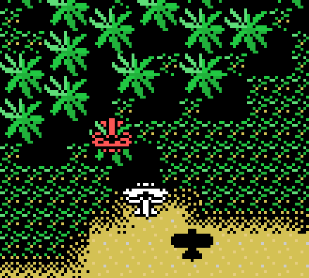

This is looking and playing fantastic, really looking forward to the finished product. I'll have to hack another of my 64k Jon Guidry boards into a 512k though. A bit
of a job but well worth it.
One minor thing I noticed, and it could be my imagination, but it appears the gun sound pitch changes slightly at times?

Awesome opening screen! My comments:
A) enemies: unless you do not have the ZX original data for enemy placement, I would go for a semi random solution at least for planes.
My idea would be:
1) define in rom 4-5 kinds of swarms with their different trajectories for the planes,
2) space the starting positions of the swarms by a fixed amount of vertical scroll distance + a random offset,
3) randomize the choice of swarm types.
This would avoid too much enemy clutter and speed up a lot the development. It could be needed to select a good seed in the random sequence generator by trial and errors, but it is simpler than encoding data levels manually
Ground enemies have to be manually set in order to avoid inconsistencies with the background.
B) improving shadows:
1) the main plane, while exploding should change its shadow accordingly.
2) I do not see any critical situation about the 5th sprite issue, so probably enemies could safely have their own shadows. All swarms at least now have two or 3 planes taking 4 or 6 sprites, but the trajectories are studied to have max 4 sprites per line.
You could put enemy shadows with the same offset used for the main plane, using a sprite plane with lower priority
But feel free to keep your own way, I have no idea of the effort needed and I know how annoying can be these kind of comment while one is coding
Thanks for the suggestions. It does indeed look nice with shadows for the enemy planes.

Fabrice obviously means that is what He thinks it should look like?
Personally I think It would be a nice idea if the shadows could be turned on or off (menu option?), it's a bit of a distraction
on the incoming fighters, but I would say it wouldn't take long till You didn't really notice it.
That's just my 2c. It will a great game whatever decisions are made.

Another thing that could be animated is flame in the craters from the explosions on ground items once hit by the player.
The arcade has some red/yellow points within the black craters. Not sure actually if the size of the craters allows to have red or yellow points at the moment.
Another nice touch could be to have large battleships moving in the middle of the sea.
If you look at the arcade verson, battleships in the middle of the sea are moving up or down, faster than the scrolling.
A couple of missing bits are the large planes moving from the bottom or the upper border of the screen and small motor boats in the sea casting bullets.
