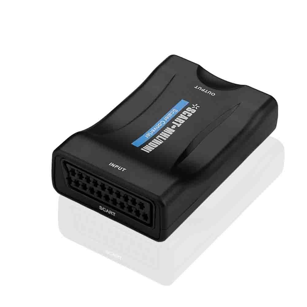

Master Phruby Posted September 11, 2017 Author Share Posted September 11, 2017 For the Jaguar and the Saturn, I was going to SCART with a 3 way scart splitter. Plug that in to SIENOC MHL HDMI To SCART 1080p Video Audio Converter Scaler Smartphone Sky STB DVD https://www.amazon.com/gp/product/B06XNR96XJ/ref=oh_aui_detailpage_o02_s01?ie=UTF8&psc=1 Quote Link to comment Share on other sites More sharing options...
keepdreamin Posted September 11, 2017 Share Posted September 11, 2017 Plug that in to SIENOC MHL HDMI To SCART 1080p Video Audio Converter Scaler Smartphone Sky STB DVD https://www.amazon.com/gp/product/B06XNR96XJ/ref=oh_aui_detailpage_o02_s01?ie=UTF8&psc=1 You speak with anyone who has one of these? Or is this just a blind order? The $50 scaler is a mixed bag, I can't image what one for 16 bucks is like. Quote Link to comment Share on other sites More sharing options...
keepdreamin Posted September 11, 2017 Share Posted September 11, 2017 (edited) oh, ok. This image is from https://www.retrogamingcables.co.uk/SCART-TO-HDMI-CONVERTERS-TO-AVOID !!!!!EDIT again, looking in the description of the amazon link you posted, that's actually for HDMI to Scart, not scart to hdmi. !!!! Edited September 11, 2017 by keepdreamin Quote Link to comment Share on other sites More sharing options...
CatPix Posted September 11, 2017 Share Posted September 11, 2017 For the Jaguar and the Saturn, I was going to SCART with a 3 way scart splitter. Don't use those! I tried a lot of them, and those have direct wiring, meanign that the signal goes into al lthe connected cables, and so you get a loss in signal pwoer. On some systems it's neglectible, on some, you get a considerable drop in contrast and sound. The common ones I see that are decent are those blocks : One advantage you mgiht like is the audio out in RCA form. In addition to have a selector for each plug, ensuring that you don't lose some signal along the way. 1 Quote Link to comment Share on other sites More sharing options...
Master Phruby Posted September 12, 2017 Author Share Posted September 12, 2017 So if those SCART to HDMI converters are garbage, what do you use that isn't hundreds of dollars? That is all I see. I'm not buying some $300 homemade thing that is hard to come by. I'm think $40 is pushing it for a decent picture out of two systems. Quote Link to comment Share on other sites More sharing options...
Bratwurst Posted September 12, 2017 Share Posted September 12, 2017 If you're unwilling to spend the money, perhaps you should consider settling for S-Video because trying to cheap out on SCART to HDMI solutions undermines the whole idea with subpar results. 3 Quote Link to comment Share on other sites More sharing options...
+remowilliams Posted September 12, 2017 Share Posted September 12, 2017 If you're unwilling to spend the money, perhaps you should consider settling for S-Video because trying to cheap out on SCART to HDMI solutions undermines the whole idea with subpar results. This, exactly. It's going to cost a non trivial amount of money - but if you don't have a good SCART>HDMI processor for that last leg of the process, you're better off going s-video. I use an XRGB-mini, and it's worth every penny spent on it. Quote Link to comment Share on other sites More sharing options...
keepdreamin Posted September 12, 2017 Share Posted September 12, 2017 So if those SCART to HDMI converters are garbage, what do you use that isn't hundreds of dollars? That is all I see. I'm not buying some $300 homemade thing that is hard to come by. I'm think $40 is pushing it for a decent picture out of two systems. I'll try this analogy. Buying a ton of scart cables, and switchboxes etc. but hooking them up to a cheap scaler, is like buying race fuel for a Yugo. I use one of these, wasn't made at home, ships now. https://solarisjapan.com/products/xrgb-mini-framemeister-compact-up-scaler-unit Quote Link to comment Share on other sites More sharing options...
Austin Posted September 12, 2017 Share Posted September 12, 2017 So if those SCART to HDMI converters are garbage, what do you use that isn't hundreds of dollars? That is all I see. I'm not buying some $300 homemade thing that is hard to come by. I'm think $40 is pushing it for a decent picture out of two systems. You need to spend the money, otherwise you are going to end up with crap results. It's just how it goes. 1 Quote Link to comment Share on other sites More sharing options...
