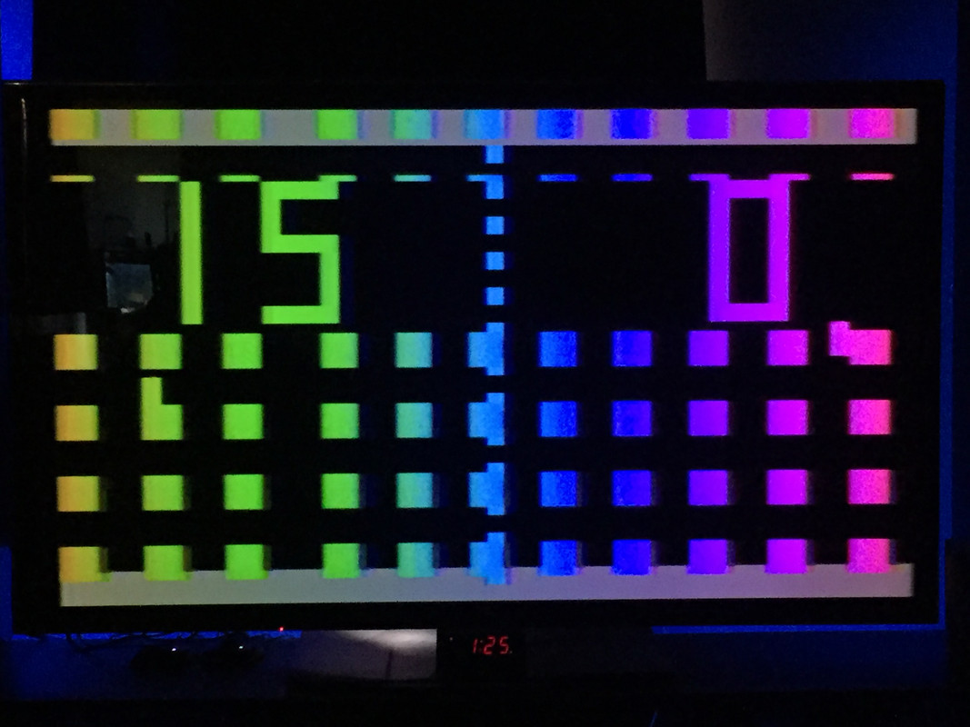

moonchilddave Posted April 23, 2019 Share Posted April 23, 2019 (edited) Just recently picked up this classic. Also bought an Atari Pong Battery Eliminator. Everything seems to be working fine - display, paddles, sound... but when playing it, when one player scores, the score display remains 0-0. Any idea what could be wrong? I'm thinking perhaps a bad "Start Game" switch? Also, I noticed that the sound is only through the supplied speaker - not via the TV (which just puts out white noise / static). Anyone aware of someone who modded one of these to send the sound out over the RF cord?I plan on opening it up and doing a little cleaning (Deoxit on the paddles), look for broken/cold solder joints, and I'll probably put a brand new quality video cord on it while I'm in there. Edited April 23, 2019 by moonchilddave Quote Link to comment Share on other sites More sharing options...
TheProgrammerIncarnate Posted April 25, 2019 Share Posted April 25, 2019 It could be, as you said, something involving the start game switch. If it's not that, then its probably an internal problem with the game chip, which can only be replaced, not repaired. Does the gameplay look completely normal except for the lack of an increasing score, also have you ever ran it with batteries instead of the AC supply? Regarding audio, I could probably help you figure out how to output the sound over a RCA cable given pictures of the circuit board, although putting it into the modulator is a little more difficult. Quote Link to comment Share on other sites More sharing options...
moonchilddave Posted April 28, 2019 Author Share Posted April 28, 2019 Ok, I just saw what a working unit looks like... mine when powered up, immediately starts playing... there is no screen with all the squares moving. So I disconnected the button (2 blue wires) and powered it up, no change in behavior. All 4 game modes work and behave as expected - just no score is kept. I’m hoping it’s not the main chip - unless there is a source for them. Have not tried batteries in it yet - but don’t see how that could be an issue. Quote Link to comment Share on other sites More sharing options...

TheProgrammerIncarnate Posted April 28, 2019 Share Posted April 28, 2019 Looking at the schematic, I don't see a pullup resistor in the start game circuit. It might be an internal one if that's the case One thing I did notice is that I have a jumper in place of diode CR4 Hmm, I wonder why that was there in the first place. Its DC so it doesn't seem necessary Anyway, according to the schematic, capacitor C14 is your most likely culprit. Do you have a soldering kit available? Quote Link to comment Share on other sites More sharing options...
moonchilddave Posted April 30, 2019 Author Share Posted April 30, 2019 (edited) Got the cap in and replaced C12. It's fully functional once again, thank you!!! Now I just need to replace that one electrolytic cap, clean the pots and switches with some Deoxit, and button it all back up! I still am rather curious about having a jumper in CR4 rather than a zener diode. There apparently IS some AC in the circuit according to the images posted here (granted, those images are for Pong). Everything seems to be working just fine, but I wonder (given the schematic I have shows it) if others have the diode or a jumper. Edited April 30, 2019 by moonchilddave Quote Link to comment Share on other sites More sharing options...
