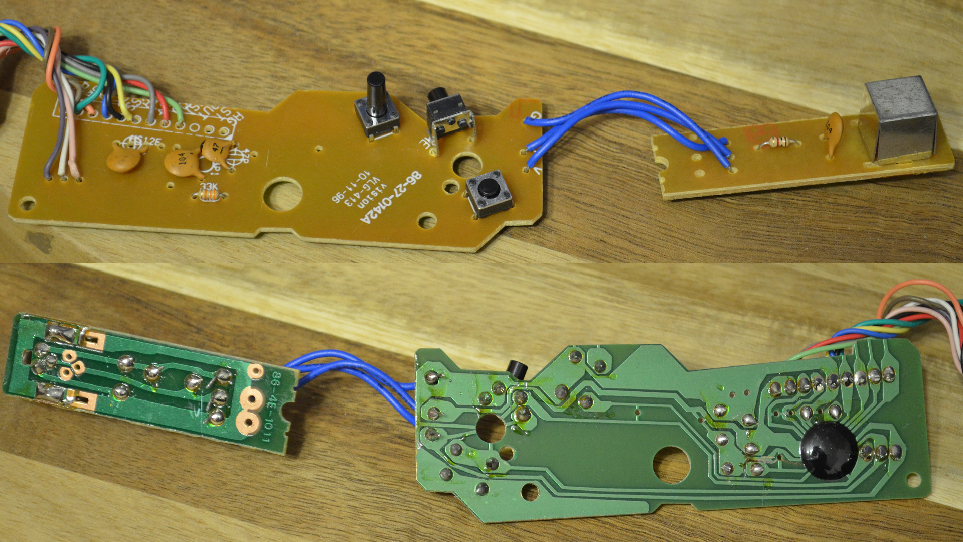

Shawn Posted April 6, 2020 Author Share Posted April 6, 2020 Oh and I finally saw the Saturn\PS1 Pursuer PCB's and it has an epoxy blobbed chip in it so it's not super friendly for conversion or modification. While it would still be possible, it's not very probable for ease of use outside of maybe a quick job turning it into a player 2 justifier. Quote Link to comment Share on other sites More sharing options...

Shawn Posted May 13, 2020 Author Share Posted May 13, 2020 Before starting another thread, I'll ask in here. Anyone know a good replacement phototransistor for use in these Justifier Guns? There is no markings on the part inside any of them. Quote Link to comment Share on other sites More sharing options...
Shawn Posted May 25, 2020 Author Share Posted May 25, 2020 If anyone has one of these sensors from a broken gun I'd love to buy one (or a few). Quote Link to comment Share on other sites More sharing options...
Shawn Posted July 18, 2020 Author Share Posted July 18, 2020 While not the exact solution I was looking for, I am happy to share that you can easily convert an SMS Phaser into a Player 2 Justifier by following the exact same schematic used for converting the player 2 blue gun. You just add a momentary switch as your start button cause the SMS only has a trigger. EDIT: A numbered visual diagram for those who might be interested in trying this themselves: Quote Link to comment Share on other sites More sharing options...
Shawn Posted August 25, 2020 Author Share Posted August 25, 2020 Good news! A drop in replacement for the Justifier light sensor is the SHARP IS485E Enjoy Reviving your dead guns and making new ones everyone! Mystery solved and case closed I've also attached a PDF data sheet for it. I was so happy to finally have this solved after months of leg work trying to hunt down a solution to this. Props to any and all who helped me out along the way. Extra special thanks to Viletim from Shumps. is485,486_e.pdf Quote Link to comment Share on other sites More sharing options...
