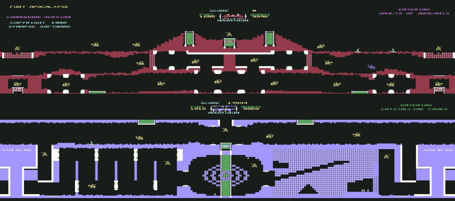

I would like to add the original helicopter sound effect of the C64 version:
and maybe modify some of the other sound effects. I am trying for some days now, but unfortunately I am completely unmusical and can not cope with tools like (https://alienbill.com/2600/atari-sound-forger/).
Any help is appreciated here
  • Like 1
Link to comment
Share on other sites
SID2TIA is here:
https://atariage.com/forums/index.php?showtopic=122972&st=0&p=1486188&&do=findComment&comment=1486188
but I can not find the SID files for the C64 version.
ASM for POKEY sound is here:
https://github.com/heyigor/FortApocalypse/blob/master/fort5.s#L793
but the Atari 8bit version sounds very different.
Link to comment
