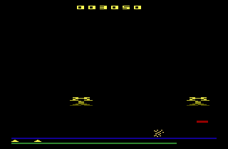

+Nathan Strum Posted November 12, 2006 Share Posted November 12, 2006 I got hit once in the boss wave, and the player froze: The sprite was stuck mid-explosion, and wouldn't move or shoot, although I could still activate the shields. The boss continued to move and fire. I saved a state for it in Stella (which I can reload), but I can't figure out where Stella put the state file, so I can't upload it here. It's not in the State folder. Quote Link to comment Share on other sites More sharing options...
Dave Neuman Posted November 12, 2006 Author Share Posted November 12, 2006 I got hit once in the boss wave, and the player froze: The sprite was stuck mid-explosion, and wouldn't move or shoot, although I could still activate the shields. The boss continued to move and fire. I saved a state for it in Stella (which I can reload), but I can't figure out where Stella put the state file, so I can't upload it here. It's not in the State folder. This bug would occur if you're base was hit after you had hit the Boss four times. I add some code to eliminate this and rechecked Base hits after Boss Hits 1 to 7. Thanks for finding this ... it was a nasty one. Thanks Dave SpaceBattle.bin Quote Link to comment Share on other sites More sharing options...

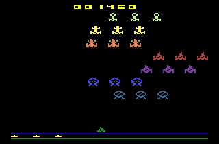

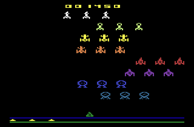

+Nathan Strum Posted November 13, 2006 Share Posted November 13, 2006 (edited) Okay, I've been playing Space Battle quite a lot today. And since you've been asking for feedback... here goes. It seems to announce the levels at different times. Level 01 shows up between the first round with the armada and the first boss. Level 02 shows up right after the first boss. Level 03 shows up right before the third boss. It's confusing as to where the levels start. I'd suggest that the beginning of the game should say Level 01, and after each boss is when the next level begins. Some upward momentum when thrusting during the landing phase would be nice (like flapping in "Joust", or thrusting in "Gravitar"). Also, some penalty (losing energy more rapidly) when missing the platform would be good. From a graphics standpoint - having the ships continually morph from one into another is a little confusing. Also, the color scheme seems a bit disjointed, too. Currently, you have eight ship designs, which morph by swapping sprites in pairs (top two rows, next two rows, etc.) But design-wise, they seem to fit together in different pairs (most notably the top four rows): My suggestion is to assign them colors based on the color spectrum: Then order them, top to bottom, according to those colors and designs: The reason I placed the ones at the top that I did, is that they're narrower, and therefore harder to hit. (And should be worth the most points.) With this layout, there now appears to be an intentional hierarchy among the ships. If you still want them to morph, I'd suggest moving them all in a uniform manner, so that as they morph, the entire group is moving together. So the top group moves down a row (in color and style) and every row shifts down accordingly, with the bottom row reappearing at the top. So the whole group would be cycling around the screen as if on a conveyor belt. However, I don't think that's really necessary. There's enough visually going on already with them being animated (by flip-flopping the sprites left-to-right), dropping bombs, dropping fuel, and turning their shields on and off. A couple of bugs: If I score more than 10,000 points, it starts my next game out with 10,000 points. It doesn't seem to reset that digit. Also, there are numerous times when my shots will pass right through an enemy ship without hitting it. It's as if a group has raised it's shields without the sprite changing to indicate that, or the shields staying raised after the sprite has changed back to normal. Sometimes I can't hit anything on the screen, and I'll just sit there wasting fuel while my shots pass harmlessly through everything. Overall, I think the game is coming along really nicely. The ideas of having to catch fuel, giving the enemies shields, the bosses, and the landing sequence are all really nice touches that distance it from other "death-from-above" games. It just needs a little bit of polishing. Edited November 13, 2006 by Nathan Strum Quote Link to comment Share on other sites More sharing options...
+SpiceWare Posted November 13, 2006 Share Posted November 13, 2006 1) Linux: $HOME/.stella/state 2) OSX: same as Linux That explains it. In OSX, any folder that starts with . is invisible to the GUI (they're reserved for system use). I can only see it using terminal. It's contents won't even show up using any of the GUI's search features. Can this be changed to be user-selectable for OSX? Or to automatically use a state folder within the Stella application folder? (This is how it seemed to work prior to Stella 2.0.) You can make the Finder show a hidden folder by going directly to it: activate Finder(so it says FINDER in the menu bar) select GO menu select GO TO FOLDER option type ~/.stella hit GO button Quote Link to comment Share on other sites More sharing options...

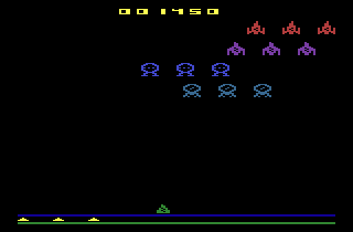

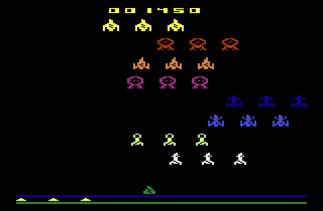

+Nathan Strum Posted November 13, 2006 Share Posted November 13, 2006 Another idea... How about starting out the earlier levels with fewer enemies? So the wave progression would be something like this: Level 1: Level 2: Level 3: Level 4: Level 5: The idea behind all of this is to give the player something to look forward to, and work towards, rather than giving it all away up front. It also gives beginners a couple of levels to get used to the game before having enemies directly over their heads. The difficulty would have to be balanced out so that the early levels weren't too easy though . One way to do this is that the player would start out with less fuel on Level 1, and would get more at the start of each subsequent wave up until Level 5, where it would be maxed out (and then would start being used up faster). Also, in keeping with this, would be to start out with just the smallest Destroyer (boss) at the end of the first level, then each level you'd get a successively larger one that took more hits to destroy (and became faster, fired more often, etc.) Reading the story of the game in the first post, this ties in with the idea of coming up from behind a convoy. You'd catch up to the slower stragglers first, and gradually work your way up to the main body of the convoy. Then the Destroyers would come in to protect the ships as you fought your way through to the next convoy, the bigger, more powerful Destroyers protecting the larger convoys. Quote Link to comment Share on other sites More sharing options...
+Nathan Strum Posted November 13, 2006 Share Posted November 13, 2006 One last note for the evening... In this earlier version of Space Battle, I really liked the way the enemies appear at the beginning of the level (where they "slide out" from the darkness). It's a nice effect. Quote Link to comment Share on other sites More sharing options...
Dave Neuman Posted November 14, 2006 Author Share Posted November 14, 2006 Okay, I've been playing Space Battle quite a lot today. And since you've been asking for feedback... here goes. It seems to announce the levels at different times. Level 01 shows up between the first round with the armada and the first boss. Level 02 shows up right after the first boss. Level 03 shows up right before the third boss. It's confusing as to where the levels start. I'd suggest that the beginning of the game should say Level 01, and after each boss is when the next level begins. Initially, the landing screen was just at the beginning of the game, so it was not actually a level. It's fully integrated now so it should behave as you outlined. I'll fix it! Some upward momentum when thrusting during the landing phase would be nice (like flapping in "Joust", or thrusting in "Gravitar"). Also, some penalty (losing energy more rapidly) when missing the platform would be good. I will add in momentum if I can find the space...it would look much better. I like the penalty for missing the platform ... I'll add that! From a graphics standpoint - having the ships continually morph from one into another is a little confusing. Also, the color scheme seems a bit disjointed, too. Currently, you have eight ship designs, which morph by swapping sprites in pairs (top two rows, next two rows, etc.) But design-wise, they seem to fit together in different pairs (most notably the top four rows): My suggestion is to assign them colors based on the color spectrum: Then order them, top to bottom, according to those colors and designs: The reason I placed the ones at the top that I did, is that they're narrower, and therefore harder to hit. (And should be worth the most points.) With this layout, there now appears to be an intentional hierarchy among the ships. If you still want them to morph, I'd suggest moving them all in a uniform manner, so that as they morph, the entire group is moving together. So the top group moves down a row (in color and style) and every row shifts down accordingly, with the bottom row reappearing at the top. So the whole group would be cycling around the screen as if on a conveyor belt. However, I don't think that's really necessary. There's enough visually going on already with them being animated (by flip-flopping the sprites left-to-right), dropping bombs, dropping fuel, and turning their shields on and off. You have a good eye for detail and color ... I already changed it ... looks much better! A couple of bugs: If I score more than 10,000 points, it starts my next game out with 10,000 points. It doesn't seem to reset that digit. Also, there are numerous times when my shots will pass right through an enemy ship without hitting it. It's as if a group has raised it's shields without the sprite changing to indicate that, or the shields staying raised after the sprite has changed back to normal. Sometimes I can't hit anything on the screen, and I'll just sit there wasting fuel while my shots pass harmlessly through everything. Overall, I think the game is coming along really nicely. The ideas of having to catch fuel, giving the enemies shields, the bosses, and the landing sequence are all really nice touches that distance it from other "death-from-above" games. It just needs a little bit of polishing. I'll check out those bugs and fix them. Thanks for spending so much time playing it! Great Feedback! I will post a new version as soon as I can... This is fun stuff. Thanks, Dave Quote Link to comment Share on other sites More sharing options...

Albert Posted November 21, 2006 Share Posted November 21, 2006 Another update with most of Nathan's suggestions implemented: Great update, thanks! Just spent some time playing and have the following suggestions: - After shooting the last alien on the first wave, I died.. Then before the next wave appeared, I saw "GAME OVER" at the top of the screen, even though I had two lives remaining. - On the wave with the two larger ships, if you die during that wave, is it supposed to reset those aliens to their original (large) size? - On the landing screen, is it possible to make the "thrust" two pixels wide so it is properly centered below the ship? Right now it's off a bit to the right. - On the screen with the many rows of invader, I still see the scanline count jump sometimes (this is when using Stella to emulate the game--need to try it on a real system). Happens fairly frequently so should be easy for you to reproduce. - For the "Level 01" display, I think a "Level" should comprise of a set of the three different waves. For instance, when you start the game, you'd immediately see "Level 01", then the landing screen, then the main wave of invaders, then the boss screen, and then after that, "Level 02" before you start the next landing sequence. - Enemies do not always "fade out" when you shoot them. Many times they simply disappear immediately. Is this intentional? - When you die, you can still press "Up" and hear the shield sound. - When you land on the pad, it would be nice to hear some kind of "confirmation" sound - When shooting an alien that has shields on, would it be possible to have your bullet stop (and maybe make some sort of unique "you hit a shield" sound) instead fo passing right through the enemy? Keep up the great work! ..Al Quote Link to comment Share on other sites More sharing options...
+Nathan Strum Posted November 21, 2006 Share Posted November 21, 2006 (edited) - For the "Level 01" display, I think a "Level" should comprise of a set of the three different waves. For instance, when you start the game, you'd immediately see "Level 01", then the landing screen, then the main wave of invaders, then the boss screen, and then after that, "Level 02" before you start the next landing sequence. I was going to suggest that as well. A few other suggestions: That you only get an extra ship after defeating a boss. Right now, it's too easy to build up extra ships. Maybe even make it so that you only get an extra life if you defeat the boss without dying. Whatever fuel you end up with after landing, is what you start out with in the main invader level. That gives more incentive to land quickly, but accurately, and also to catch fuel right away from the invaders. If you die on the landing screen, it'd be nice to restart a little higher off the ground, so you didn't immediately hit the ground after coming back. It'd be nice if an earlier fuel warning alarm went off when you were getting down to the yellow zone, rather than only having one in the red zone. How about a laser power-up (that shoots a beam straight up instantly)? Every once in awhile (like a reward for hitting x number of enemy ships without missing) they drop a laser cannon (orange maybe?) that if you catch, you can use for a few seconds to zap invaders. Either a laser, or faster missile. (The laser idea came about because of the vertical line bug, mentioned below.) Color suggestions - instead of pink (looks like 5/2-3 on the TIA chart) for the third ship from the bottom, I think purple (6/2-3) would look better. For the bottom row, instead of dark blue, I'd suggest a blue-green color, like A/2-3. (These are close to what I'd put in the mockup screenshots). Some bugs: The first level of invaders doesn't always start with just one in the top row. Sometimes it's two or three. The 4 in the level number and score looks like a 7. The middle line in the 4 should be moved down a pixel. After you shoot the boss, you still hear the sounds of the boss firing at you while he's blowing up. As soon as he's hit for the last time, that should probably stop. Also, after dying on the landing screen, I hit reset then select, and got a vertical line running down the screen: If you start a game in option 4, play for awhile, then hit reset to get back the title screen, change to option 2 and hit fire to play a new game, several things happen: You start at the level number you ended at in option 4 You start with the score you had before You start with the same fuel amount Collision detection starts having severe problems where shots pass right through the enemies (especially with the yellow ships) Edit: Actually, this seems to happen whenever you switch from one game option to another. Collision detection seems pretty spotty on game option 2 in general. Edited November 22, 2006 by Nathan Strum Quote Link to comment Share on other sites More sharing options...
+Nathan Strum Posted November 22, 2006 Share Posted November 22, 2006 (edited) More notes: If you die after shooting the last alien on the invader screen, you won't finish blowing up until after the boss screen has started. There should be a check in place that it won't change screens until after you've blown up completely, or there's no more chance of you getting hit. On the landing screen, sometimes (although rarely) you'll appear right on top of the alien guarding the landing platform, and instantly die. It should put the platform at least a minimum distance from where you appear. Also, the enemies can drop fuel at the edges of the screen, beyond your reach. They probably shouldn't drop anything beyond the limits of where your ship can travel. More suggestions: I'd suggest increasing the point value on a per row (or every other row) basis, rather than just having the top two rows be worth more. Maybe: 100 90 80 70 60 50 40 30 Additionally, I'd suggest starting out with the lower point value ships, rather than the high point value ones, in the early levels (but place them higher on the screen). Then, as the levels progress, everything drops down a row, and you're rewarded with higher point values in the new top row. (See post #41 for screenshots.) Edited November 22, 2006 by Nathan Strum Quote Link to comment Share on other sites More sharing options...
