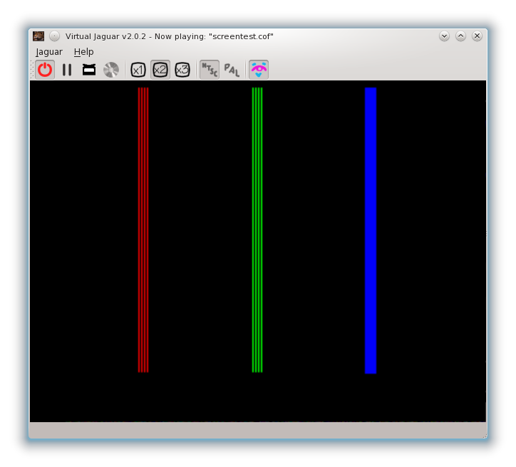

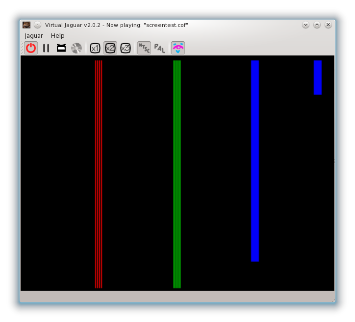

Hyper_Eye Posted January 31, 2012 Share Posted January 31, 2012 Alright, I have another experiment I would like to post about. Seb, let me know if this thread is not the right place for this. So, I have been playing around with sprites and I have not had any issues there so far. Tonight I wanted to check out the screen methods and throw some pixels around. I made a test program with the intention of drawing some lines with the different methods available: put_pixel(), put_pixels(), and vline(). Setting up and working with a screen is pretty easy. I ran into two issues though. I will share my code and then screenshots that show what I am seeing. These results are the same in the emulator and on the Jaguar. Here is the code: #include <interrupt.h> #include <display.h> #include <sprite.h> #include <screen.h> #define RED 0xf800 #define BLUE 0x07c0 #define GREEN 0x003f #define SCREEN_WIDTH 320 #define SCREEN_HEIGHT 240 #define LINE_WIDTH 8 #define LINE_LENGTH 200 #define LINE_PIXELS (LINE_WIDTH * LINE_LENGTH) int main(int argc, char* argv[]) { int i, j; // Initialize TOMREGS->vmode = RGB16|CSYNC|BGEN|PWIDTH4|VIDEN; init_interrupts(); init_display_driver(); // Setup a display display* d = new_display(0); d->x = 16; d->y = 8; // A screen to play with screen* scr = new_screen(); alloc_simple_screen(DEPTH16, SCREEN_WIDTH, SCREEN_HEIGHT, scr); clear_screen(scr); // Attach the screen to the display as a sprite sprite* scr_sprite = sprite_of_screen(0, 0, scr); attach_sprite_to_display_at_layer(scr_sprite, d, 0); // Draw the red vertical lines one pixel at a time for(i = 0; i < LINE_WIDTH; i++) { for(j = 0; j < LINE_LENGTH; j++) { put_pixel(scr, SCREEN_WIDTH * 0.25 + i, j, RED); } } // Draw the green vertical lines at once with a pixel array pixel pl[LINE_PIXELS]; for(i = 0; i < LINE_WIDTH; i++) { for(j = 0; j < LINE_LENGTH; j++) { int ndx = (i * LINE_LENGTH) + j; pl[ndx].x = SCREEN_WIDTH * 0.5 + i; pl[ndx].y = j; } } put_pixels(scr, GREEN, LINE_PIXELS, pl); // Draw the blue vertical lines one line at a time with the builtin // vline() method. for(i = 0; i < LINE_WIDTH; i++) { vline(scr, SCREEN_WIDTH * 0.75 + i, 0, LINE_LENGTH, BLUE); } // Show the display show_display(d); for(; { vsync(); } return 0; } This is the result when I run that code: As you can see the only method that works correctly is the vline() method. When I try to set the pixels myself only the odd numbered lines on the x coords show up. The even numbered lines remain black. The second issue occurs if I change LINE_LENGTH to equal SCREEN_HEIGHT (240). Then vline() exhibits a different issue which looks like this: So here vline() is not drawing to the bottom of the screen but moves to the right after a certain number of y pixels. I suspect this is not the intended behavior. Thanks for your interest and assistance! Quote Link to comment Share on other sites More sharing options...
SebRmv Posted January 31, 2012 Author Share Posted January 31, 2012 Alright, I have another experiment I would like to post about. Seb, let me know if this thread is not the right place for this. So, I have been playing around with sprites and I have not had any issues there so far. Tonight I wanted to check out the screen methods and throw some pixels around. I made a test program with the intention of drawing some lines with the different methods available: put_pixel(), put_pixels(), and vline(). Setting up and working with a screen is pretty easy. I ran into two issues though. I will share my code and then screenshots that show what I am seeing. These results are the same in the emulator and on the Jaguar. Hi, I'll have a look at it, as soon as I get some time and a Jaguar near myself. To be honest, these functions are not intended to be really used , but thank you for spotting a bug if any. Cheers Quote Link to comment Share on other sites More sharing options...
SebRmv Posted January 31, 2012 Author Share Posted January 31, 2012 (edited) So, sorry, I don't need a Jaguar finally I just had a look at some of my example codes and just realized that I have badly documented these functions. Indeed, the color parameter has to be on 32 bits: the high half and the low half are both used to set the color. In your case, simply change your code to: put_pixel(scr, SCREEN_WIDTH * 0.25 + i, j, RED<<16 | RED); vline(scr, SCREEN_WIDTH * 0.75 + i, 0, LINE_LENGTH, BLUE<<16 | BLUE); put_pixels(scr, GREEN<<16 | GREEN, LINE_PIXELS, pl); Regarding the problem with vline, I need to think a bit about it. Cheers Edited January 31, 2012 by SebRmv 1 Quote Link to comment Share on other sites More sharing options...
SebRmv Posted January 31, 2012 Author Share Posted January 31, 2012 Hi again, for the problem with vline, I think the higher value you can give is SCREEN_HEIGHT-1, because the parameter is not the height, but the Y-coordinate of the last point (which should be >= Y-coordinate of the first point). But, I still don't understand why something is put to the right. The intended behaviour is that the Y-coordinate is clipped. Quote Link to comment Share on other sites More sharing options...
Hyper_Eye Posted January 31, 2012 Share Posted January 31, 2012 To be honest, these functions are not intended to be really used , but thank you for spotting a bug if any. I am glad they are there and documented (I ran doxygen on the source because the online doc is outdated.) I would like to put these methods to use for a particular purpose and I was pretty happy when I found them. So, sorry, I don't need a Jaguar finally I just had a look at some of my example codes and just realized that I have badly documented these functions. Indeed, the color parameter has to be on 32 bits: the high half and the low half are both used to set the color. In your case, simply change your code to: put_pixel(scr, SCREEN_WIDTH * 0.25 + i, j, RED<<16 | RED); vline(scr, SCREEN_WIDTH * 0.75 + i, 0, LINE_LENGTH, BLUE<<16 | BLUE); put_pixels(scr, GREEN<<16 | GREEN, LINE_PIXELS, pl); This resolved the issue perfectly! Thanks! Hi again, for the problem with vline, I think the higher value you can give is SCREEN_HEIGHT-1, because the parameter is not the height, but the Y-coordinate of the last point (which should be >= Y-coordinate of the first point). But, I still don't understand why something is put to the right. The intended behaviour is that the Y-coordinate is clipped. I would expect clipping but not where the line is clipped and I didn't expect to see it on the right. I thought it would end where the other lines end. Thanks for looking at the issue and responding so quickly. As you can tell I meant it when I said I was having fun with your lib! Quote Link to comment Share on other sites More sharing options...
Hyper_Eye Posted January 31, 2012 Share Posted January 31, 2012 By the way, I realize you were implying that there could be a clipping issue due to me going one over the screen size. I know you were just pointing out possibilities without the convenience of being able to run the code at the moment. I want to clear it up a bit. It doesn't matter what ymax I specify. If it is beyond the last visible point in that screenshot it will begin coming down on the right. The length of the line coming out on the right is determined by how much ymax goes beyond that point. I think the highest value before this happens, in this example, is 200. As for the ymax used in the code I posted, the value used is indeed incorrect. The corrected code, accounting for 0, would be: vline(scr, SCREEN_WIDTH * 0.75 + i, 0, LINE_LENGTH-1, BLUE<<16 | BLUE); Thanks. Quote Link to comment Share on other sites More sharing options...
SebRmv Posted February 1, 2012 Author Share Posted February 1, 2012 By the way, I realize you were implying that there could be a clipping issue due to me going one over the screen size. I know you were just pointing out possibilities without the convenience of being able to run the code at the moment. I want to clear it up a bit. It doesn't matter what ymax I specify. If it is beyond the last visible point in that screenshot it will begin coming down on the right. The length of the line coming out on the right is determined by how much ymax goes beyond that point. I think the highest value before this happens, in this example, is 200. As for the ymax used in the code I posted, the value used is indeed incorrect. The corrected code, accounting for 0, would be: vline(scr, SCREEN_WIDTH * 0.75 + i, 0, LINE_LENGTH-1, BLUE<<16 | BLUE); Thanks. Clearly, there is a bug somewhere. I tried to understand what goes wrong yesterday evening, but haven't succeeded yet. Just one question: does the problem also happen when using VirtualJaguar? Quote Link to comment Share on other sites More sharing options...
