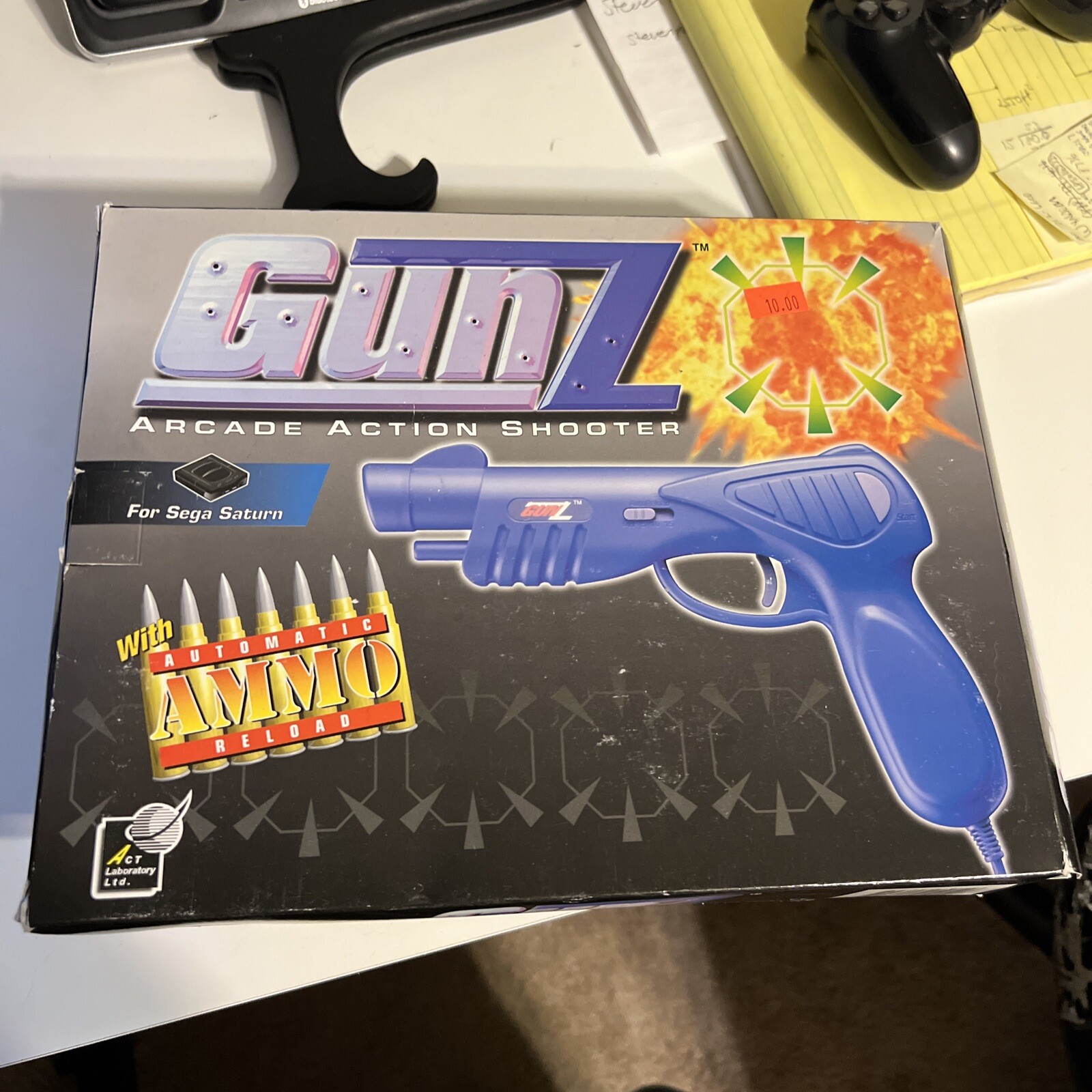

First Spear Posted February 7, 2023 Author Share Posted February 7, 2023 On 10/8/2016 at 9:18 AM, mr_me said: Maybe meant the timing issue. With an infrared system like a wiimote its not using the display at all. So display timing is not an issue. Like this? https://www.ebay.com/p/1500050408?iid=125342659168 How would that work from a hardware perspective? I can imagine requiring an ECS for additional controller ports but the gun has to talk "to" something. Or would a Sega Saturn wired light gun connect better? Quote Link to comment Share on other sites More sharing options...
First Spear Posted March 21, 2023 Author Share Posted March 21, 2023 Gentle mental bump. Best Electronics has Atari Light Guns for sale. They appear to be pin compatible with the ECS, I wonder if timing and power concerns could be addressed by requiring an ECS. Quote Link to comment Share on other sites More sharing options...
