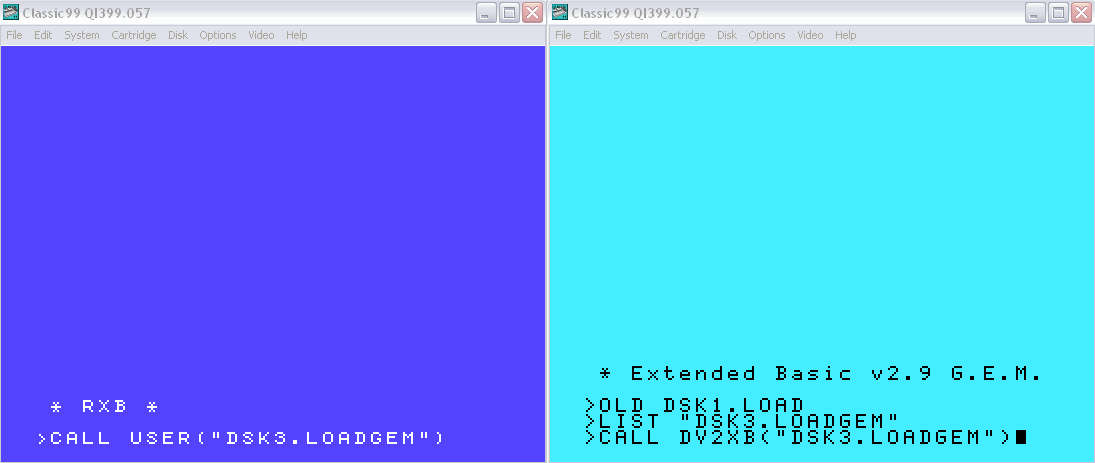

senior_falcon Posted June 2 Author Share Posted June 2 (edited) In a different thread, there was some speculation about the capabilities of CALL DV2XB in XB 2.9 G.E.M. vs. CALL USER in RXB. I think the following short videos should help clarify matters. I made a short batch file that does CALL INIT, then loads SteveB's multicolor routines, then runs his BISBEE demo program CALL INIT CALL LOAD("DSK3.MCOLOR.OBJ") RUN "DSK3.BISBEE" This was saved in two formats. MCBATCH.TXT is the file saved in windows format. MCBATCHDV is the file saved in DV80 format. This video compares the results loading MCBATCHDV, the DV80 format file. Both work as advertised. You can see that I take my time starting it in XB 2.9, but because of GEM's fast assembly loader, it starts much faster. The next video shows the results loading MCBATCH.TXT, the windows format file. You can see that RXB does not process the windows format batch file properly. To me, the real utility of these subprograms is the ability to save portions of an XB program, then merge it into another program. This is more versatile than saving in merge format because you can select which lines to save. The videos below show how this can be done. In these videos, I load an XB program, then save lines 215 to 225 in DV80 format using LIST. I then NEW, and use DV2XB or USER to enter those lines into XB. You will see that XB 2.9 G.E.M. is the only one that can handle this. You can force a save in windows format this way: LIST "DSKn.?W.FILE.TXT” The results are the same, so I will not post them. I think you can see that XB 2.9 G.E.M. has some powerful capabilities when it comes to batch processing. Perhaps the misunderstanding happened because I did not specifically mention batch processing in the manual. That omission has been corrected. When used in a batch file, NUM led to some erratic behavior. This, too, has been corrected in the newest version. Also, using LIST in a batch file will crash the computer. I am not certain why this is so, but can see no reason to spend time fixing something that has no practical use. The most recent version includes SteveB's multicolor routines and should be ready for release soon. (Edit) As far as I can see, RXB cannot use LIST to produce a file that is compatible with CALL USER. But files created with XB 2.9 G.E.M. are compatible. In the video below, I have loaded an XB program, then saved it to disk using LIST. I then use CALL USER and CALL DV2XB to load that program into XB. Both load the program properly, but there is a noticeable difference in performance. Edited June 2 by senior_falcon 5 2 Quote Link to comment Share on other sites More sharing options...

+RXB Posted June 19 Share Posted June 19 On 6/1/2023 at 7:39 PM, senior_falcon said: In a different thread, there was some speculation about the capabilities of CALL DV2XB in XB 2.9 G.E.M. vs. CALL USER in RXB. I think the following short videos should help clarify matters. I made a short batch file that does CALL INIT, then loads SteveB's multicolor routines, then runs his BISBEE demo program CALL INIT CALL LOAD("DSK3.MCOLOR.OBJ") RUN "DSK3.BISBEE" This was saved in two formats. MCBATCH.TXT is the file saved in windows format. MCBATCHDV is the file saved in DV80 format. This video compares the results loading MCBATCHDV, the DV80 format file. Both work as advertised. You can see that I take my time starting it in XB 2.9, but because of GEM's fast assembly loader, it starts much faster. The next video shows the results loading MCBATCH.TXT, the windows format file. You can see that RXB does not process the windows format batch file properly. To me, the real utility of these subprograms is the ability to save portions of an XB program, then merge it into another program. This is more versatile than saving in merge format because you can select which lines to save. The videos below show how this can be done. In these videos, I load an XB program, then save lines 215 to 225 in DV80 format using LIST. I then NEW, and use DV2XB or USER to enter those lines into XB. You will see that XB 2.9 G.E.M. is the only one that can handle this. You can force a save in windows format this way: LIST "DSKn.?W.FILE.TXT” The results are the same, so I will not post them. I think you can see that XB 2.9 G.E.M. has some powerful capabilities when it comes to batch processing. Perhaps the misunderstanding happened because I did not specifically mention batch processing in the manual. That omission has been corrected. When used in a batch file, NUM led to some erratic behavior. This, too, has been corrected in the newest version. Also, using LIST in a batch file will crash the computer. I am not certain why this is so, but can see no reason to spend time fixing something that has no practical use. The most recent version includes SteveB's multicolor routines and should be ready for release soon. (Edit) As far as I can see, RXB cannot use LIST to produce a file that is compatible with CALL USER. But files created with XB 2.9 G.E.M. are compatible. In the video below, I have loaded an XB program, then saved it to disk using LIST. I then use CALL USER and CALL DV2XB to load that program into XB. Both load the program properly, but there is a noticeable difference in performance. Loading a program is not the reason for CALL USER, that is just a secondary use. The main use is to load and run programs from a single file and do things like Renumber or Edit files and save them then run them from CALL USER. Or add lined to programs and save them in merge format or program format. Sorry but you are comparing only one thing and ignore the hundreds of other uses CALL USER can do. Can your version run multiple version of Assembly programs all from a single DV80 Text file? This is a video of CALL USER and there are 12 videos made from this single CALL USER file demo. Quote Link to comment Share on other sites More sharing options...
