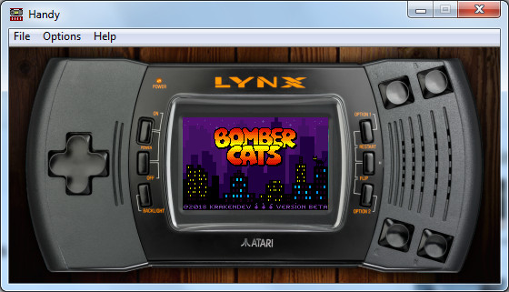

Rebouncing on Cyprian original post, should https://github.com/b...rc-0.95-patched be considered the latest/most up-to-date windows version?
From this thread it seems that is has more features (EEPROM support), more bug fixes and such. So apart from the sounds bug, it looks like the most advanced version, am I correct?
Edited by LordKraken
  • Like 1
Link to comment
Share on other sites
This is the version we decided to treat that way.
We did a pull request last week.
So far we have
  • updated the Windows shell to the 2019 version of the compiler
  • we have either fixed a bug or made a patch (depending on perspective) in Mikie.cpp to support 32BPP Android ARGB mode.
We're working on load/save state related issues this week.
There are at least 2 core bugs that we have logged (in our internal Jira) against it:
  • Gates of Zendocon "Laughing Spider" sound not playing
  • Ms. Pac-Man uneven speed issue (the game runs faster as you clear more dots - not present on Lynx II actual hardware)
